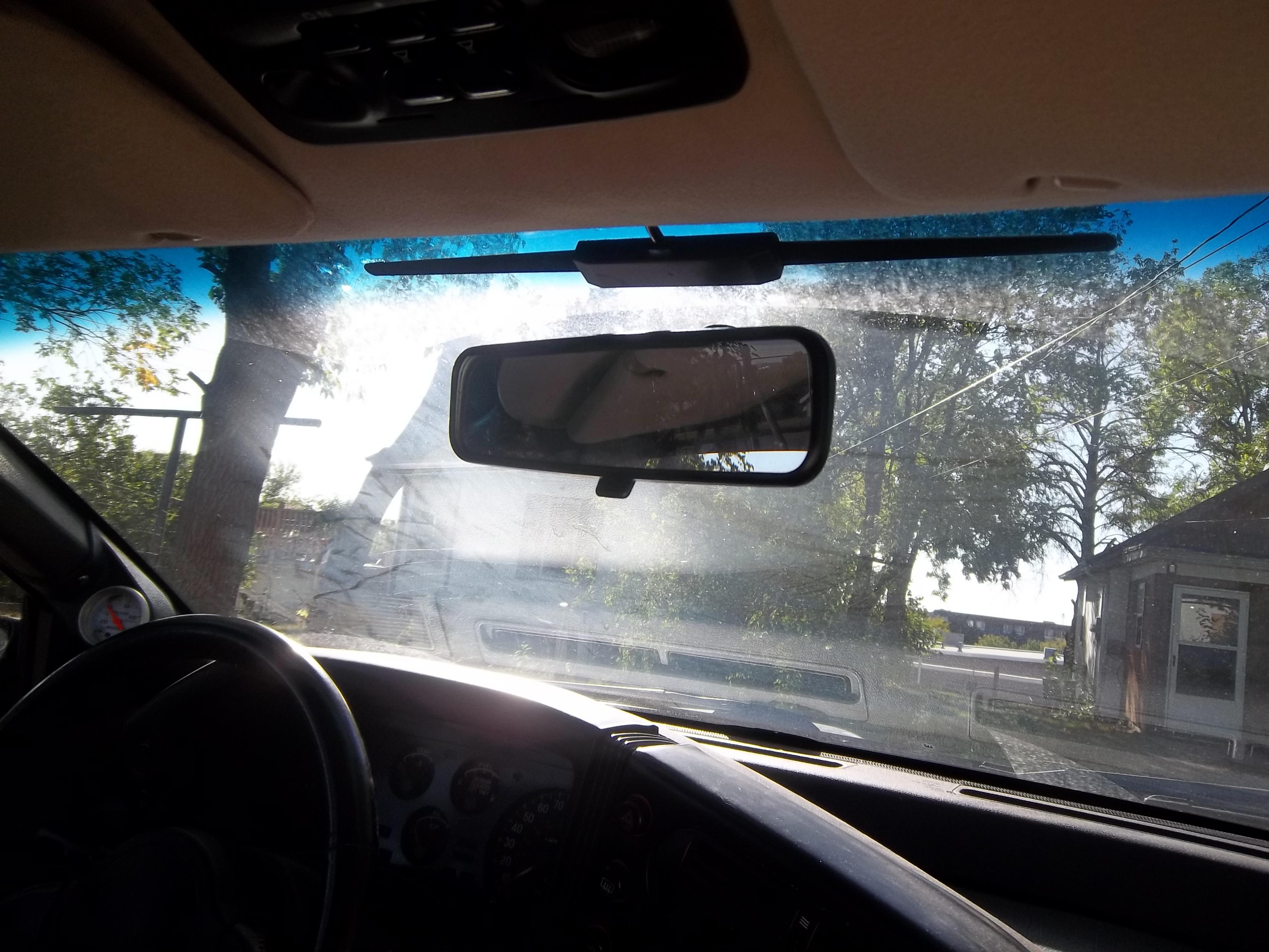

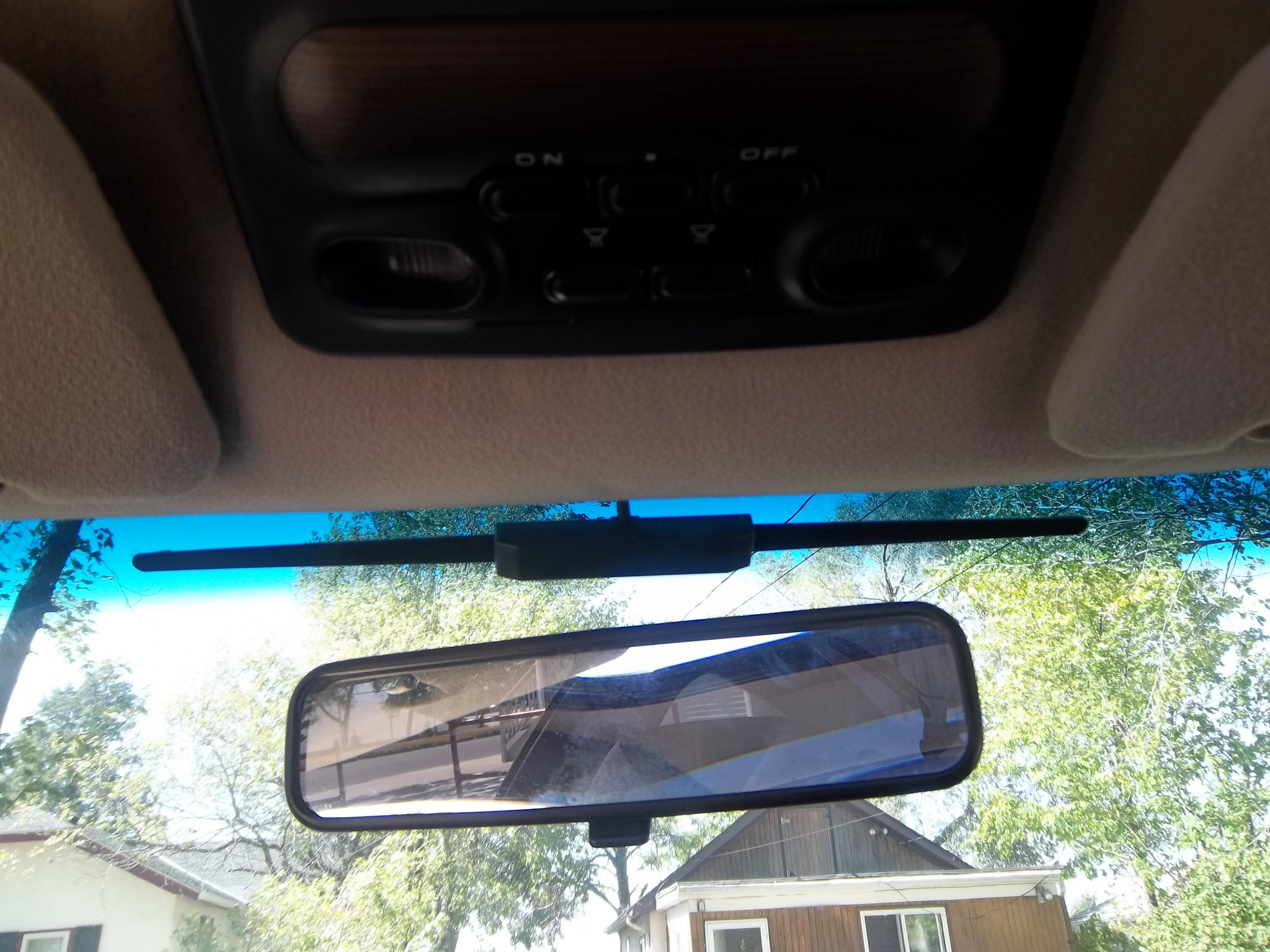

I installed a deck I had laying around, I also chopped the stock antenna off and installed this powered amplified antenna on the interior. I got it at Orielly's for $18. It looks way better without the long stock antenna, and works great too.

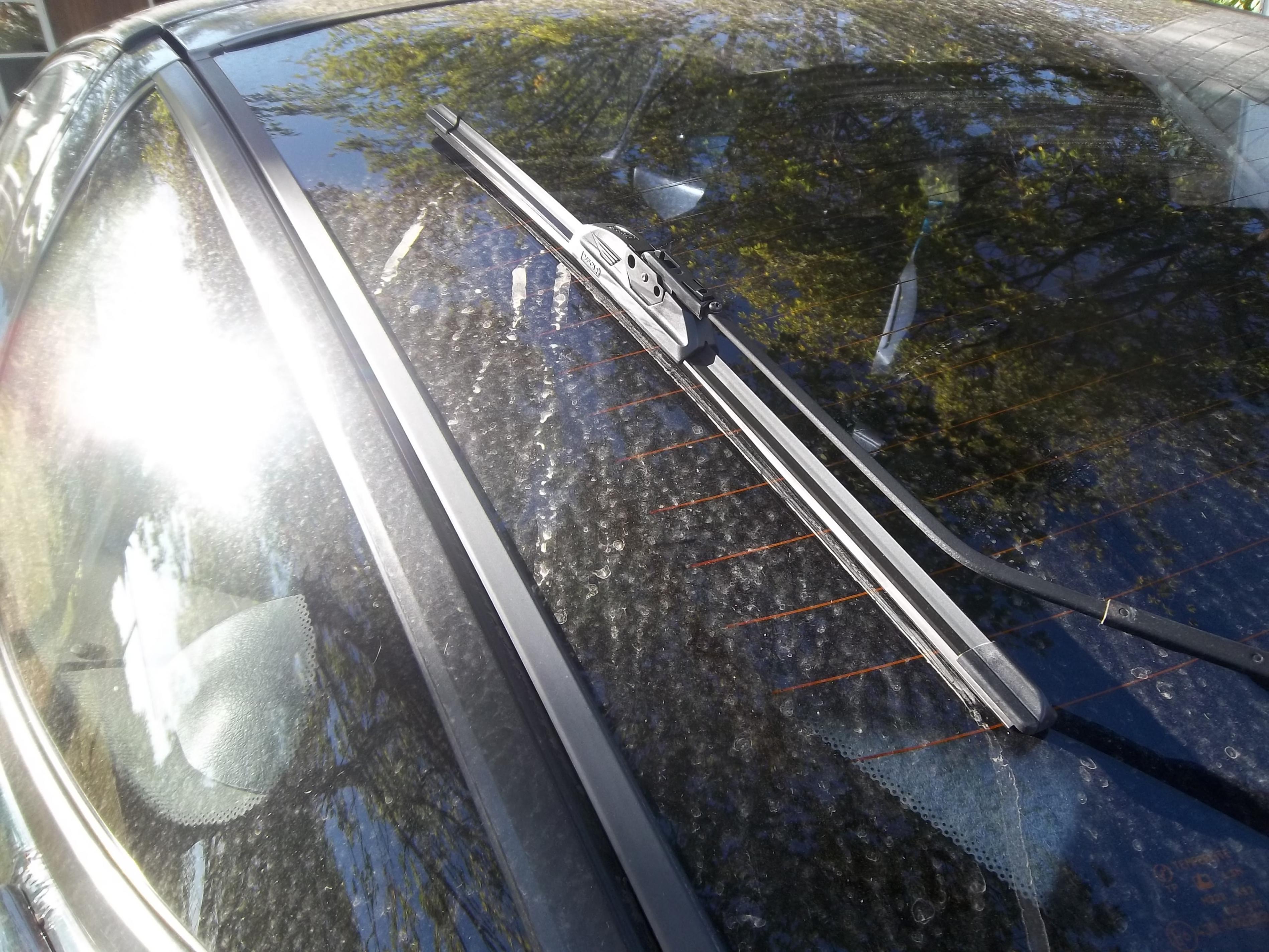

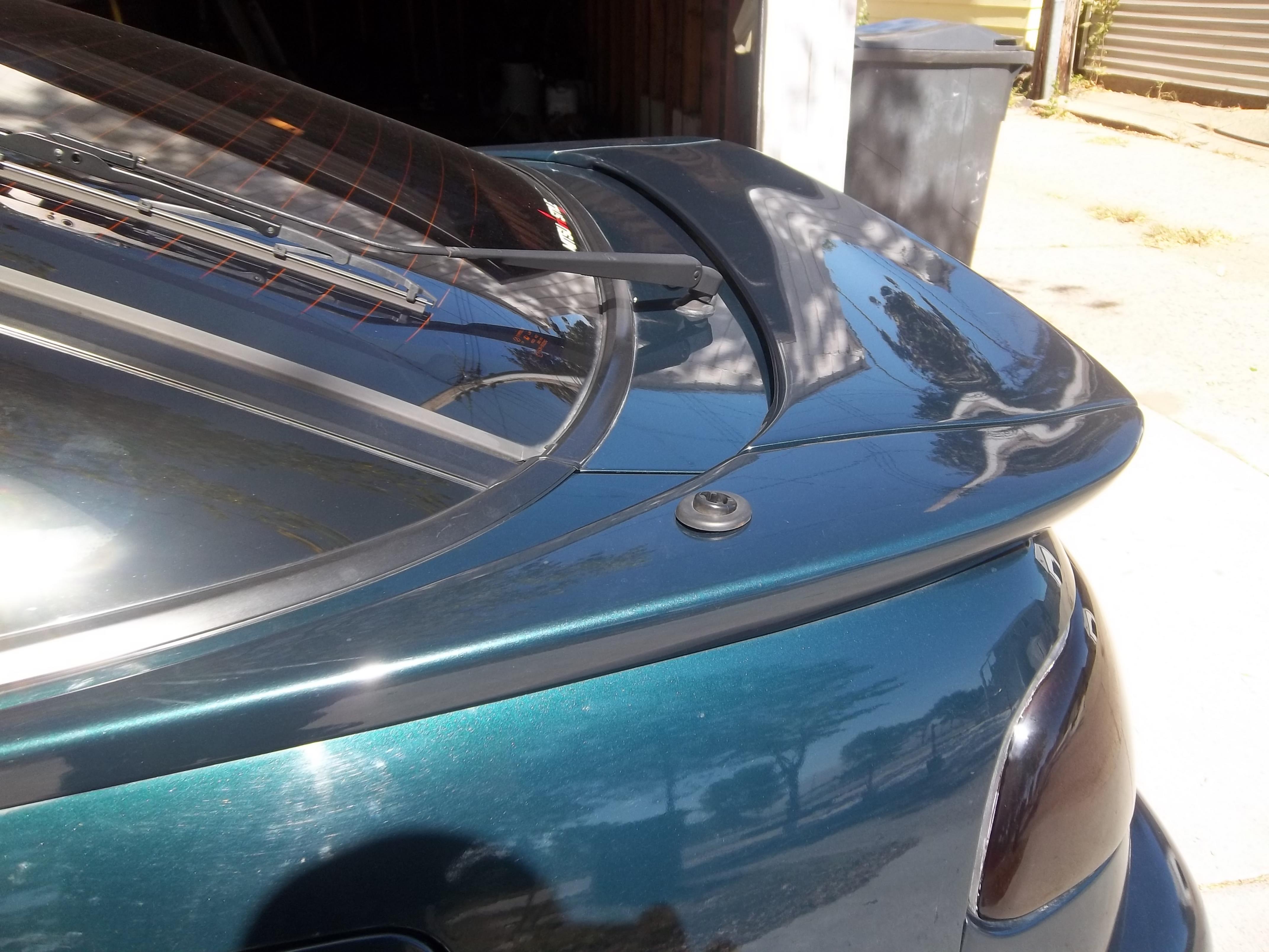

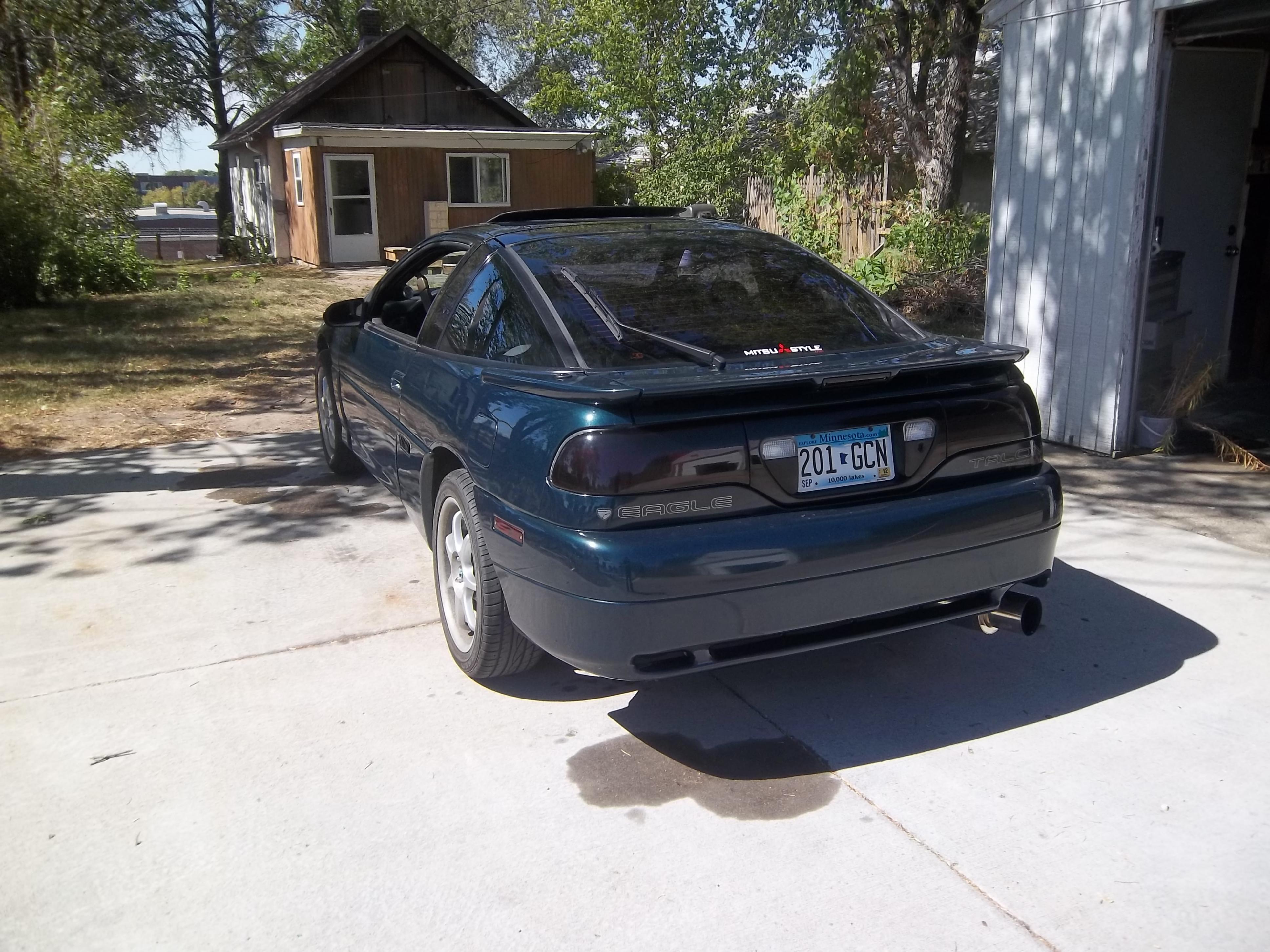

So today I hit the 1000 mile mark since initial assembly of the Talon, I changed the oil and installed new Bosch Evolution wiper blades. I even got a new one for the rear. Looks like I need a car wash again. I'm also throwing in another pic of the new antenna.

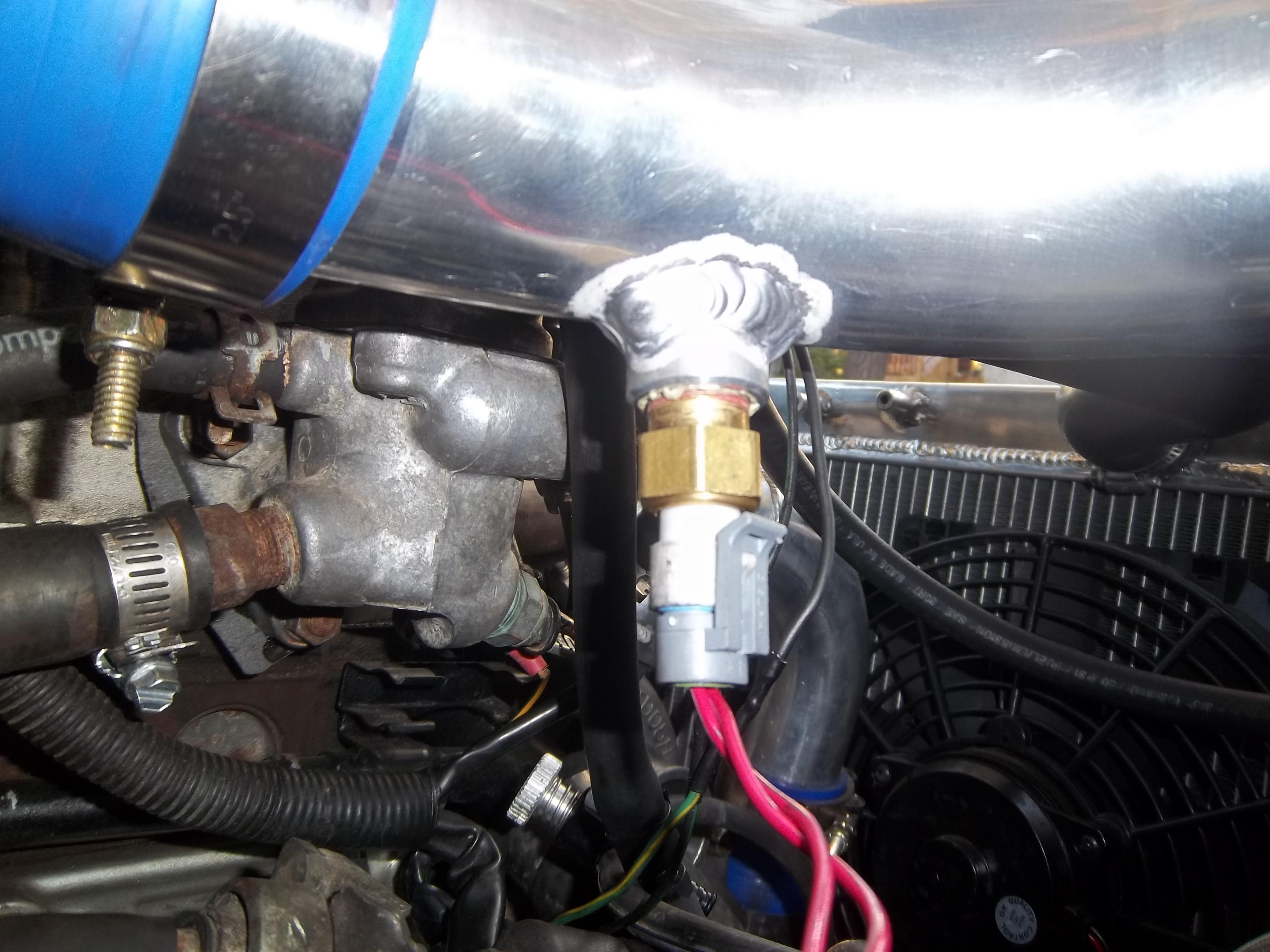

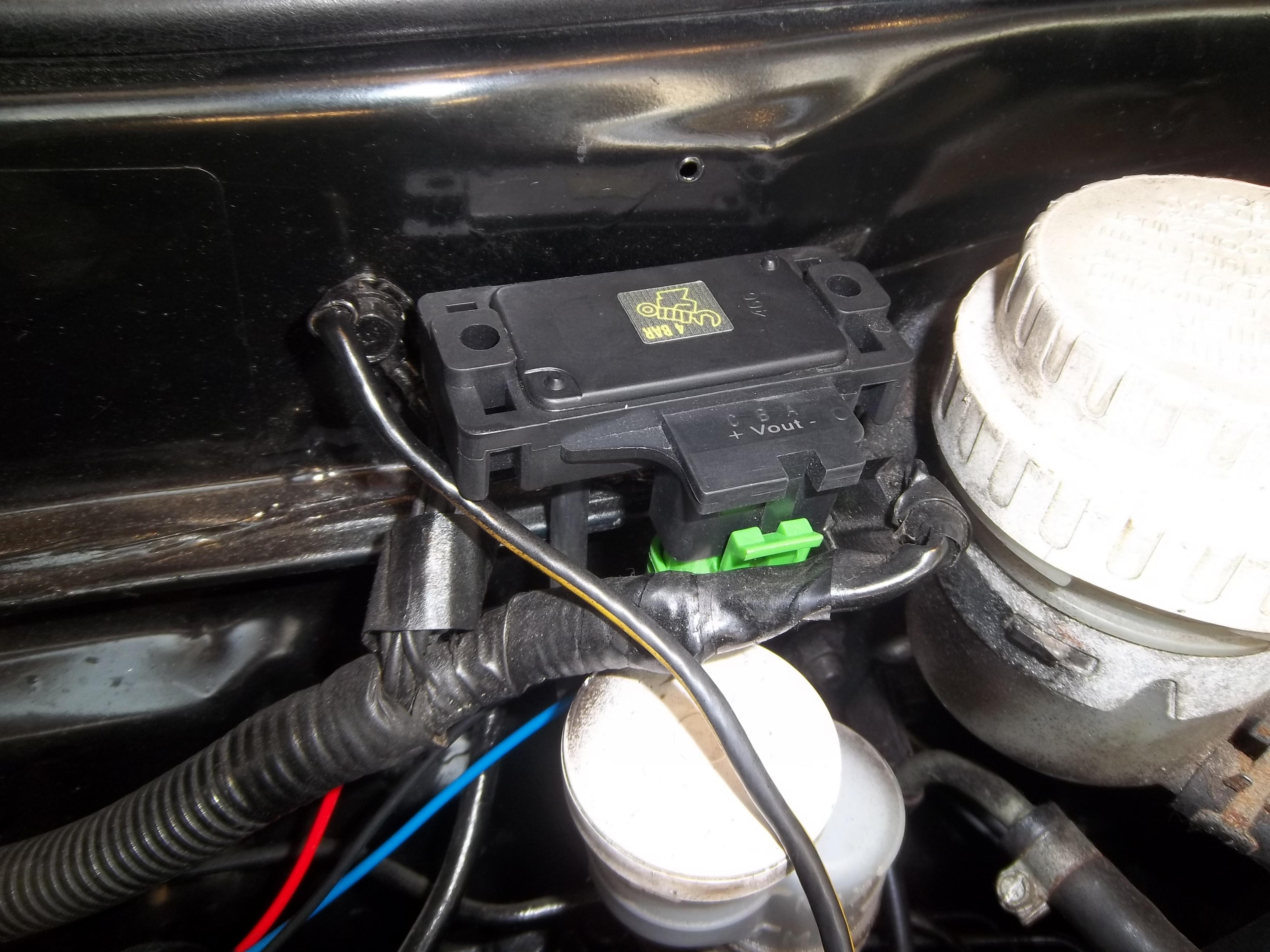

Installed the speed density setup, I still need to hide the wiring, and mount the MAP securely to the firewall. Pushit2.0 did a great job welding on the IAT bung for me. With SD the car runs better than it did with the 2g mas. Having another member do some street tuning for me next week.

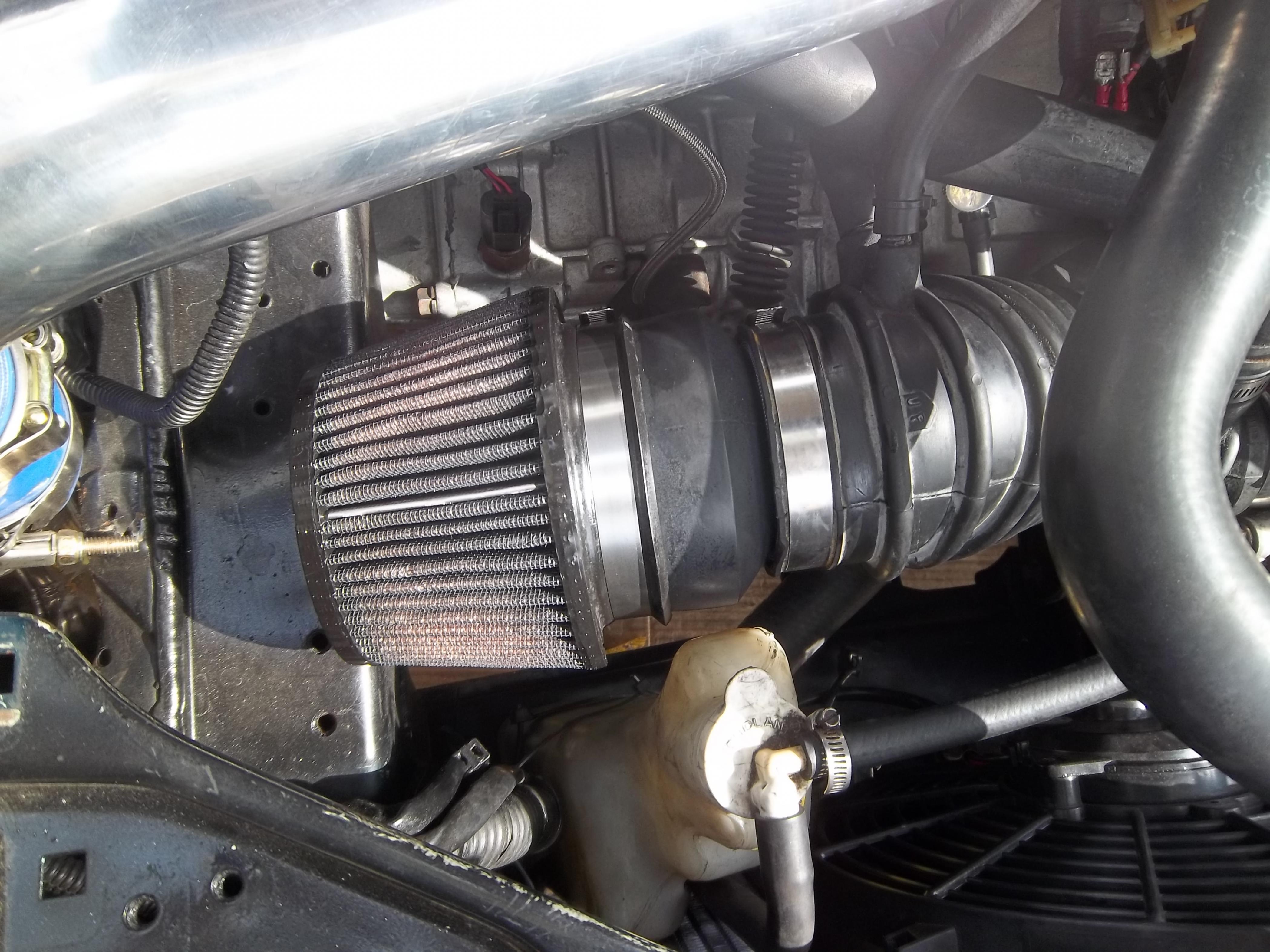

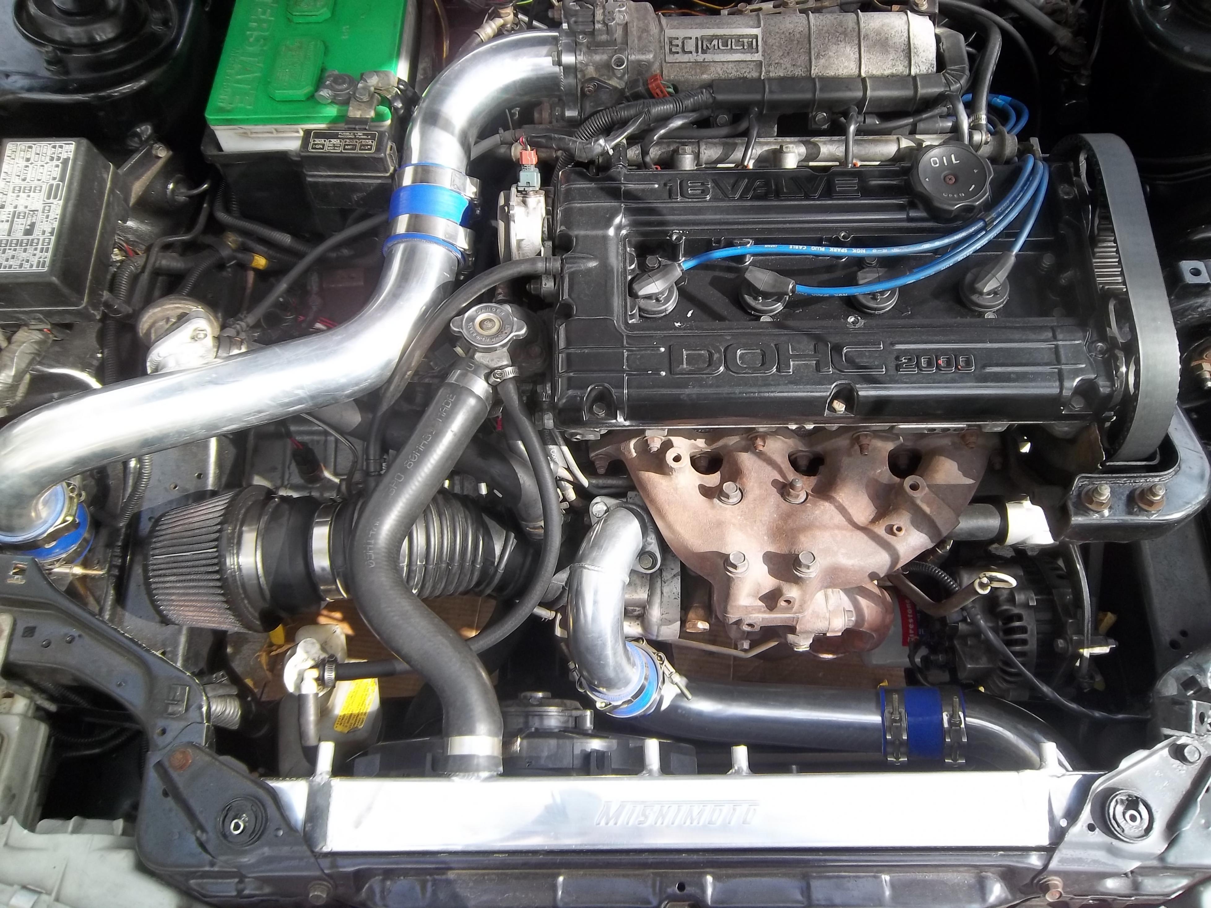

With the SD setup, I wanted to get rid of the 2g MAS without running filterless. This is what I came up with in a hurry, it will do until I find/make a nicer pre-turbo intake/filter. Looks kindy goofy with that filter idk. I also wanted to keep my BOV recirculated.

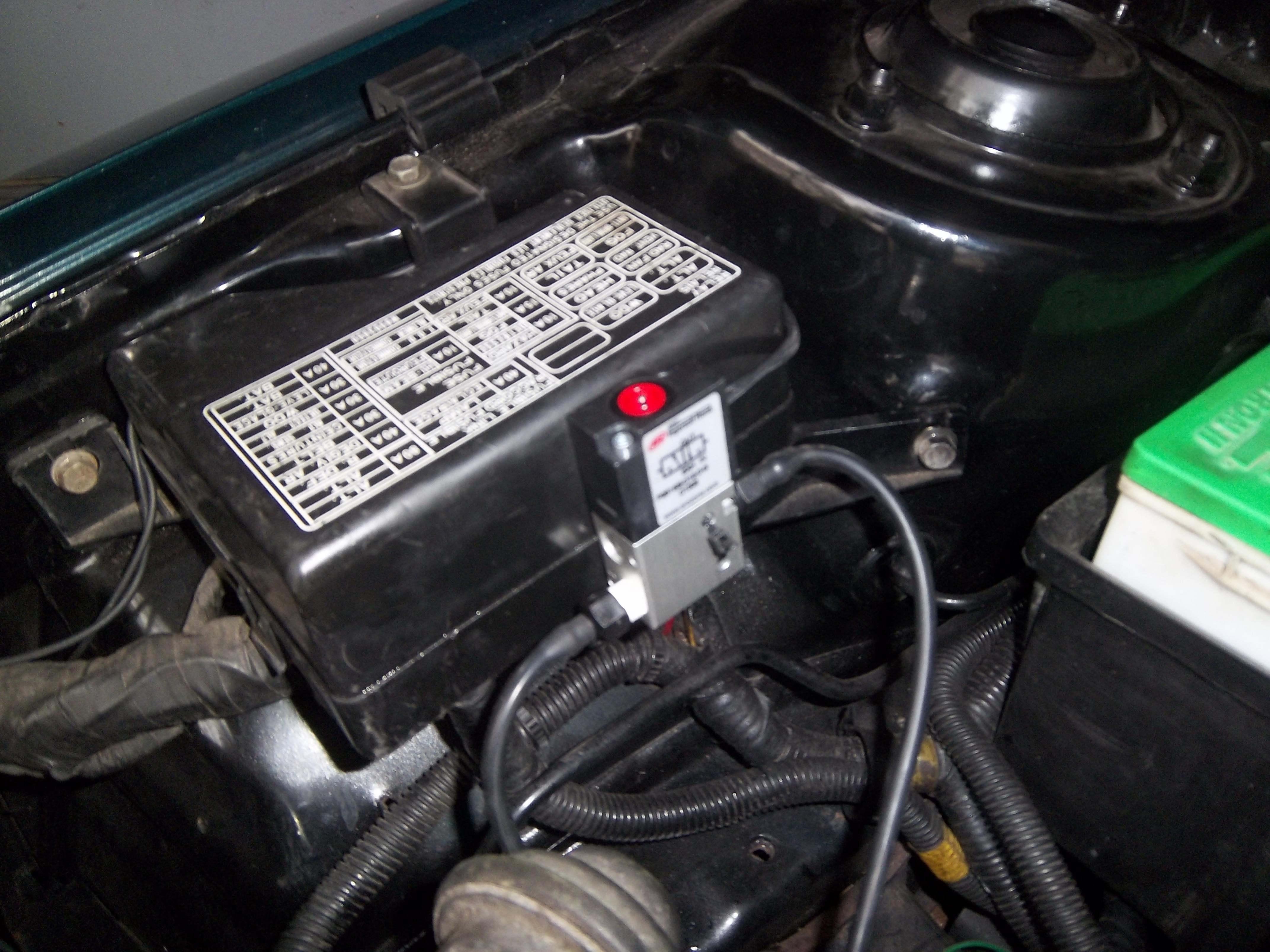

Today I installed a Ingersoll Rand boost solenoid from Ecmtuning. The boost control function on Ecmlink is badass! Im still tweaking the base duty cycles, once I get that dialed in well I can enable the error correction feature. Just gotta wait for traffic/rush hour to end so I can make some 3rd/4th gear pulls. Being able to fine tune boost levels throughout the RPM range and in different gears is awesome. And for $45, thats cheaper than any good name brand MBC!
