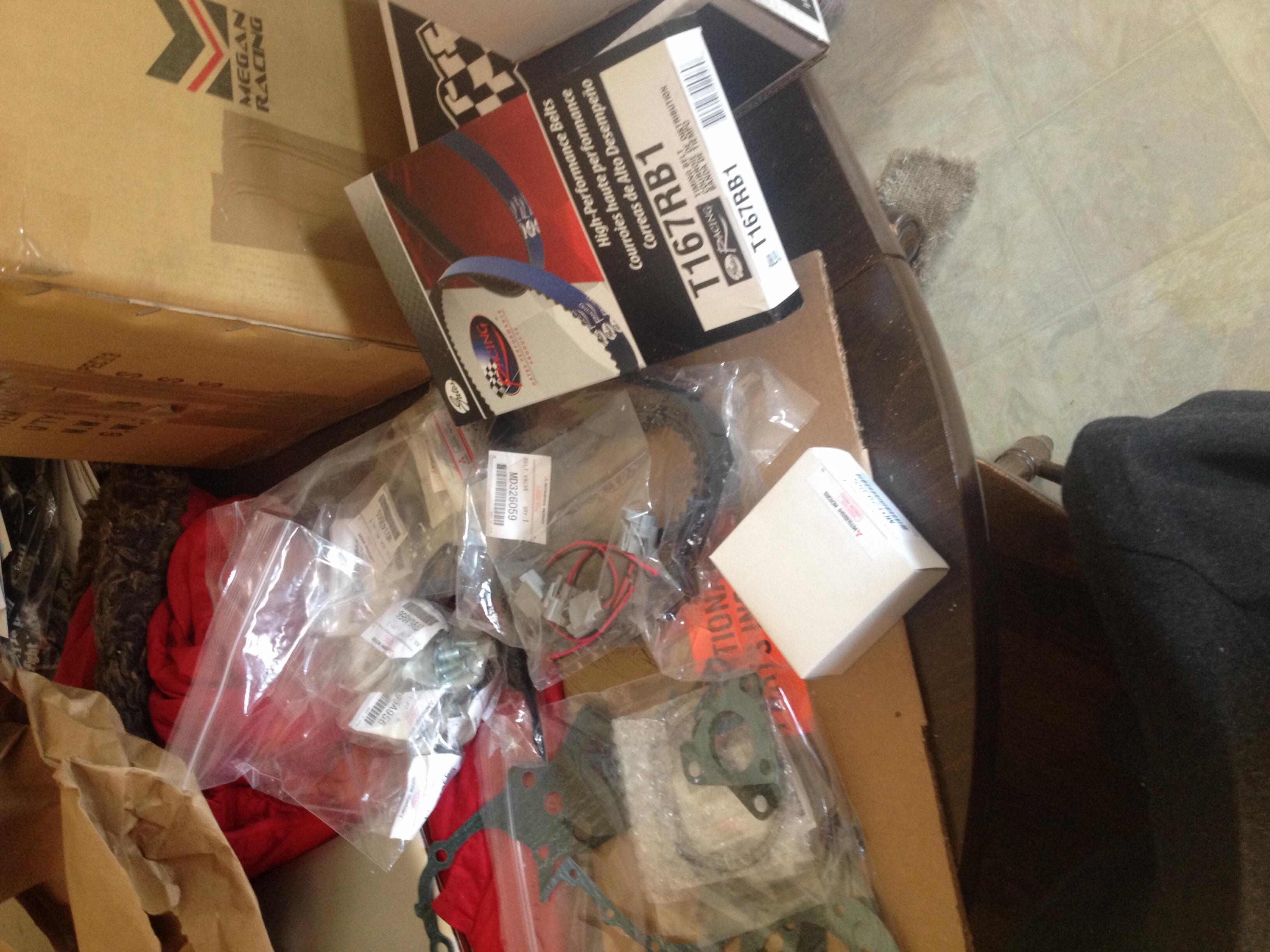

Mucho parts delivery for my red rocket. Kiggly crank trigger, fluidampr harmonic poop slinger, gates rubber band, competition twin disk, and a bunch of bolts and gaskets u could forget about until you pay for them. So far I'm ready to prime the oil pump and then time the motor, than maybe fab up a timing cover and make sure I have a starter plate that will work. Who knows maybe the weather will cooperate and I'll get to drive it this year. Still undecided on what to do about the turbo. Keep the 3582 the way it is this year or upgrade to a 3586. Hmmmmmm does size matter this year???

Keep the turbo, just be a waste of time and/or money at this point.
You might run the 3582 and want to go straight to a 3794 or something, size might matter if you feel insecure? lol

lol funny post man, but why would this be a waste as fp site says my turbo would go from 62.5 to 75 lb/min. thats 100hp difference.

Because not everyone maxed turbos. Like I said you might want to go way bigger or something. Plus not like that option will go away so you don't need to do it now. But if you want to and it won't hold your progress up then go ffor it

Very true about the gaskets, I think the gasket set for my 2.3 build was 225-250 something in that area

Haha yes people forget about the expense of gaskets, dowel pins, and bolts, it's the worst too because they add up fast and they are all boring parts to look at
