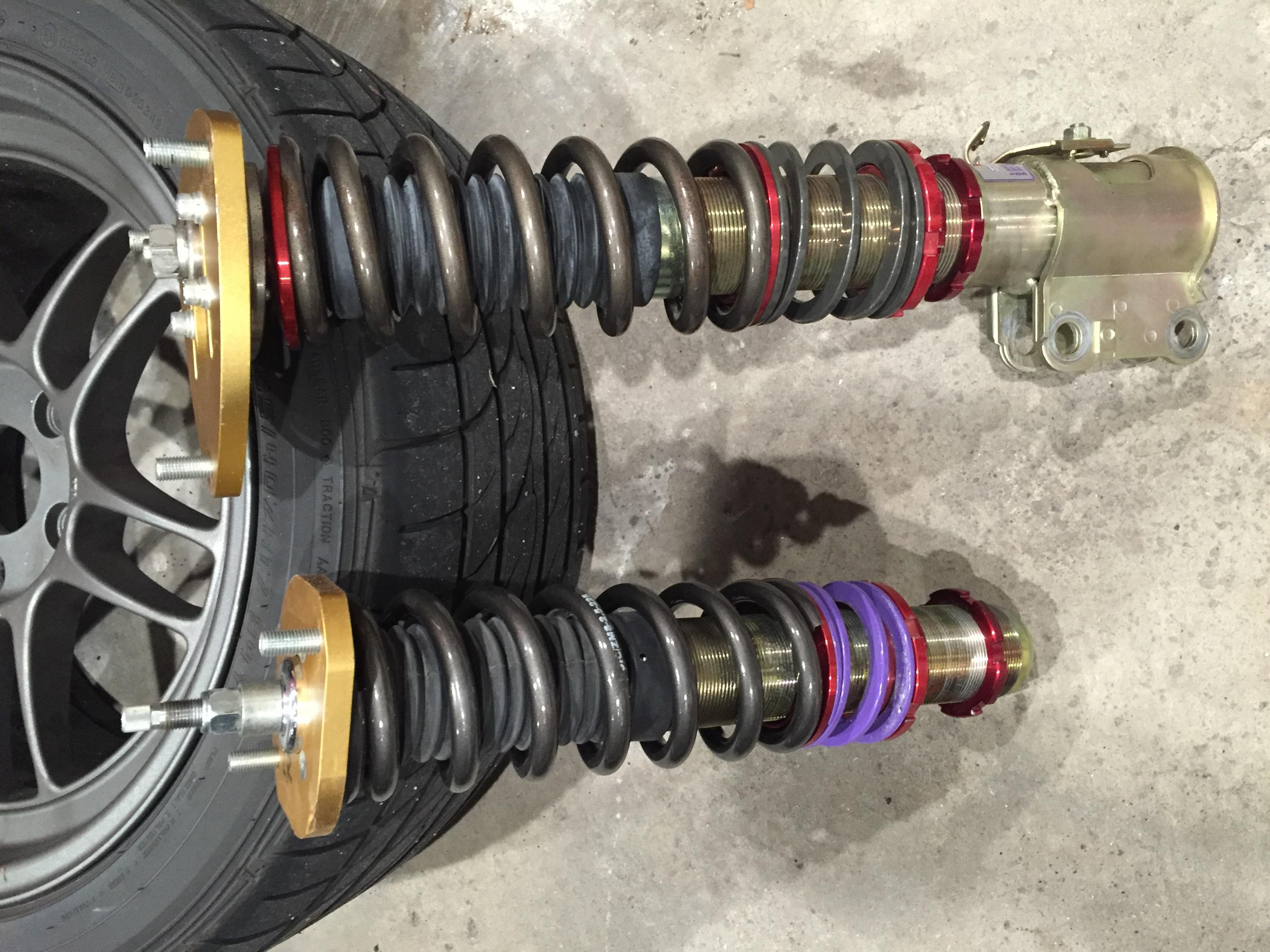

Re: Comfort comes home-Project Lexus GSX
Well, continuing off my last post and deciding I can't get there from here, I picked up a set of good coilovers from EvoM, JIC Magics. Of course there are a few challenges, but that's what makes it fun.

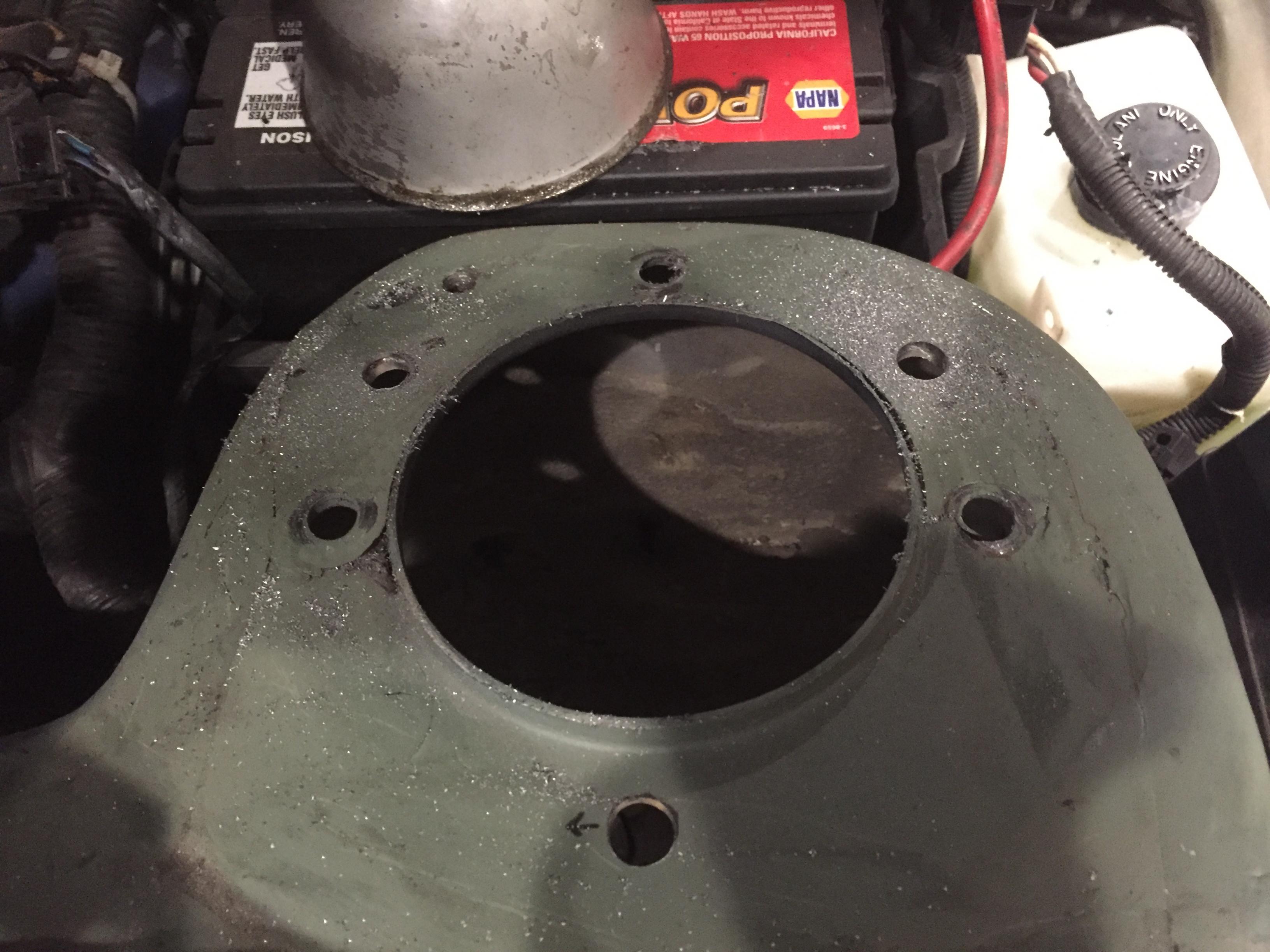

Then comes the fun part, converting from Evo fitment. First, after a lot of measuring and luckily having an Evo 5 feet away, I drilled new holes for the top mount.

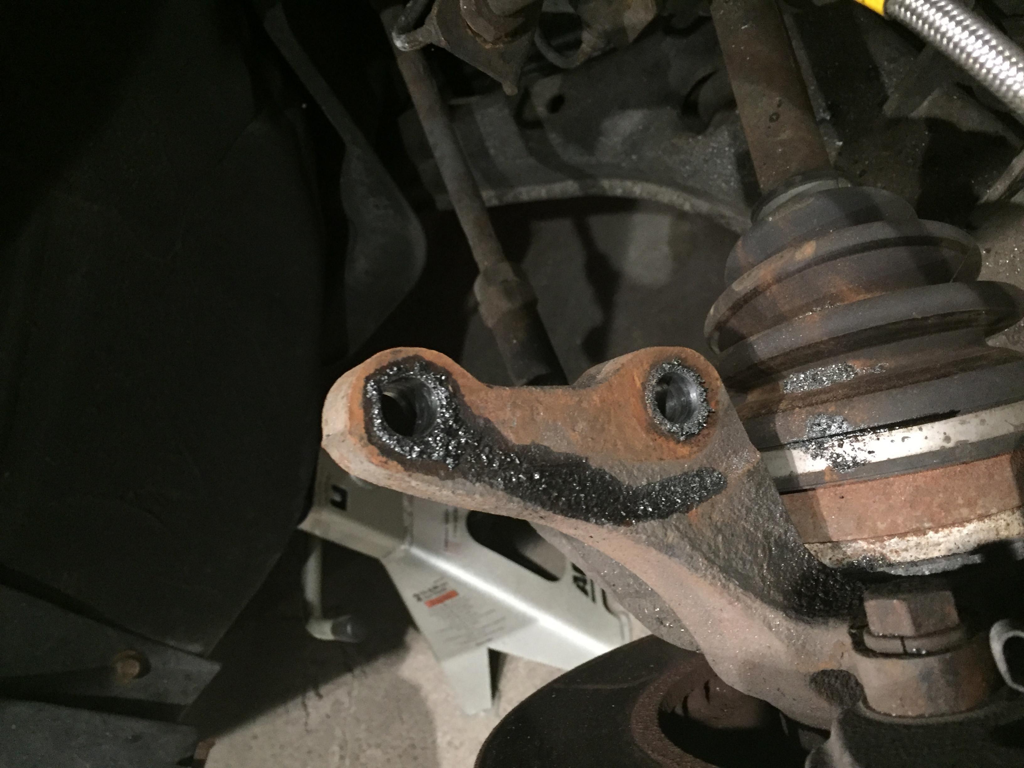

Then comes drilling out the lower holes for the larger Evo bolts and grinding off the factory eccentric portion of the upper bolt since I don't need that weak camber adjustment anymore. Up next, fabbing the brackets for the extra width of the coilover lower mount and bolting up the fronts. Holes on the shock tower will be welded up and the whole engine bay will get painted this winter.

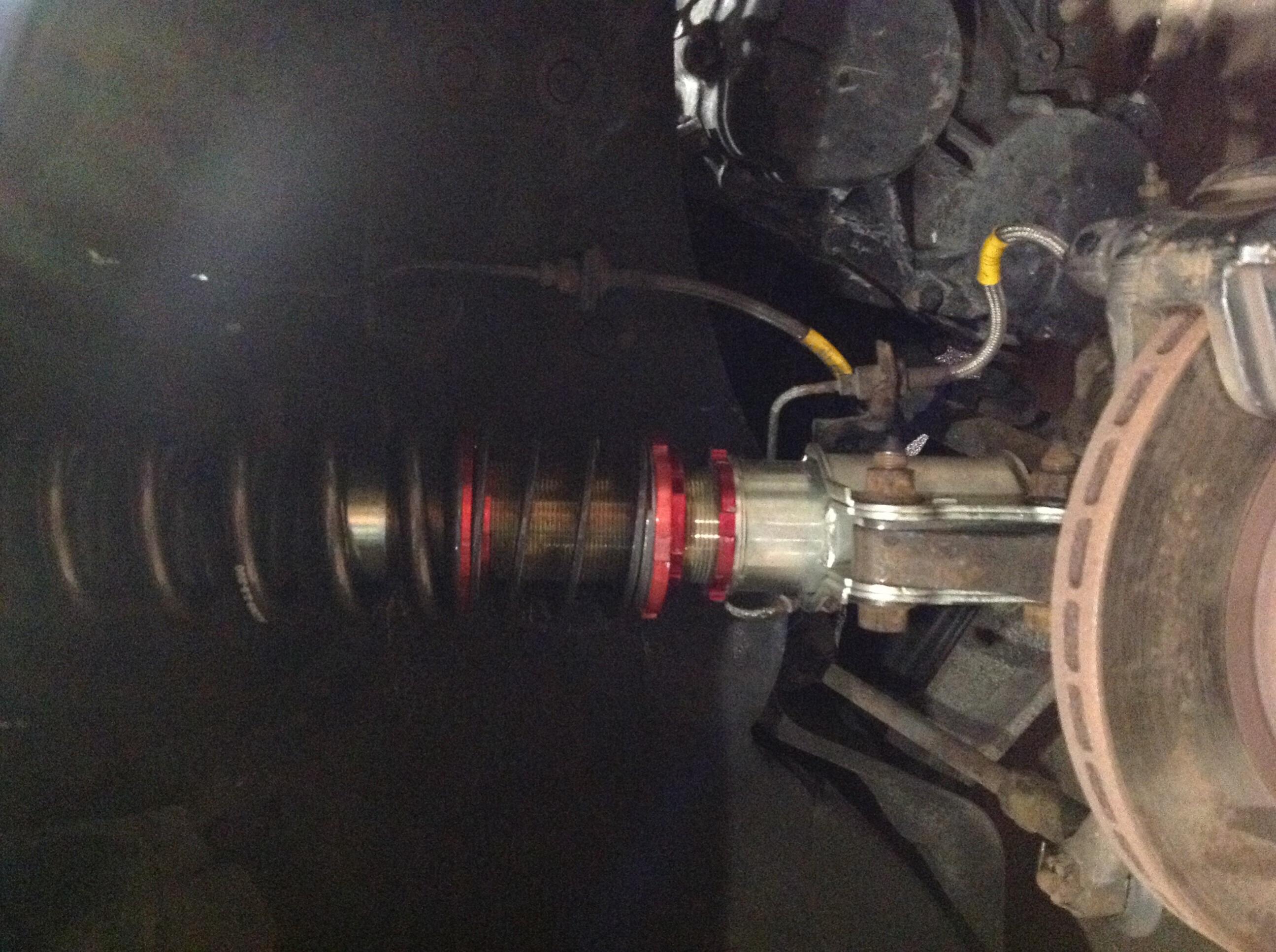

Success! One down, three to go. Bonus, with a little coaxing, the factory brake line mount bolted right up to the JIC.

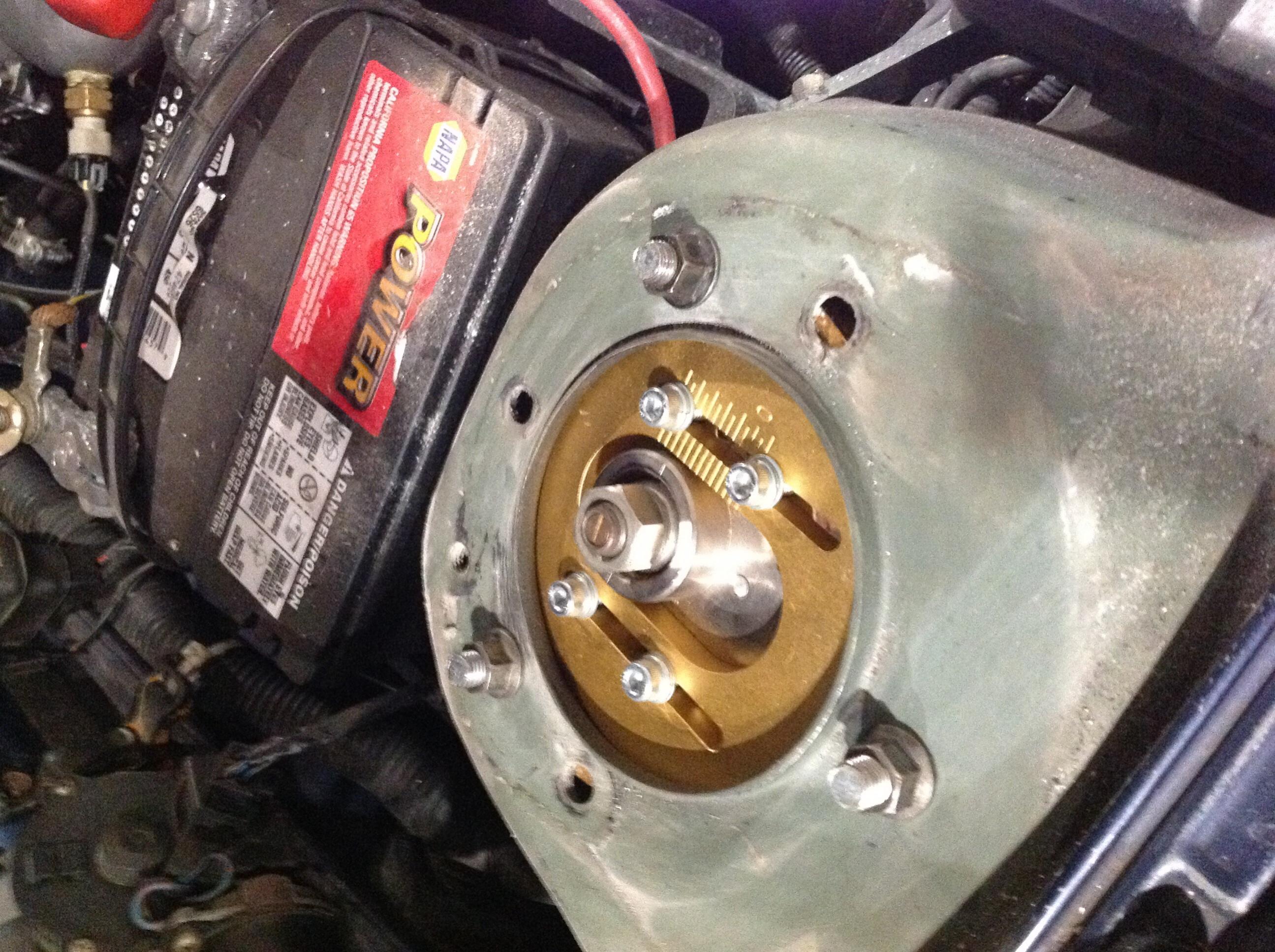

Old 08-02-2016   #129
Not sure why the pictures turned sideways.
