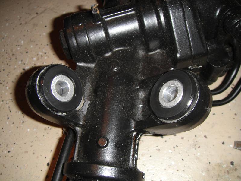

Steering rack is in with the new TME poly bushings. End links have been tightened up, and the new tie rod ends are pumped up with grease. Filled up the PS fluid and took it for a spin around the block. Car feels MUCH tighter, it was immediately noticable! I think the steering bushings are mostly to thank for that. The old ones were stock rubber, and were falling apart. I'm sure new stock rubber ones would have felt better also, but they're still rubber and have a little play. These poly ones are stiff. I love them
What was funny though was we must have been off a little bit when putting the steering wheel shaft back on. The car still drives perfectly straight, but the steering wheel is like 100* off. It's pretty funny looking cruising around with the steering wheel that far off, haha.
Also I think the motor mounts made a difference as well. Steve even mentioned before that when you just free revved the car, you could feel the motor shake a hair. That is gone now, you hardly feel anything!
But also thanks again to brownman for stopping by and helping me. I would still be trying to get that f-in rod in if it wasn't for you man
Next I'm going to move onto the rear end. I have the new rear swaybar endlinks to install, but while I'm back there I will be checking for anything else out of the norm. But I'll wait a week or so to do that, I want to enjoy driving the car this weekend.
I am honestly really happy I'm approaching things in this manner, meaning doing all this maintenance up front before throwing power mods at it. Just this alone made the car feel so much better to drive, I'm amazed!

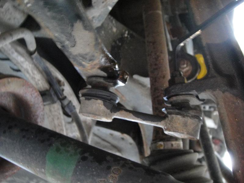

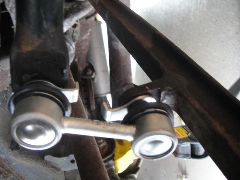

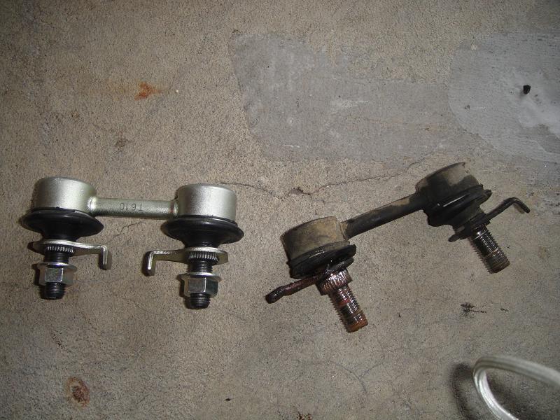

Since it's a nice day I decided to hang out outside a little bit and do some more.
Rear sway bar end links are installed. The old ones actually didn't look horrible, but apparently they made it 150k miles so hopefully these new ones will also
I'm also going to try and work on the steering wheel issue a little this afternoon as well.
old:
old vs. new:
new installed:

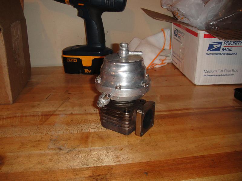

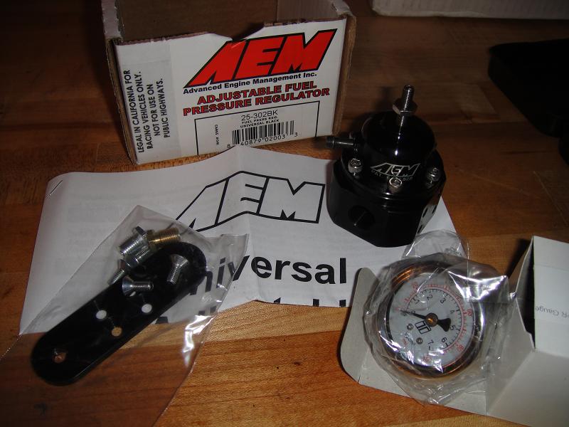

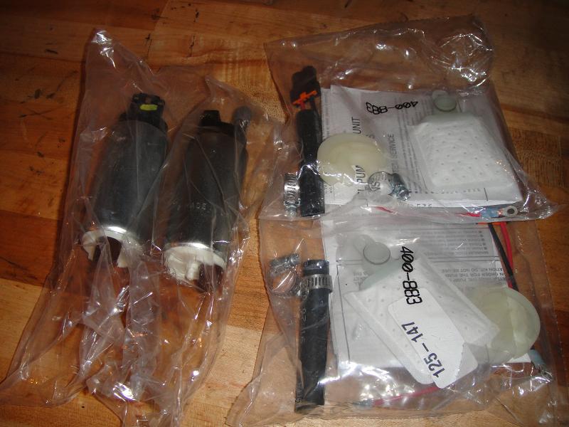

Spoke with Ricer Pete a little bit today, and will hopefully be having him getting this thing alligned
Also got some stuff today!

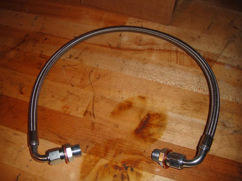

- SS Braided Power Steering line from Drift Motion (to replace my possible leaking 160k mile stocker.
- Tial 40mm wastegate I got used off the Link forums. This is what the manifold is flanged for, so that's what I'll be running!
- AEM AFPR w/ Turbosmart liquid filled gauge. Great price from the folks at MAP, and they had them all in stock
- Two Walbro 255hp pumps. Once again, thanks to the guys over at MAP, had it all in stock
As the maintenance stuff is winding down, I'm starting to focus on mods I can start to do. As you can tell, I've decided to start tackling the fuel system. Plan is basically to run a dual 255hp intank setup just like I had on my 1G. Worm clamp em to the stock hanger assembly and set em up in parallel.
I'm unsure what the stock fpr can handle, so just for good measure I decided to grab this AEM AFPR from MAP that they have priced very nicely. And I like the fact it's black, and not bling bling anodized red/purple. Haven't figured out where to mount it or line size or anything yet, but that's ok this is still just the acquisition of parts phase.
