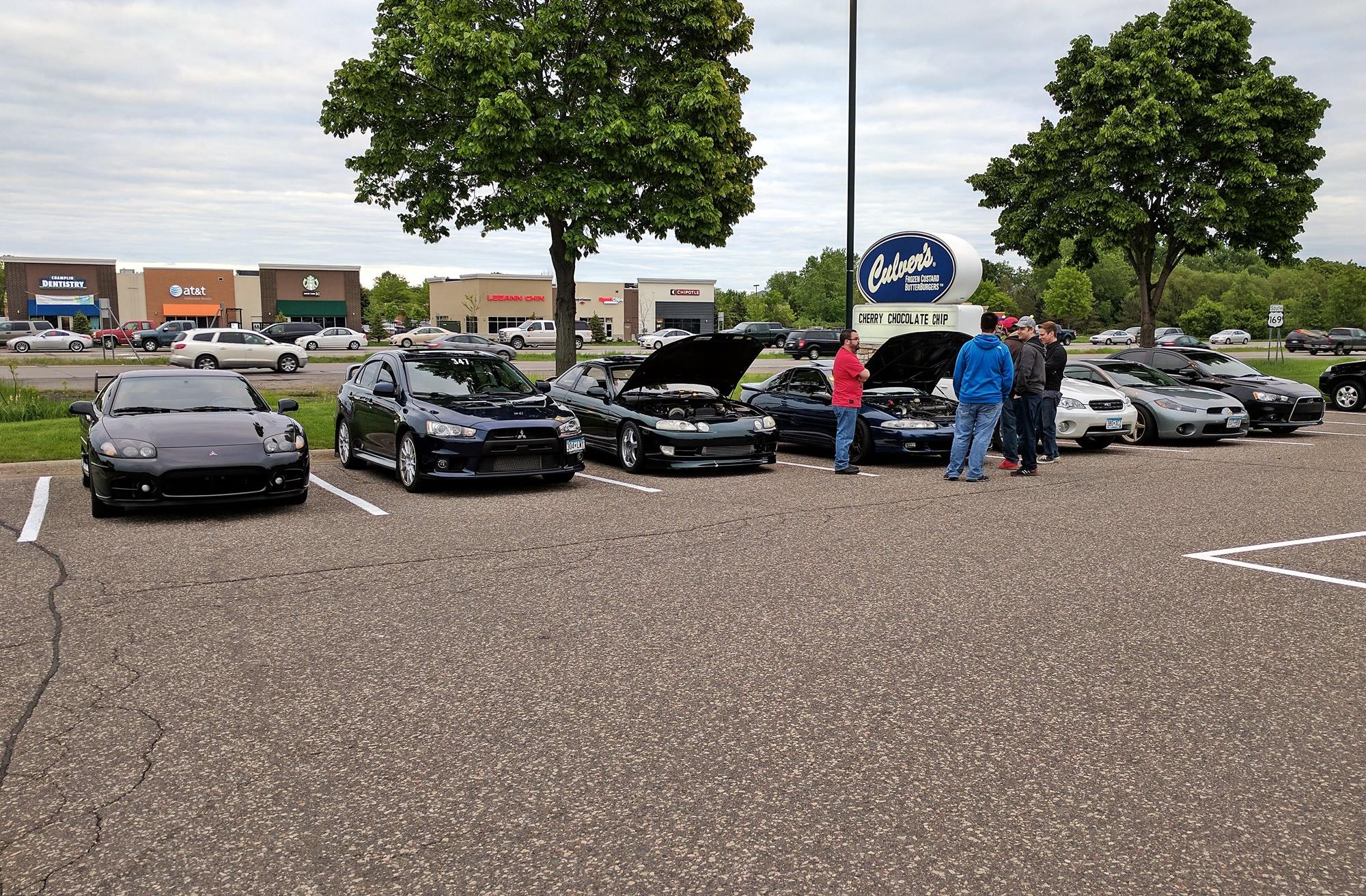

Crashed the mitsu party today Good seeing some old faces! I mean not old old, I mean old I haven't seen you in awhile. OK but maybe kinda old

Crashed...
Don't scare me by starting posts with that word...
I thought the exact same thing when I saw the email on my phone lol.

which car was faster?
Depends on frum dig or frum roll lol!

Mmmmmmmmm... Cheese curds!

Good seeing you too! Man, that car looks beefy pulling away with those big rear meats.

^^ Thanks man. It's already parked in my garage half apart, lol. Started new FMIC surgery last night.
