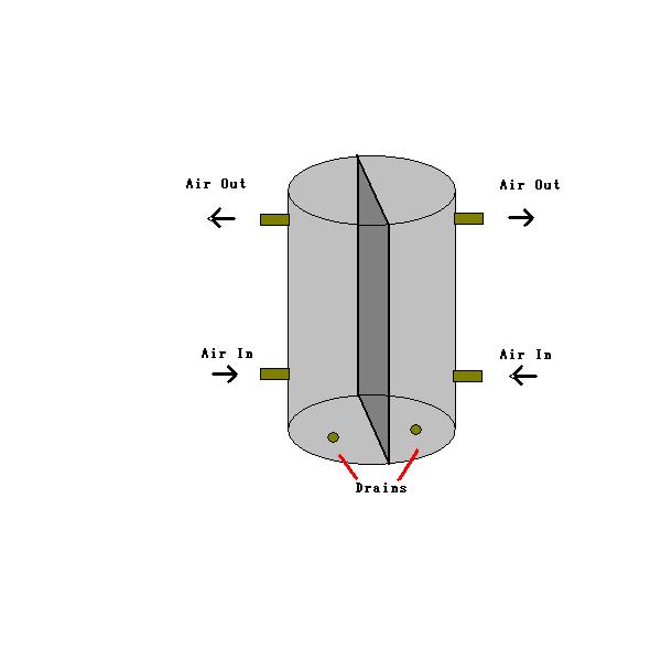

Also just talked with Jim at JMF about making me a custom dual chambered catch can that should help save on space a little, and look nice and clean like everything he makes does. Attached is a real rough drawing of it to give a basic idea. Also since I seem to have no time anymore and really need to get this thing running, I ditched my SMIM manifold project and just purchased a new Race SMIM from him as well. I still plan on building my manifold for fun, but who knows when it'll get done.

A question for you, with the inlet so low, what will happen once the fluid level becomes higher than that, won't it start to backup the tube?(depending the tube level of course)
Just something to think about maybe.

Good thought. They should be placing the inlets about half way up actually, and the outlets towards the top. I'll just have to make sure I regularly drain it.

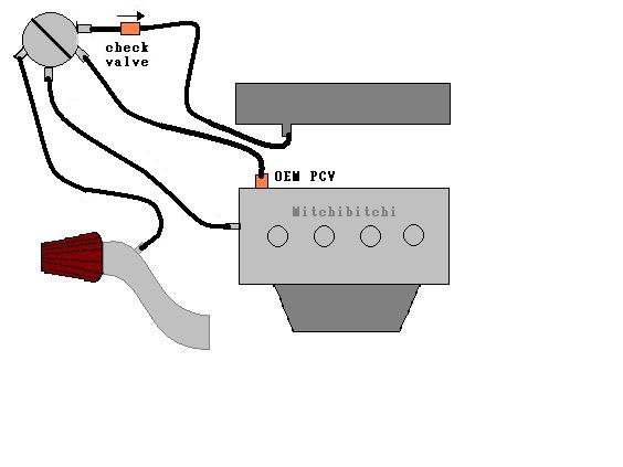

Mine will just use rubber hosing and barbed fittings, but he can do AN as well.
Here's a quick idea of how mine will be setup.
