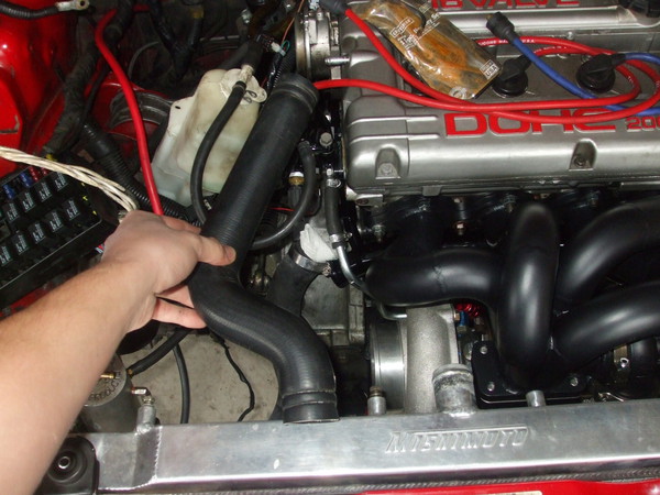

Have you homie J-funk, move the outlet on the radiator, its honestly a 10 min job.

damn sucks about the hose. Wasn't an issue on mine since the hose connects to the radiator in a different spot on 1G's I guess. Might want to look into getting a custom hard hose welded up. Or move the radiator outlet towards the passenger side a little and maybe see if you can run a 1G hose.

I'll take a look into bringing it up to primo and maybe having them move the location tomorrow I guess.. This one cought me off guard as I was not expecting the radiator hose to touch..

Well looks like I will be dropping off my radiator at primo to have this welded where the hose goes to in the picture... This is more then I was hoping on doing..
On a side note I called SLS about this fitment problem and they blew me off saying that they installed it on multiple cars and never had a problem. So I told him that 1Gs have the hose located in a different spot and asked if they sold a different upper radiator hose to correct this problem and he told me to "lengthen my stock upper hose" as if I can lengthen a radiator hose that's cut to stock spec! SLS service

Well been working too much so gonna have to see if I can bring that radiator up to primo on Friday after work..
Does anyone have any other ideas besides doing the rewelding of the radiator? Already tried shortening the hose and still hits..

Make a hard pipe like the supra guys run with couplers on the ends.

I would think that would take more time and money..

^I could help with that, but I'd need to know what shape it has to be in.
Stop by this weekend and we can figure it out. also leave our transaction review in my thread and the link on that page too.

I guess I don't see what the problem with the radiator is? Isn't that the normal location for a 2g radiator hose? Or does the 2g hose hit your exhaust manifold?

Yes to both questions

SS piping is cheap and i know someone with a new welder that can weld it to the right shape. will look real nice too instead of a rubber hose.

^may have to do this but that person lives so far away..
