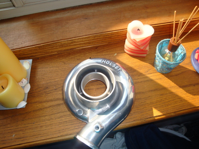

I just finished polishing my compressor cover, for my first time polishing, and how lazy I was, it turned out pretty good. LOL those aren't my candles either.
I also got my lower intercooler pipe set up for the Holset, and re powdercoated at Primo.
Should be getting my pushlock drain tube any day (I hope!)
And so I just need to spend some time with the car and get it all buttoned up!

Re: My Talon
Sweet!

Wow.. That looks really good! Better than I did with my 16g..

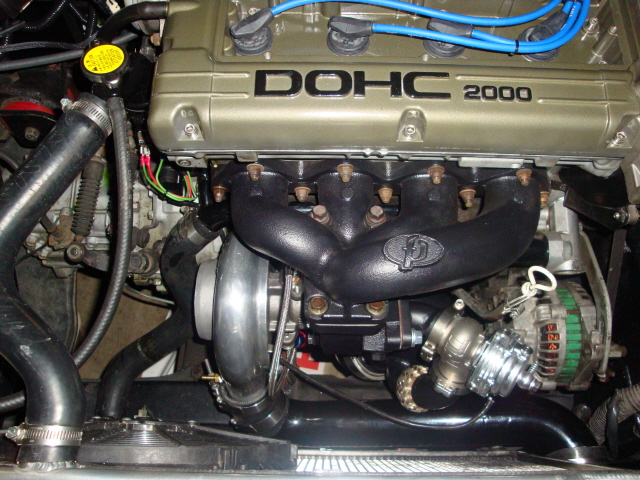

Ok, so whenever the hell it warms up a bit, (tomorrow/sunday) I'm gonna go put my o2 housing/wastegate on, and hopefully start my downpipe modding. I also need to tighten a few fittings on my oil filter housing. Pics soon.

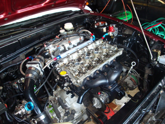

My mini-laptop should be here tomorrow so I can start linking it up! But this shit weather might hold me up till next weekend.
Some newer pics below. I'll get better ones once the car moves.

Damn dude, looking good!
Old 03-29-2009   #179
Re: My Talon
Glad to see I'm not the only one with "modified" thermostat housing wiring. Looks good man!
