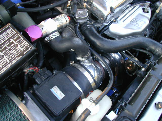

I have the 4" FP Intake on my 99 GSX. There is no problem with the 2g MAS. The only problem I see is finding a reducer from 4" to 2"(or whatever the inlet on a 14b is).
I have a 4" to 3" reducer for my 50trim that you can see in the picture. Find the right reducer and you should have no problem making it work.

Re: FP Intake
.... another pic in addition to the one above
