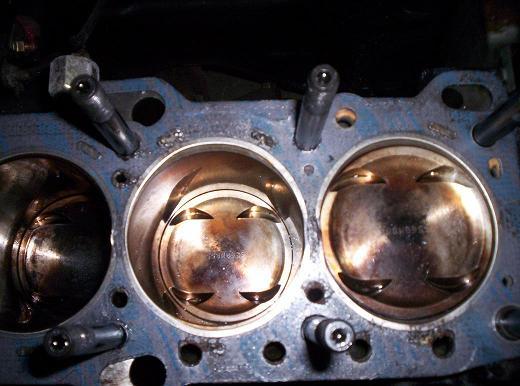

Location: Big Lake MN
Drives: 98 Eclipse GSX Auto
Posts: 1,516
Re: Coolant over flowing
Just be happy this didn't happen to you. some serous detination blew the fire rings in the head hasket. notice there oval now instead of round, and blown between the clyinders. the stock head gasket saved me though no damage to the pistons cylinder or head.
