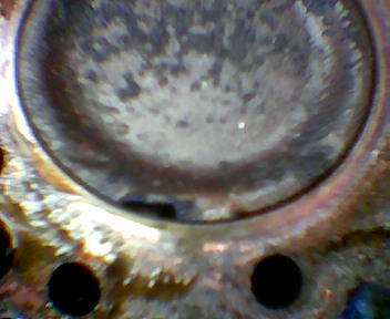

Originally Posted by sleepydsm
I'm pretty sure the problem is in the bottom end, and if so I'm just gonna fix it, and sell the car as planned The end.
It was the bottom end. Take a look at this picture taken when we pulled the head. The side of the piston looked melted and all 3 rings were gone in that spot.

ooh damn! ouch! Tough luck man. Time for something more tough!
