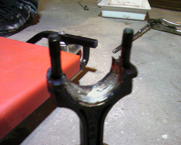

Heres a pic i took with my phone, I'm having a hard time uploading them all together so i have to go one by one.

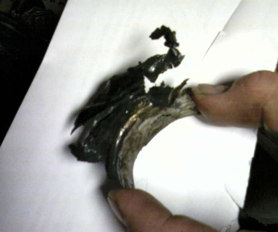

pic 2, this is the other half of the bearing

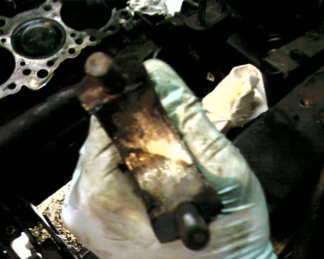

pic three

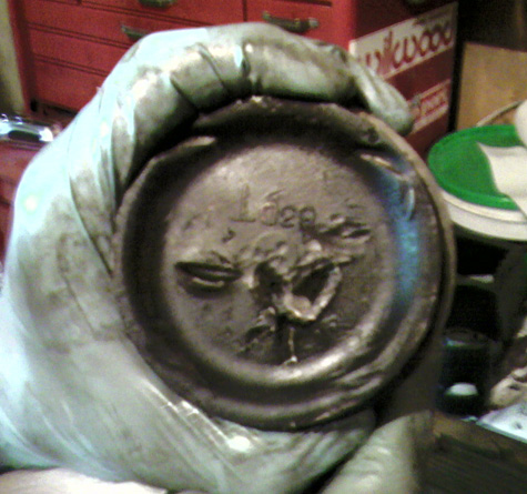

this was a pic of the top of the same piston that had the shredded bearing, the thing is that there was no broken valves, but you can clearly see that its a broken off valve that hit it.

There isn't really much point. The engine was definitely oil starved. The filter will be full of crap and the oil pump bearings will probably be in rough shape.

another strange thing, none of the valves were visibly bent from this cylinder, its almost as if this piston was reused on a previous rebuild, could the car even run correctly (for a few thousand miles) if that were the case?
