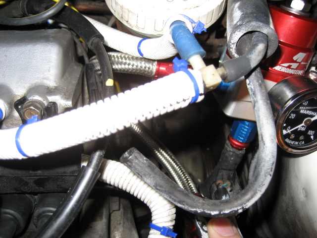

Posts: 110
Re: AFPR Problems

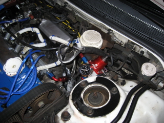

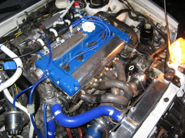

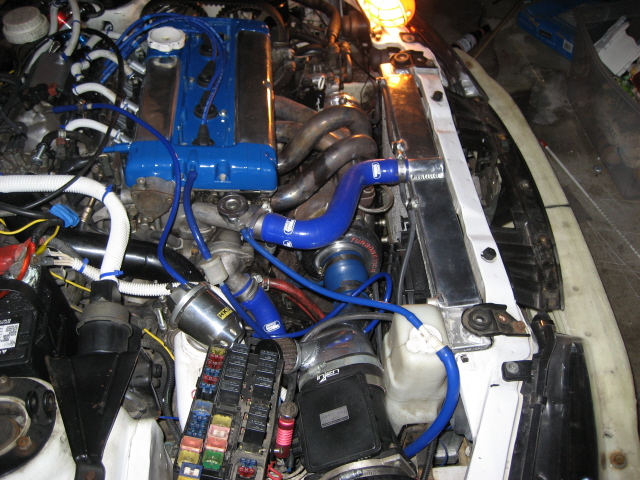

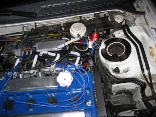

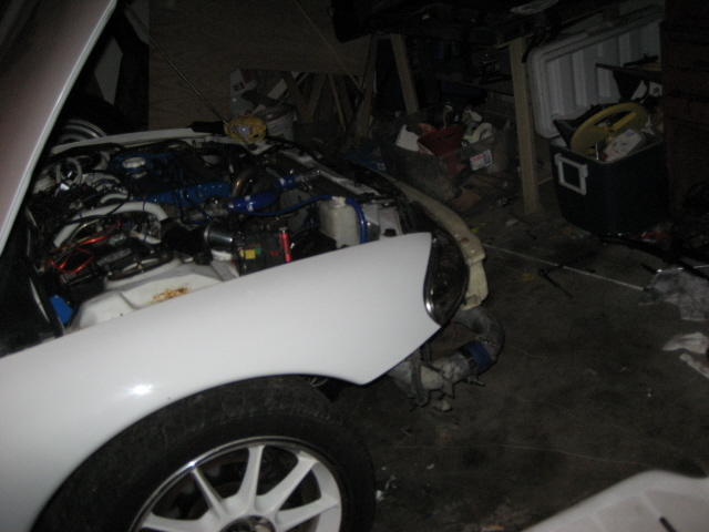

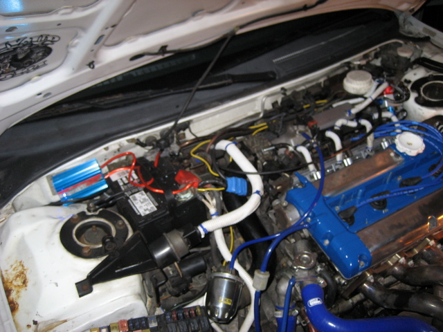

here are pics.//
ID:	5221   Click image for larger version
ID:	5222   Click image for larger version
ID:	5224   Click image for larger version
ID:	5225   Click image for larger version
ID:	5227   Click image for larger version

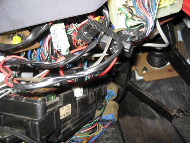

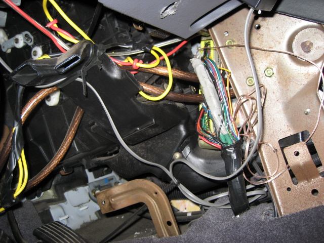

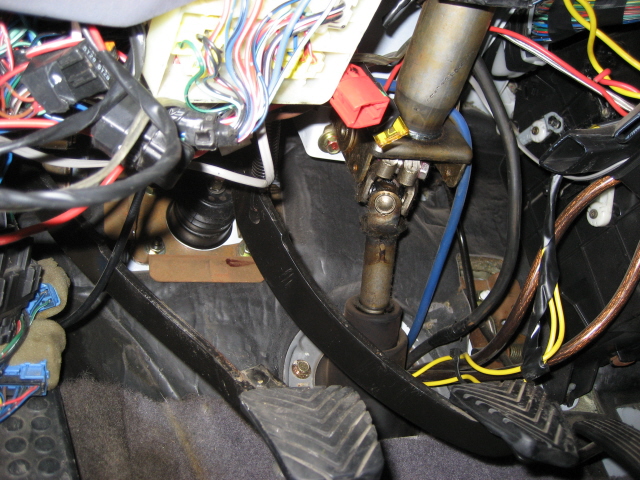

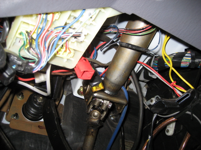

here is the wiring mess im dealin with. this was like this when i got it.
ID:	5229   Click image for larger version
ID:	5230   Click image for larger version
ID:	5232   Click image for larger version
ID:	5233   Click image for larger version
YOU GOT MY MONEY!!
Talon628 is offline

The fuel line goes from the fuel rail to the AFPR and then from the AFPR to the rubber return line right? It's a little hard to see in the pics.
Is there a little air filter on your intake pipe right after the MAS? That would cause some major air metering problems.
I didn't notice that. This thread just gets better and better!
yup, and the filter is blocked just was seeing what it looked like lol.. it dont look good either was bored and found it in the trunk.

yeah thats all good and great but i dont think in that mess of wiring i will be able to figure how to get a safc or dsm link hooked up ya know unless im givin like an really specific instructions and even then i dont think there is one single wire or harness where it should be, if you have like a picture of it hooked up in a car it would help me alot, i learn more from pics and hands on then words.

dsm link is a chip for the ecu you do not need to wire it in. Just have to have a eprom and have some one socket it for you. the wiring does not look that bad I have seen and fixed worse than this. The worst was a kid on here that put in a safc and used duck tape on the wires to hold them to the ecu wiring after he striped the wires and he could not figure out why it did not work right.
That is his air meter by pass filter, it needs to be bigger to avoid fuel cut though, or his flamitation valve is sticking.
