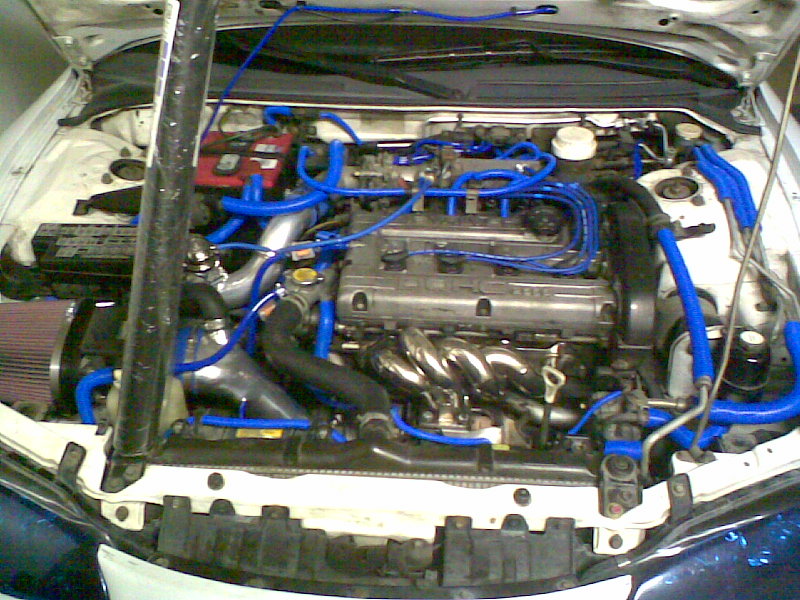

Posts: 3,012
Re: Krank Vent replacments
Is that big metal tank thing your catch can? Couldn't you just use something small like this?

pics or gtfo

I have the same catch-can that Scheides has, which is the aluminum tank next to his battery. Using a fuel filter as in the picture above isn't really a "catch-can" and isn't the idea setup for a few reasons. 1. It doesn't catch most of what a true catch-can does, and 2. Try blowing through a small air filter and one of those fuel filters. Much more back pressure is created by the fuel filter since the filtering medium is designed for gasoline, not air. Under boost (when the PCV valve is shut), the fuel filter is making it much harder for pressure to escape from the crankcase.
Old 03-19-2008   #18
Especially when the media is soaked in oil. One with SS mesh in the fuel filter may work alright.

Something small like what? All I see is blue....
Old 03-19-2008   #20

^lol yea that pic gives me a headache too but it's all I could find. Where can I find one of these metal catch cans or how are they made?
