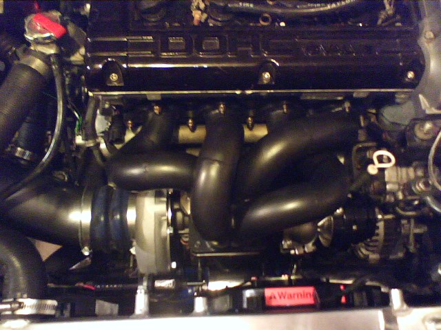

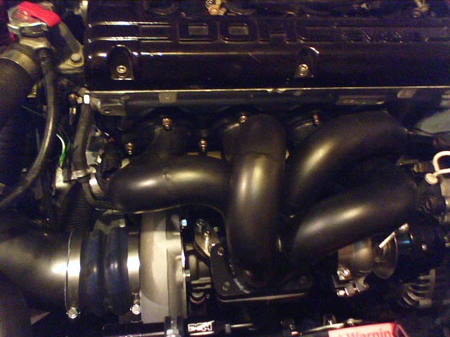

Little by little, getting more done.
Today I got the SS socket head cap screws put on the valve cover. Got some new studs for mounting the TB. It is mounted now. I had to take the coupler off the TB and put it back on. I'm getting better at it, but what a PITA. Anywho, got the TB mounted with studs and nuts, got the UIC pipe on. Took the turbo off because I want to take the coupler to work tomorrow and cut it down a little bit. Also need to modify the lower IC pipe. So will be taking that to work tommorrow to cut. Also got a new coupler from Napa to replace the ghetto one that was going from the FMIC to the UICP. I took the air filter off to give it it's yearly cleaning. It gets pretty dirty in that fender well. Also took off the old small mitsu filter and replaced it with the ultra small RX8 filter. Getting close! All I have for a camera right now is my cell phone, so sorry for the shitty pics.

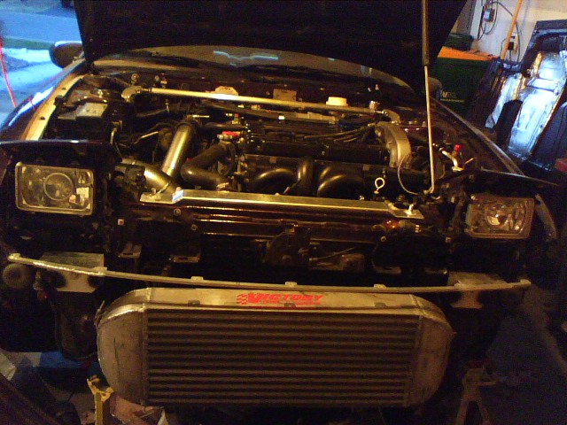

Got a bit done today. Picked up the 2nd FAL fan and installed it as a puller. Got all the IC piping hooked up, which actually ended up being kind of a PITA since the turbo outlet is a little lower then usual, the NT TB. Glad I had a spare hump hose laying around as it helped a lot on the lower IC pipe. But got it all worked out. Turbo is back on, intake is on (haven't put the MAS or Filter on yet). FMIC is on.
More shitty cell phone pics attached!

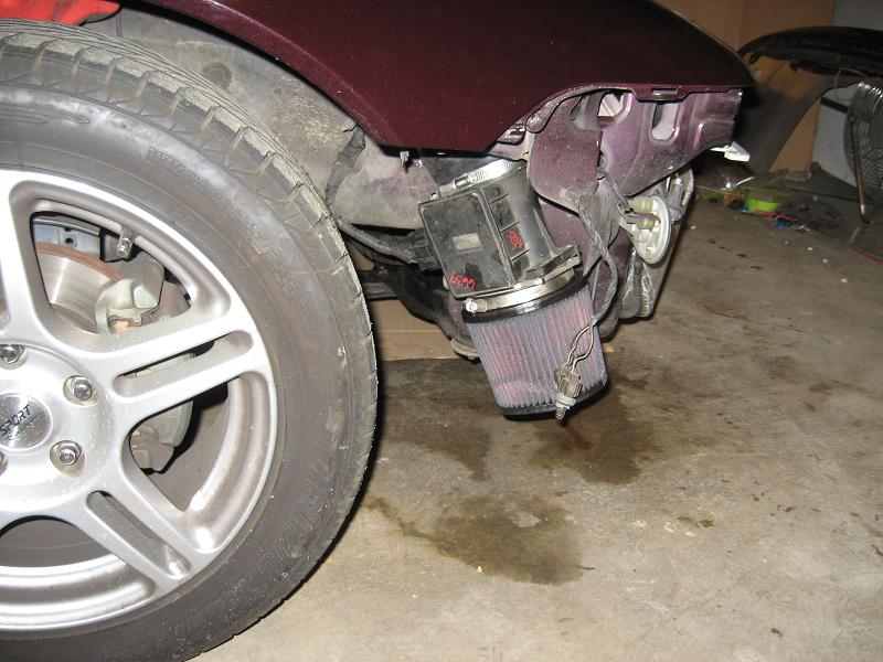

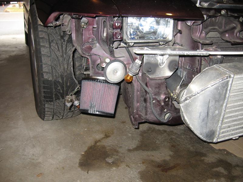

I like that intake pipe. So where is your MAF?
Old 04-05-2008   #130
Re: My Winter Upgrades
Thanks, Kyle at MAP made it. My MAS attaches to the end of that pipe, and the filter right on the end of the MAS. So they are both located down in the stock SMIC area.

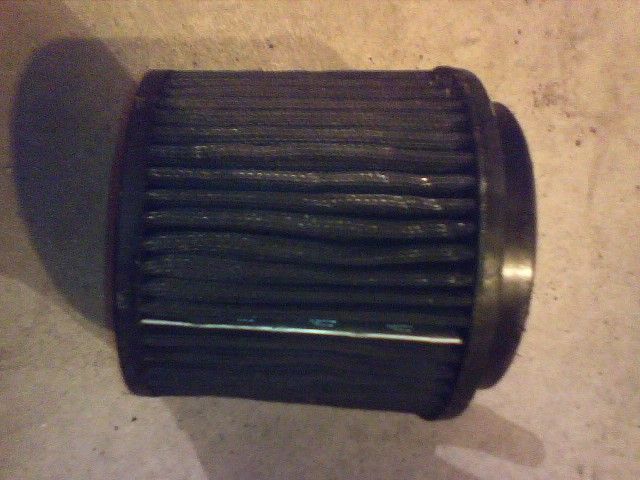

Got the filter cleaned up pretty good, just need to oil it up now and I can put that stuff on. Still gotta put the new fuel line on and the dual Walbro setup. Then I should be trying to get ahold of Jet to get the new exhaust built.

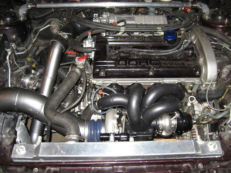

Well got a lot of the loose ends tied up today. I got the JMF Battery Kit installed. The install isn't perfect because apparently you need the A/C removed for it to fit right. But I got it half assed in there. The battery just doesn't fully sit inside the little square base where it's supposed to.
My filter is cleaned and I installed it an the MAF. Got the Turbo oil drain hooked up. Got all the misc tools and bolts removed out of the engine bay. Finished installing the rest of the SS hardware I have for now. Relocated the coolant overflow. Added coolant and Pennzoil Platinum 10w30. Basically it's all buttoned up for Jet to build the exhaust for now. Once the exhaust is done, then it's just a matter of me triple checking everything before starting it up. Now, gotta get ready to leave for Spain in 7 hours.
Old 04-07-2008   #137
Various pics I quick took.

I found a TB today, car looks good, however i am a little worried about the position of the MAS sensor in the wheel well i am not sure how much that thing is gonna like rain.
