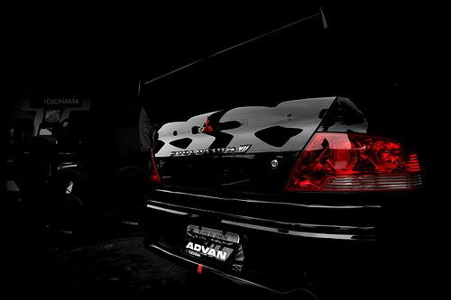

I'm looking at options for painting my tails to make them JDM Evo VII style, and stumbled across this stuff:
I was straying away from paint because everyone I talked to said that they ended up looking pinkish. Well with that paint above, someone got these results:
Not half bad, very nice red color! But my main concern is, how will a paint like this hold up to daily use on a car?

Testors is model paint, so the chance of it standing up to the elements is questionable. I'd put a quality spray can clear coat on it and not more model paint, then take care of the taillights like you do the rest of the car.

I think that this with some wet-sanding actually looks better.

I painted a model car with that exact color (LOL a mitsubishi eclipse actually..) and it's like a darker red, but it's transparent, so it should look great on tail lights, and I don't think you have to worry about them looking pink if you use a good clear coat
