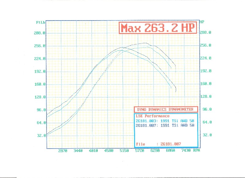

Attached is my dyno sheet with the DKS 272's. Take it for what it's worth. This was on pump 92, bolt on 50 trim, right around 20psi, stock 1G intake manifold, fmic, typical supporting mods for that kind of setup. This was after the tune was complete. I did have knocking issues also, so take that into account as well. I went back to LSE (same dyno) maybe 4 months later, with basically the same setup, but with HKS 272's, and made 285hp. I swapped out the DKS's and swapped in the HKS's the same day. Right away I noticed the lopey idle with the HKS's, which gave me a feeling that these cams were actually doing something. And the care "felt" faster. The DKS's idled just like stock, and I honestly just didn't "feel" any gains up top like I always hear from people who just upgraded their cams.
