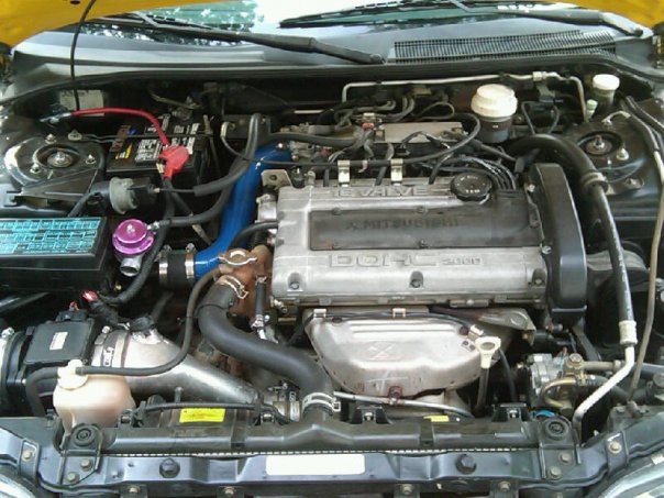

its still a virgin but suprisingly clean

Why are you venting?

i know i know its how i got the car just havent got around to take care of it yet not sure why people do that

and of course the guy before me used electrical tape to plug the intake hole lol

T0 hear that loud BOV y0!!
My car was like that when I got it also, it ran like shit.

Vented BOV was also the first thing I noticed.
Second thing was the dejon S pipe to the throttle body, I used to have one and the flange is super thin, I had to use some RTV to stop a boost leak there, a gasket didn't do the trick. Just a place to check for a potential boost leak.

vented bov fixed megan racing downpipe installed thanks to my man pat out in rogers thanks for the help yesterday bro......we didnt get to the megan o2 housing yet since pulling the stock o2 housing is a pain without pulling the turbo but we will get there eventually lol
