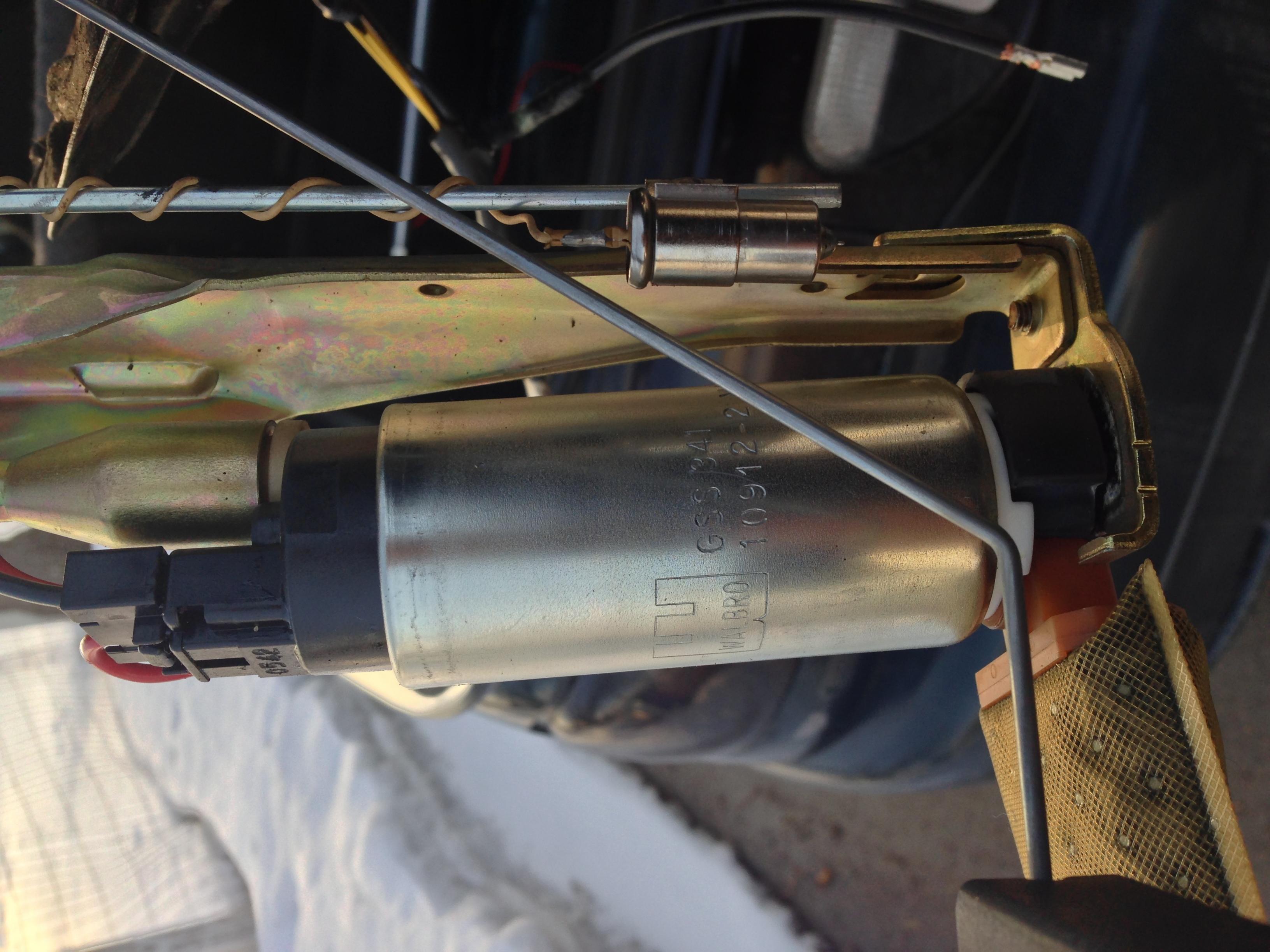

Well, today I pulled the fuel pump to do a complete rewire. I found a Walbro 190 not a 255 like I thought I had in the tank. So I put the rewire on hold until I pick up a new pump.

Ok I ordered a 255hp fuel pump, went ahead and did the rewire at the connector. When I get the new pump, I'm going to rewire it down to the pump and run a new fresh ground from the pump.

Got the new walbro installed after work today.
Hah wow, wonder if that's the one I installed way back when. I didn't go with a full 255 because it wasn't a race car (LOL) and I wanted to keep it simple on the street.
Yeah not sure, oh well. Glad I handle this before going in for a tune. It was pretty loud and since I was told it was a 255 I never questioned it. But I can't believe I didn't do this earlier, especially the rewire.

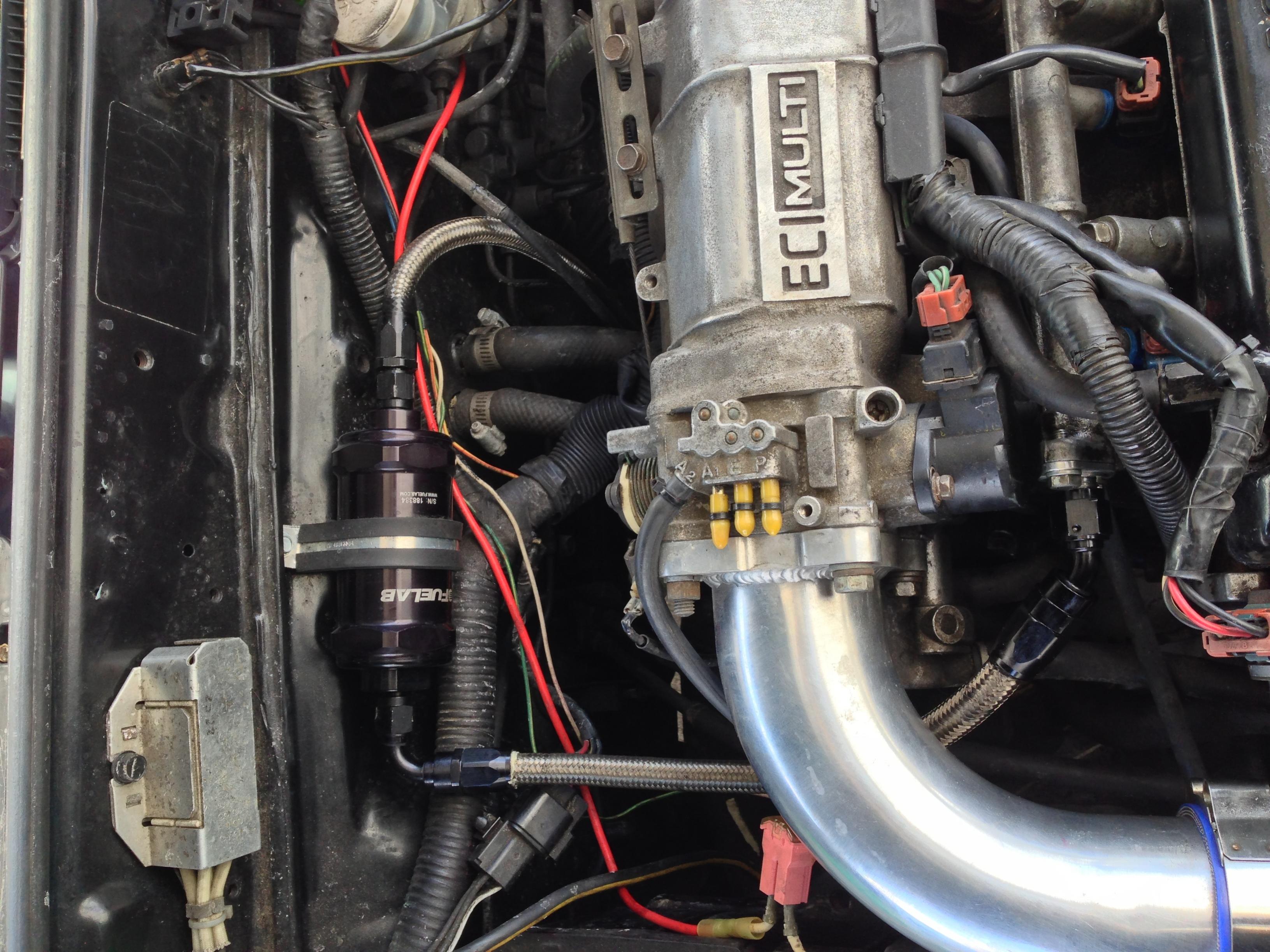

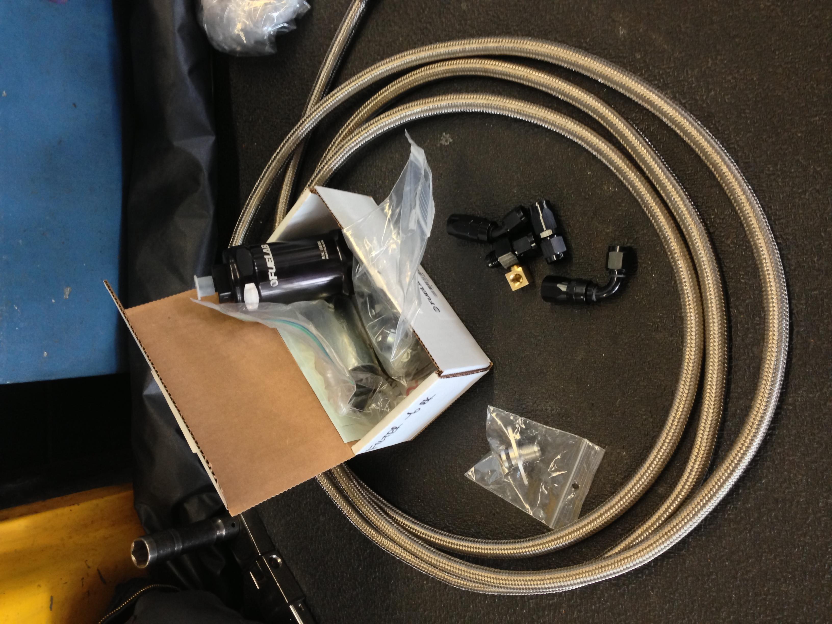

Installed braided stainless fuel line from the tank to the rail with -6an fittings and a fuelab filter today. Ill get more pics up later.

Why the line from tank to rail?

Since I've started driving the car there has always been a fuel smell but no major fuel leaks. I finally got around to fixing it, it turned out I had a few issues. The sending unit had no gasket and half the studs on top are broken off. Also, the hose section was seeping at the crimps. I decided to just replace it all and make it look better too.

Pic of the new fuel line/ filter, today ill be installing a prosport fuel pressure gauge, and a prosport egt gauge. Ill post pics after install.

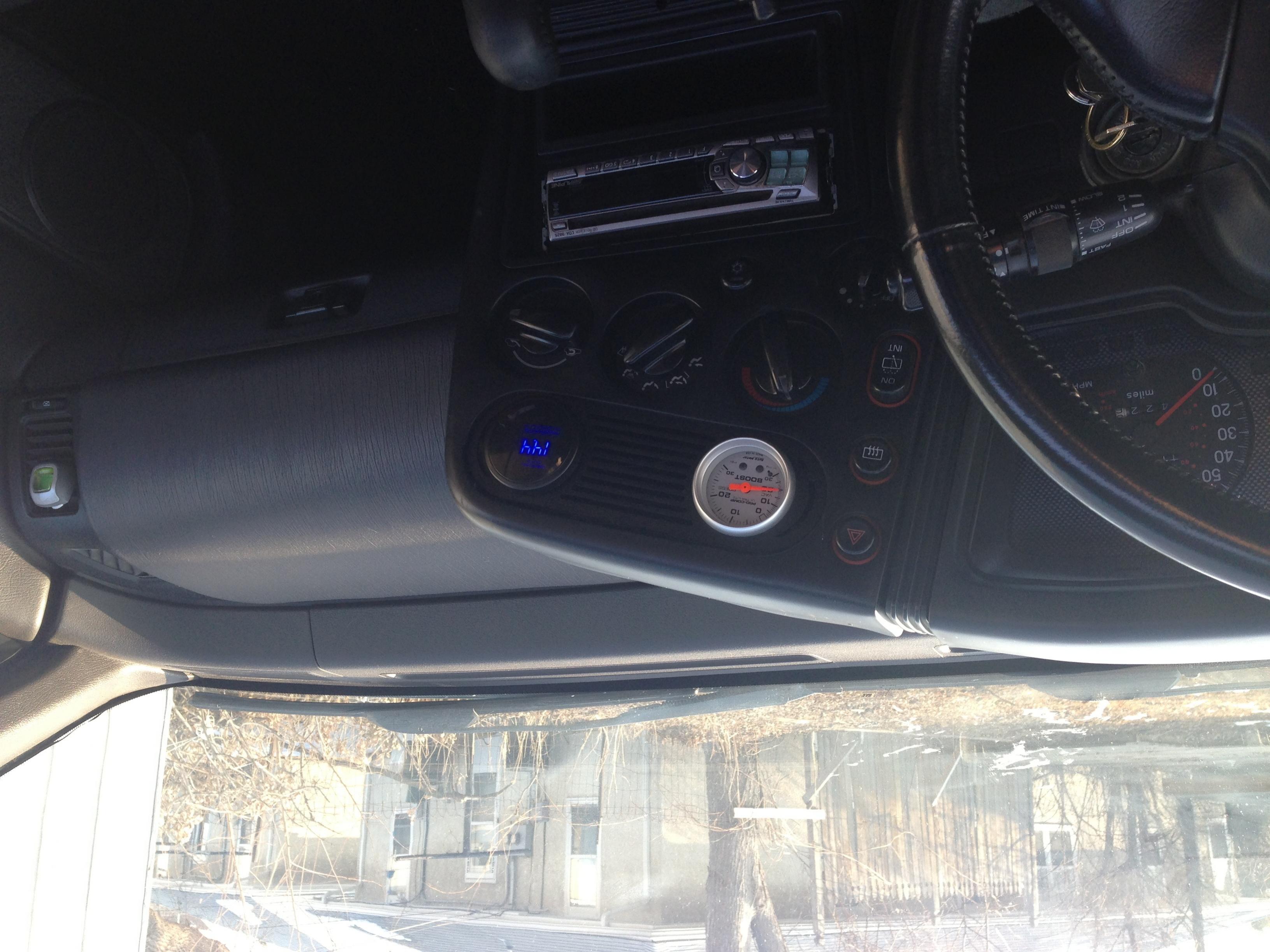

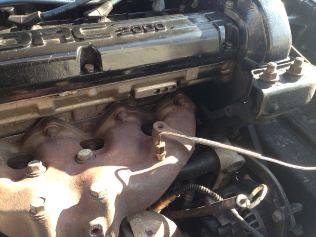

Install of the EGT gauge and sensor was a breeze thanks to a previously tapped manifold I bought from Carltalon a few months back. The fuel pressure gauge install went well too, except it reads 10psi high. I contacted prosport and ill be measuring the resistance of the sensor tomorrow to test it. I like the how the gauges are either white (daytime), or blue (nighttime). I wired them so they come on white, I hit the fog light switch to change to blue.

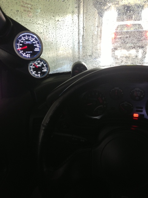

Just put in this vent pod, holds my boost and wideband gauges.
Damn phone uploading pics upside down

Also, my brand new Prosport fuel pressure gauge reads 10psi high, I tested the resistance of the sending unit and was out of spec. Prosport shipped a new sending unit today.
