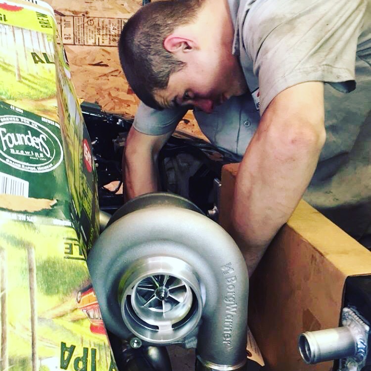

I love my 8776 SX-E! Good write up indeed.
BW8776, e-85

Mark does like his SN pale ales !
Haha great choice! What's your goals? I'm hoping I can get high 700's, and 140+ traps.

Looking for around the same, 700's with low 10s at least.
