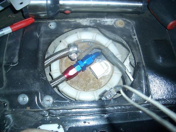

I drilled mine out where it meets the top of the sending unit then put a 90 degree barb to AN fitting there and used JB weld to hold it in place. Not very good pictures but you get the point.
