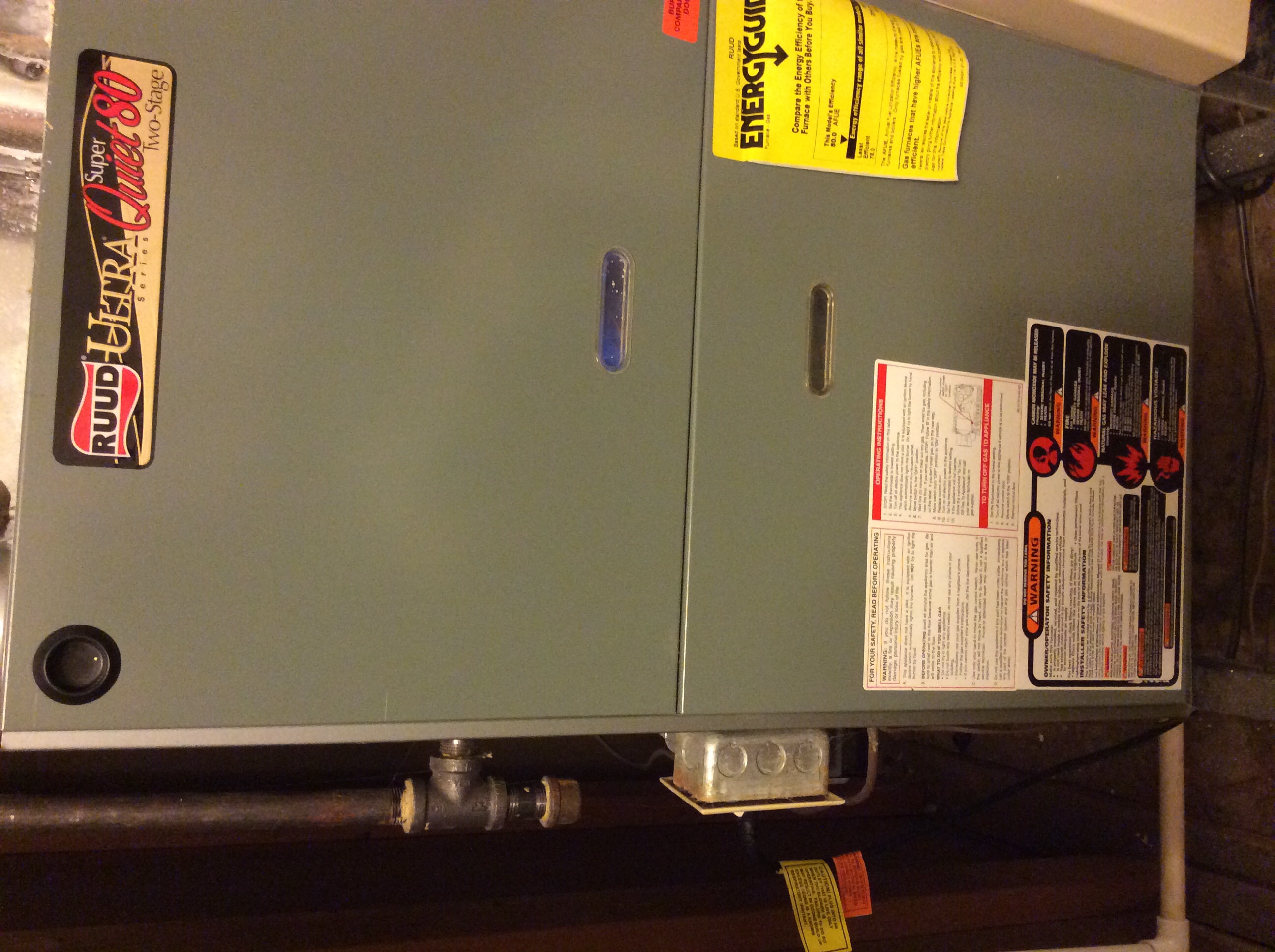

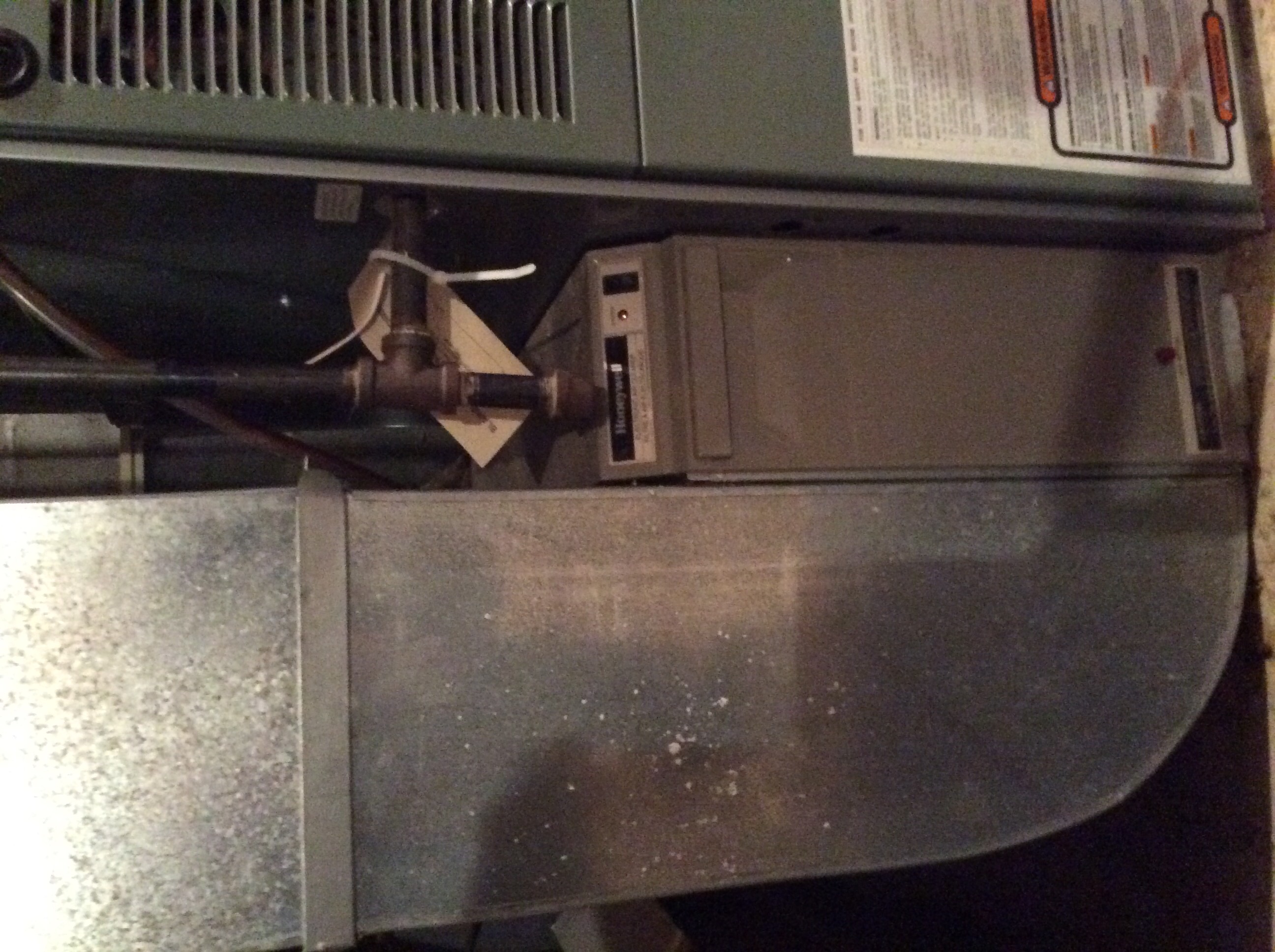

In trying to figure out where to place the heater, I have two good spots. Each would be sourcing the gas from a different ng gas line. Each would be from a similar junction (see pictures).
My question about the two junctions. They both have a cap at the same point, pointing toward the ground, near where they enter a furnace. Is this a valid point to take ng from? Just curious, as it seems like there is no reason to have those "T" junctions at those points other than maybe there is a reason for those caps at those points?

Could only attach one pic per post..

Yes, you could tap in to the gas line there. The csst was really easy.

I'd google it a bit. I know water lines have that extra length acting as an anti-hammer relief. Older houses have that hammering sound sometimes, this cured that. I'm not sure if it's the same for gas, but it's worth checking into. I T'd mine off the copper line in the ceiling above my hot water heater, and ran more copper line out to the garage.

1/4 psi won't be creating any hammering
Those points are the online spots I'd feel comfortable touching myself. Don't want to cut and T in anywhere.
