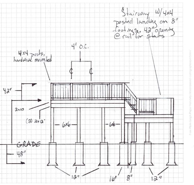

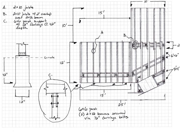

So starting april we will be breaking ground on our new deck.
Last fall i tore out the existing structure to hopefully get the footings dug and filled and inspected. But due to weather it didnt work out.
We are creating a deck that will wrap around the back of the house that will be much bigger.
Looking at a number of different woods for the decking material. Ipe vs Tigerwood vs Cumaru, The latter two being less expensive but still pretty hard on the hardness scale and will hold up for 25+ years. Tigerwood looks awesome and cumaru has more of a reddish tone to it which i like as well.
Anyways ill try to keep updating on progress of this.

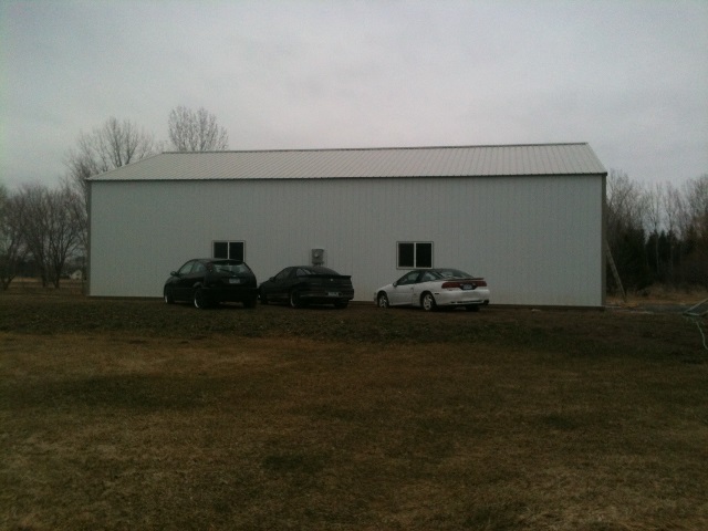

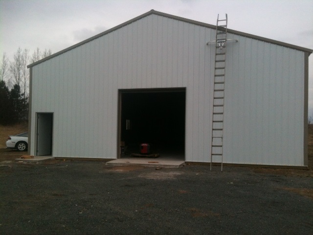

Last year I had a 40x60 pole building built to have a place to work on all my projects. I had the floor poured and then I installed the electrical panel and meter socket as well last year. Xcel energy hooked up the power in late fall and then it sat over the winter.

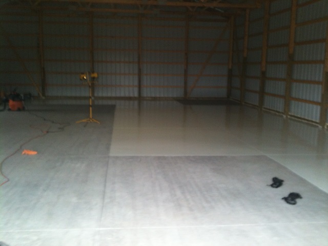

This year I've begun coating the floor with epoxy. I decided to go with white coated with clear to brighten it up and make it easy to find small parts that get dropped.
To make the coating as even as possible, I'm coating each 10x10 area that is separated by relief cuts separately. Once the white is all applied and cured the whole floor will be gone over with an abrasive pad to prep it for the clear coat.
Once the floor is finished I'll begin sealing all the leaks up in the walls and roof. I watched where the building let in snow in the winter and rain in the spring so I'll deal with those and then begin electrical and finishing and insulating the interior. My hope is to get it completed this year.

Dude, you need to spray foam that building. It will water proof it, seal all air leaks and give you good insulation. Winning all around. Big shops FTW!

I'd love to be able to foam insulate the whole thing and be done with it. I got a quote for it last year and it was something like $16k to do the whole thing. No room in the budget for that. I'm leaning towards blowing dense pack cellulose in the walls and loose fill in the attic. That'll leave room in the budget for other things. A 2 post car lift being the thing I'm most looking forward to. I'm getting too old for the jack stands to be fun anymore...

The pole shed looks great! I built a 40x80 shed with our new house in 2013, but other than adding some lights and garage door openers, I haven't done much with it. I like the epoxy coating and I'll need to insulate it eventually. Add some more pics when you are done with each phase.

I'm curious if you have any issues with leaks in yours and if any steps were taken to seal things up when yours was built. I used great stuff foam to seal up the bottom of my building where the siding ribs meet the flashing on the grade board. I've realized that there are multiple leaks that drained out that area. Now they drain out on to the floor.
I have to go through and seal all the siding joints now.

Mine has stayed pretty dry. Half of my shed is a dirt floor. We use it for dog agility. So some of the dirt is a little wet because the dirt on the outside is wet. Kind of a sponge effect. But the half of it that is concrete stays dry.
