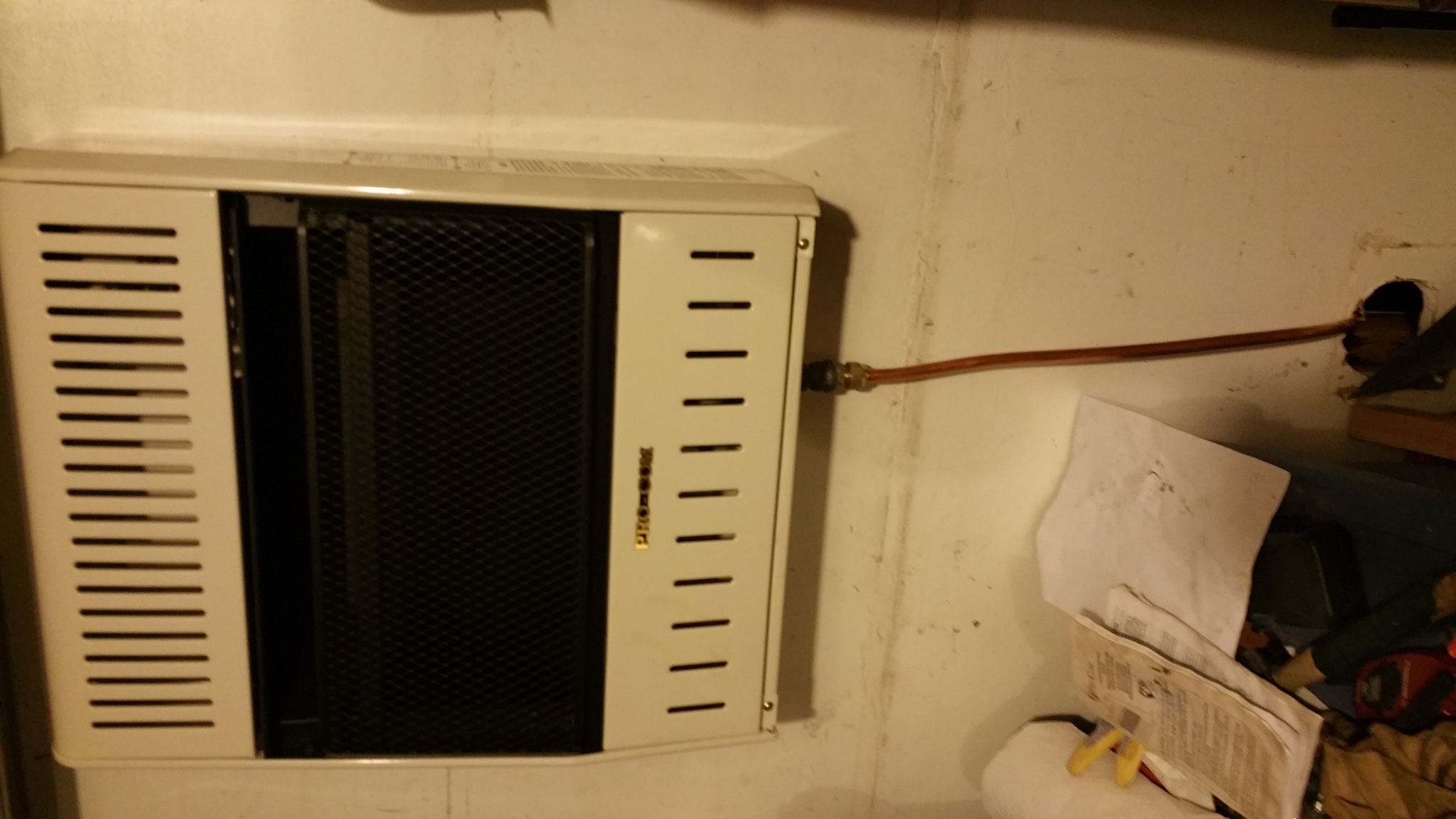

Re: Wanted, garage heat!
Well holy crap! Bman, I believe I have a guy to install one for you!
It's alive!
Kinda can't wait for cold. :P
Charged $350 including parts (shut off valve, lines etc). I already had the heater..
Oops, pic is sideways, but you get the idea..
