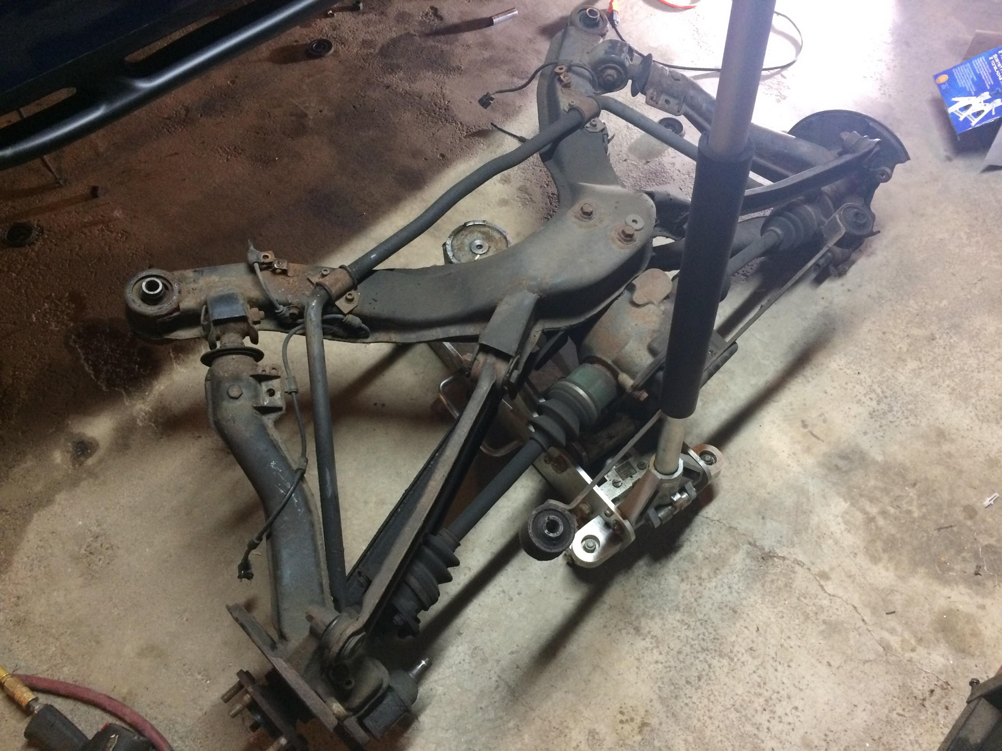

Now that summer's almost over and proving grounds is coming up, I'm finally getting to the project I was planning about five years ago, pulling the rear subframe, replacing all bushings with poly, weld in the toe eliminators, and replace both rear bearings. Welding up the clearancing I did for the 17x9's and painting everything also gets done. Can't wait to get this thing nice and tight again, should make a real difference on the road course.

Success! A little rustier than I would expect for a car that hasn't seen snow since 1994, but not bad. Time for real clean and final removal of garbage ABS stuff.
