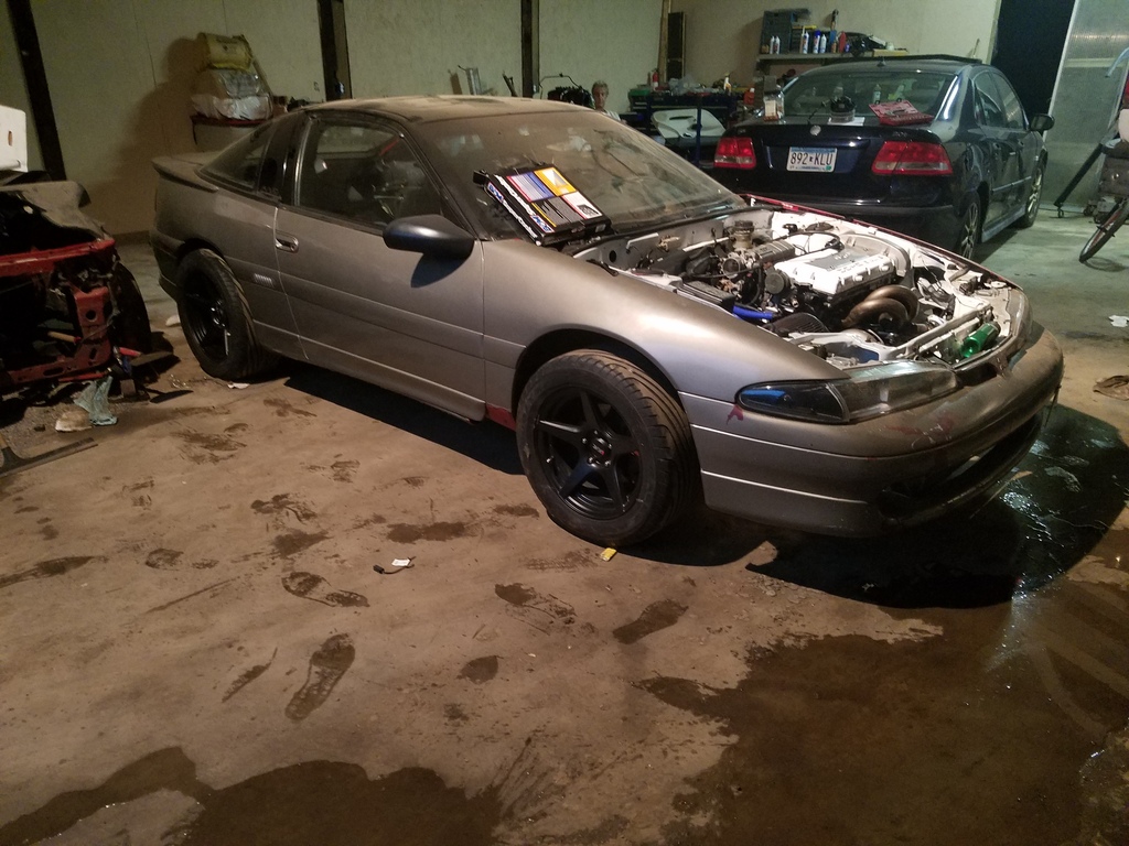

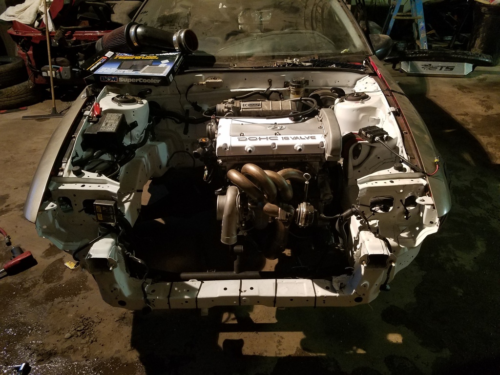

So got the valve cover I have always wanted. Also auto roll mounts seems to move the engine about 2 inches forward compared to the manual ones so the wastegate was hitting the radiator. Took care of that and having a guy building a tubular core support.
