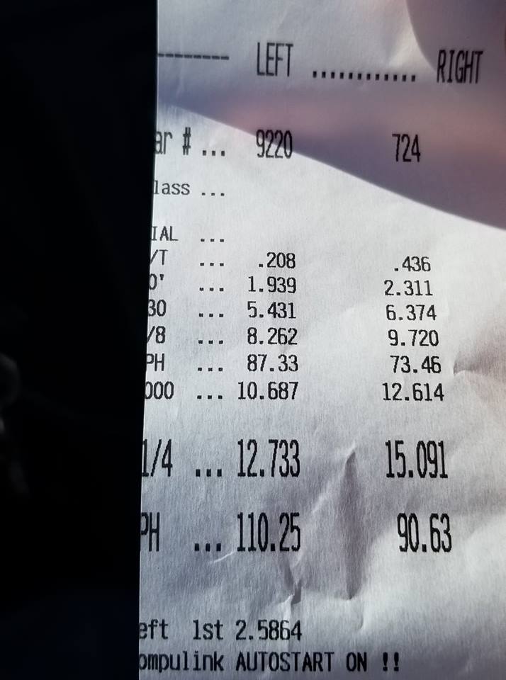

Went back to the track this weekend. Terrible weather for drag racing, but still productive.
Density Altitude was 3056.9
82.9 Degree air temp
13.8 mph cross wind
49.4% humidity
62 degree dew point.
Everyone I talked too was down 2-3mph from normal. Still set a personal best, but more to go on it.
1.939 60'
5.431 330'
8.262 1/8
87.33 1/8 mph
10.687 1000'
12.733 1/4
110.25 1/4 mph
Not setting the world on fire, but making progress. I'll upload a video with a graph later. Next step is renting the dyno for a few hours to validate the tune and then getting some drag radials on this beast. I think I can still get this car down to low 12's with tires and tuning.
Next run I got eliminated. Improved the 60' to 1.931 and ran a 12.831 @ 109.91mph. The rest of the day I ran 12.99 two times and 13.2 two times. It is all in the launch with these cars. I did break a 2.0 60' 3 times. (1.995, 1.939, 1.931).
Next time I get to go will be late October. Hoping for cooler weather and stickier tires for a final hurrah of 2017.

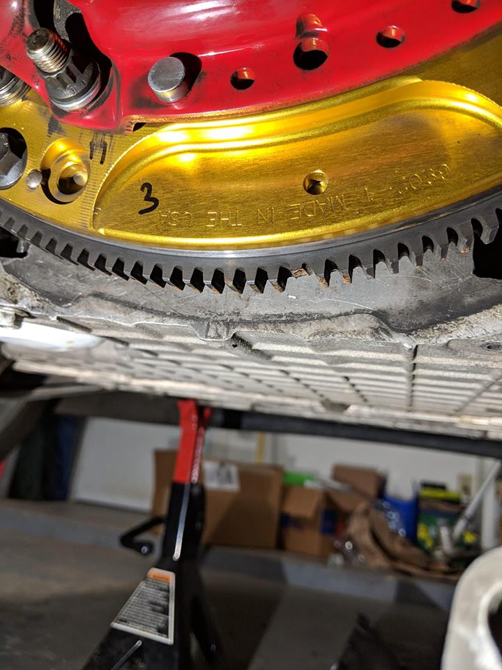

I've hit a snag.
Went to replace the starter (and shim it properly as I kept thinking something was wrong besides heat).
Found the attached image.
So that's neat. I figured when the injector stuck open (old 36lb gtp injector) and hydrolocked the motor, the kick back destroyed the tooth.
Thankfully McLeod can rebuild the flywheel for cheap ($50). Of course to do this I get to pull all of the stock drivetrain out.
So now the next phase begins, planning the future of the build, as putting the inferior parts back in a 2nd time pains my heart knowing I can't launch on it.
I briefly thought about selling the car after fixing this last issue and starting with a different platform, but I really like this car.
So I think I'll be tossing in all C6Z stuff (Differential, transmission) and a upgraded 2001-14 corvette 12mm torque tube.
This combo *should* be good to around 600-650hp/tq or so, more importantly allow me to try to get those low 60's. In asking around most guys are capable of cutting 1.5's no sweat, 1.4's with practice without breaking.
Yes I do plan on spraying nitrous to get to the limit of the drivetrain, why wouldn't I?
