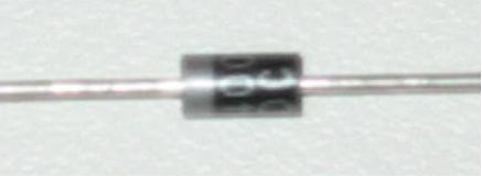

You need 2 1N4001.They're very common and should be easy to find.There's a silver band on one end.Connect the 2 banded ends to the clutch switch, the other ends go 1 to the ECU and 1 to the starter circuit
