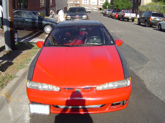

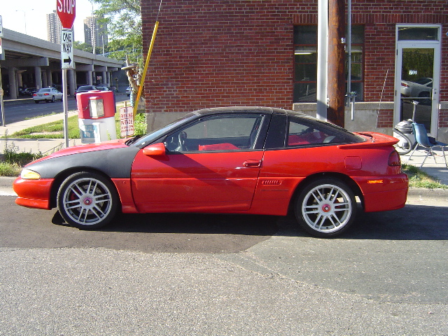

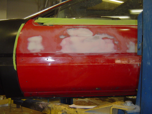

day 1 jul-19
took the rest of the car apart bumpers,skirts,door caps,ect
found the quarters are rusted out will be fixed
started to fix all dents on left side of car
pics of before taking it apart

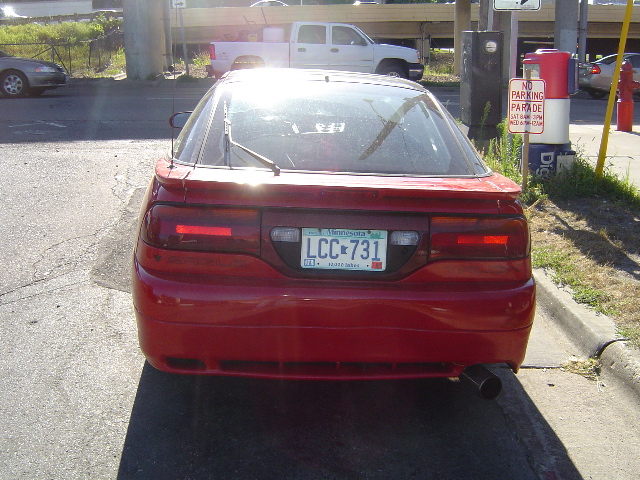

jul-19

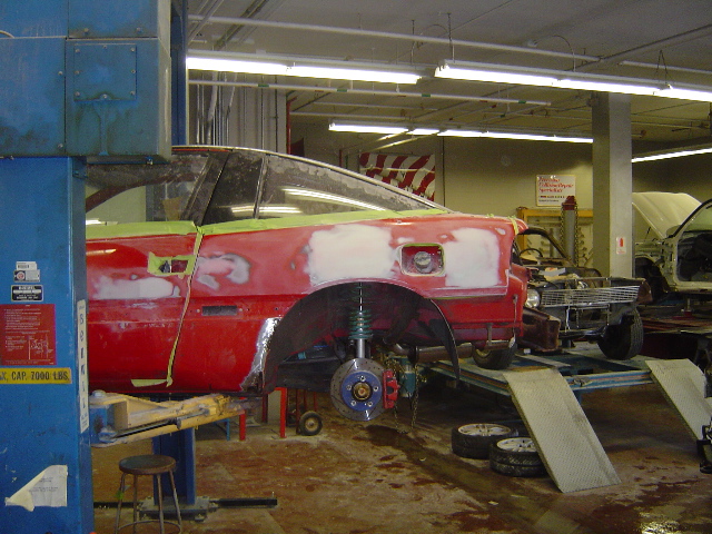

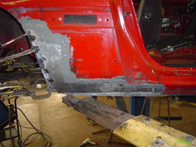

Re: painting my 92 talon at school (dunwoody)

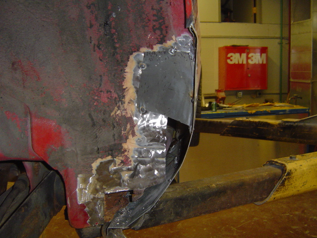

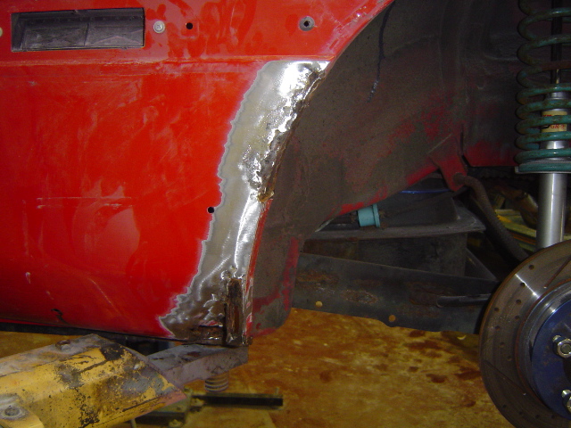

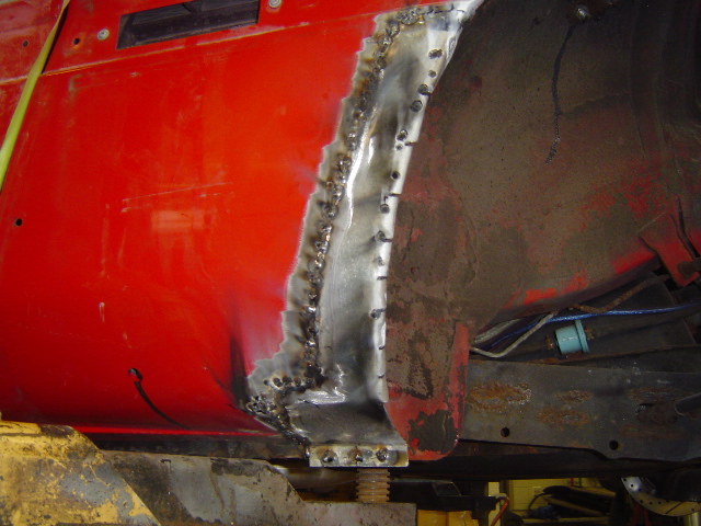

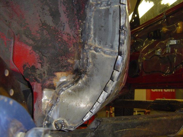

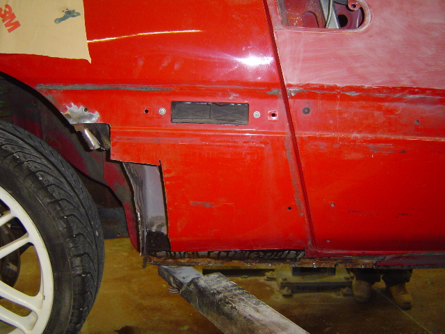

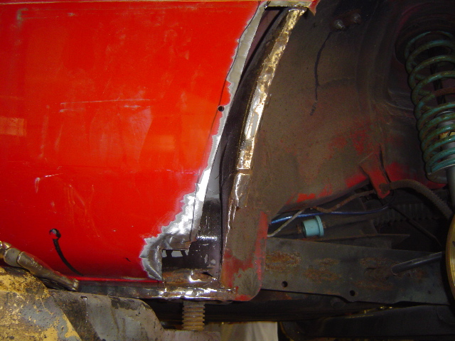

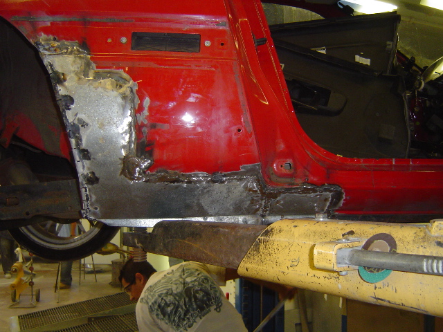

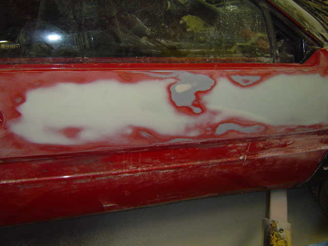

day 2 jul-20

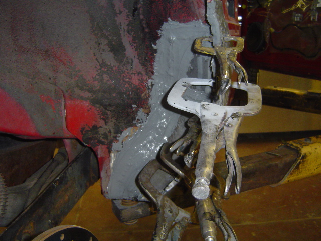

finnished left side of car
cut out right side rust and made panel and weled it in
started on left side rust

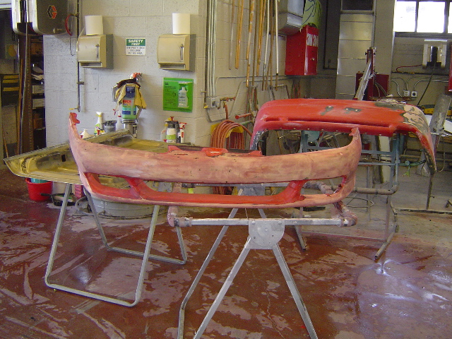

here is toadys pics jul-21
right patch is totaly done
rear and front are almost ready for surfacer

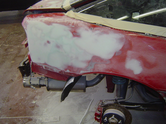

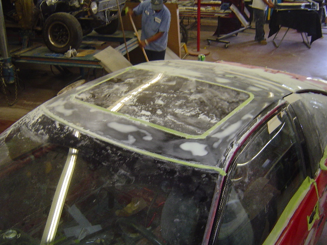

Old 07-22-2005   #10

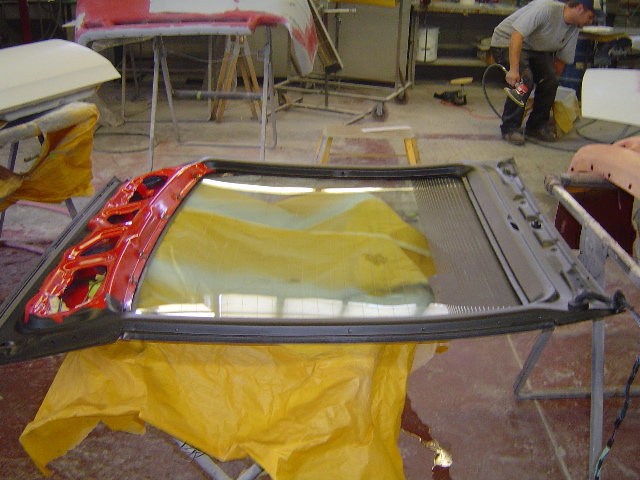

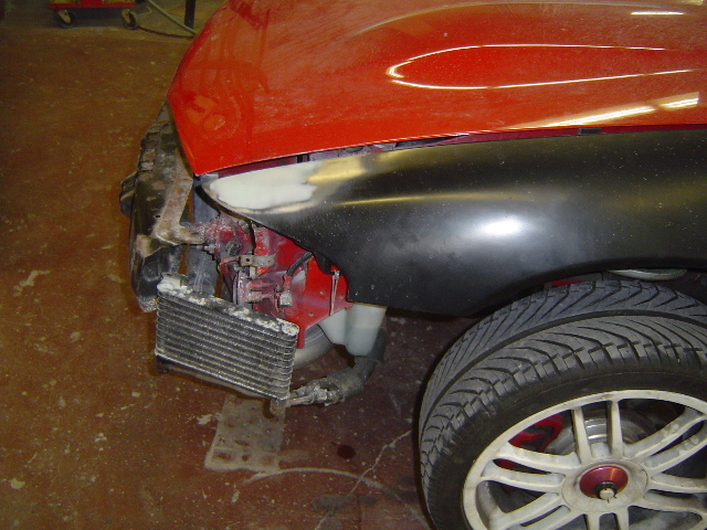

july-22

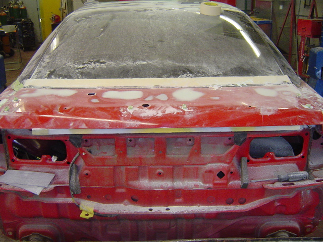

got the left cut out and patch welded in. seam sealed both sides. glazed the hatch and ther roof (had hail dents) fixed the high spot new the new left fender. surfaced the rear bumper

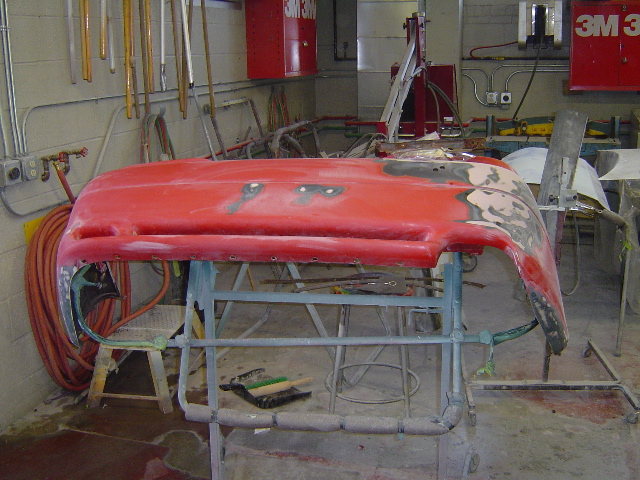

july-25
finnished the right side of the car
working on the front bumper

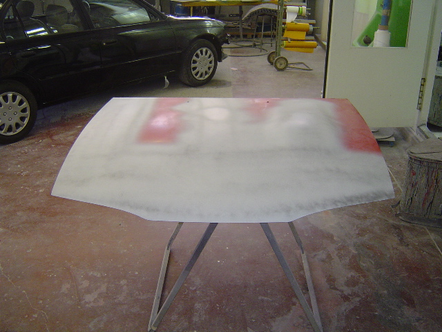

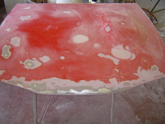

the hood I picked up
fixed all the dents and rock chips

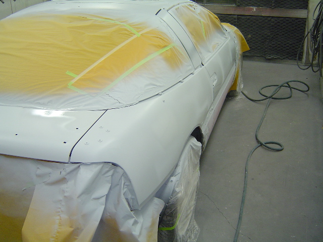

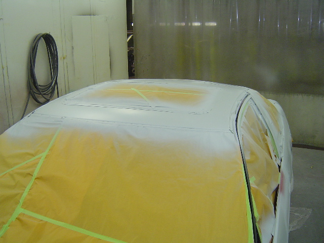

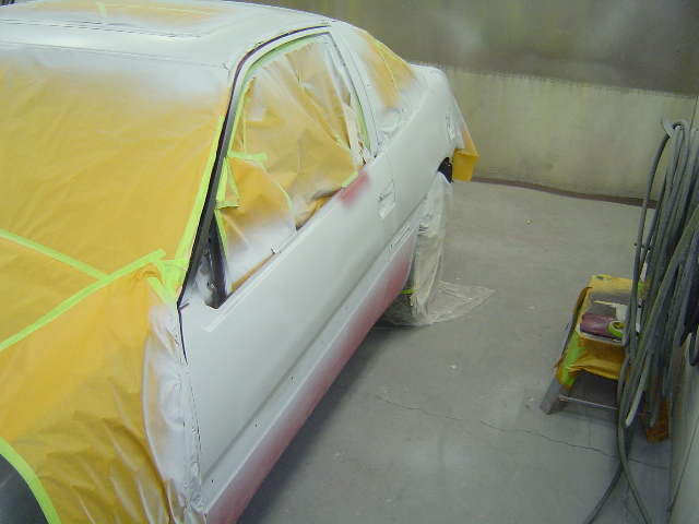

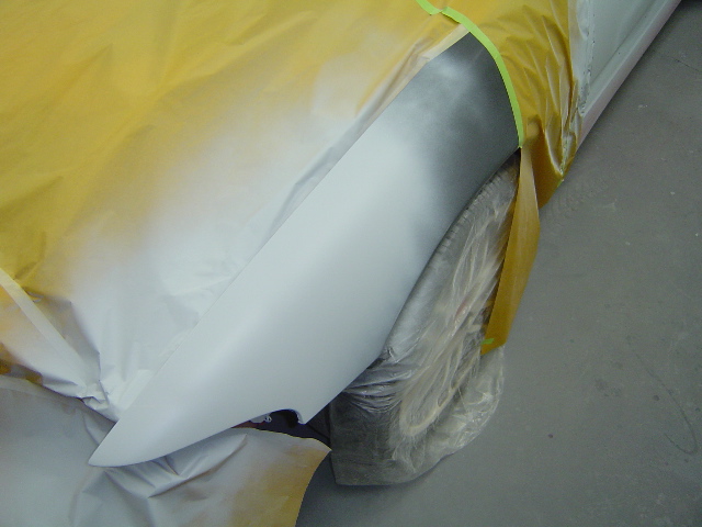

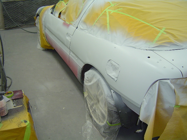

july-26
got the car in surfacer

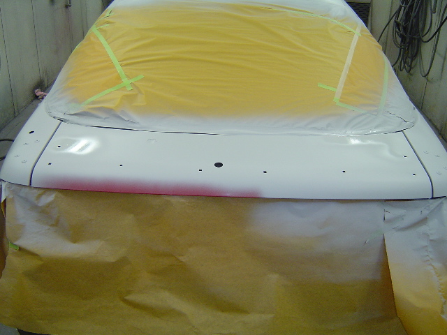

Old 07-28-2005   #19

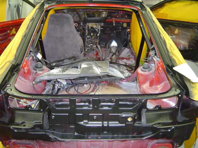

july-27

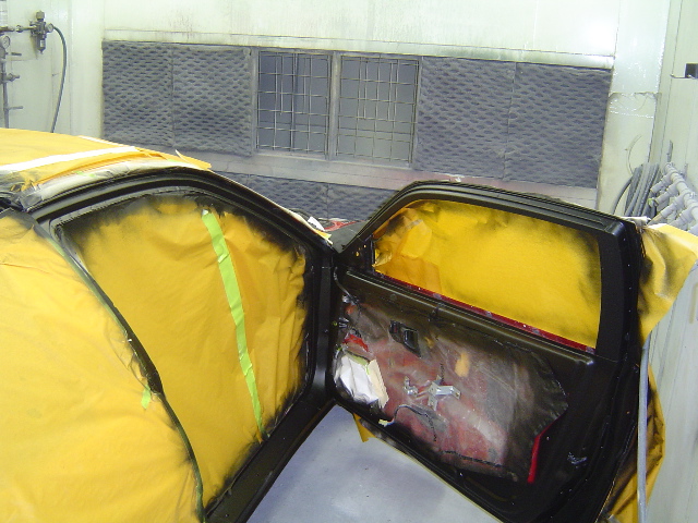

sanded all the surfacer
jamed the doors,hatch in flatblack
