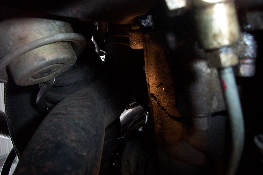

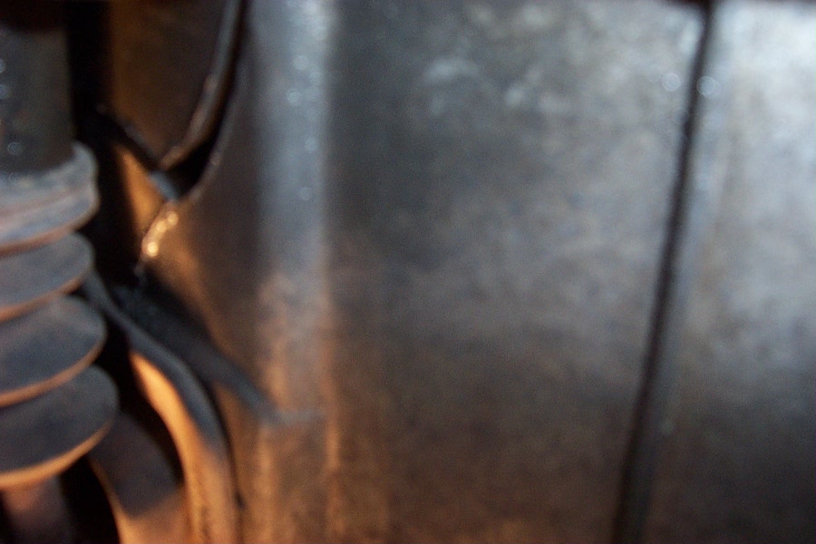

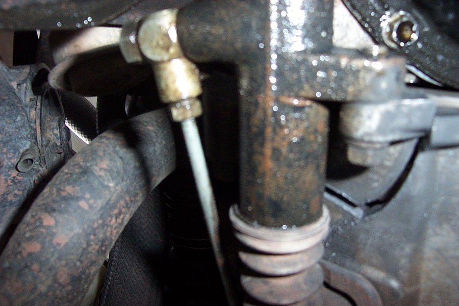

Well over the last two days my clutch didn't feel right. I would scratch or grind into gears from time to time. On my way home tonight I lost my clutch pedal all together.
Here's why! I know there is a recall on the transfer case...any chance this is something also? PLEASE!
The second picture shows the split going all the way up and around to the top of the bellhousing!

Time to find a new transmission housing or get that one welded back up.

I will try to find another tranny. Welding it would always have me fearing it happening again or the crack not stopping at the weld and continuing on.

You can have that one welded. Next time put the dowel pins in your tranny!! Doh!!

The previous owner put the ACT 2100 in it. I am curious now to know if no dowels was the issue. Another friend of mine said the same thing! I am going to laugh at him (previous owner) if this is true...I will laugh when I knock him in the choppers for being an idiot!
