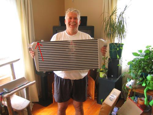

Here is where it's leaking. Right on the inside, up against the end tank, in that very last row of fins, I feel a crap ton of air.
