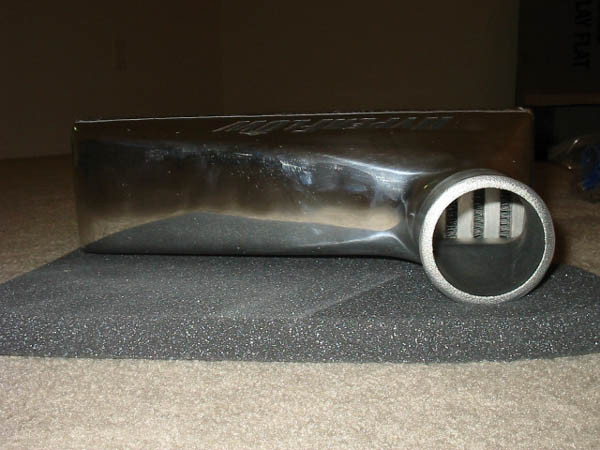

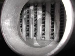

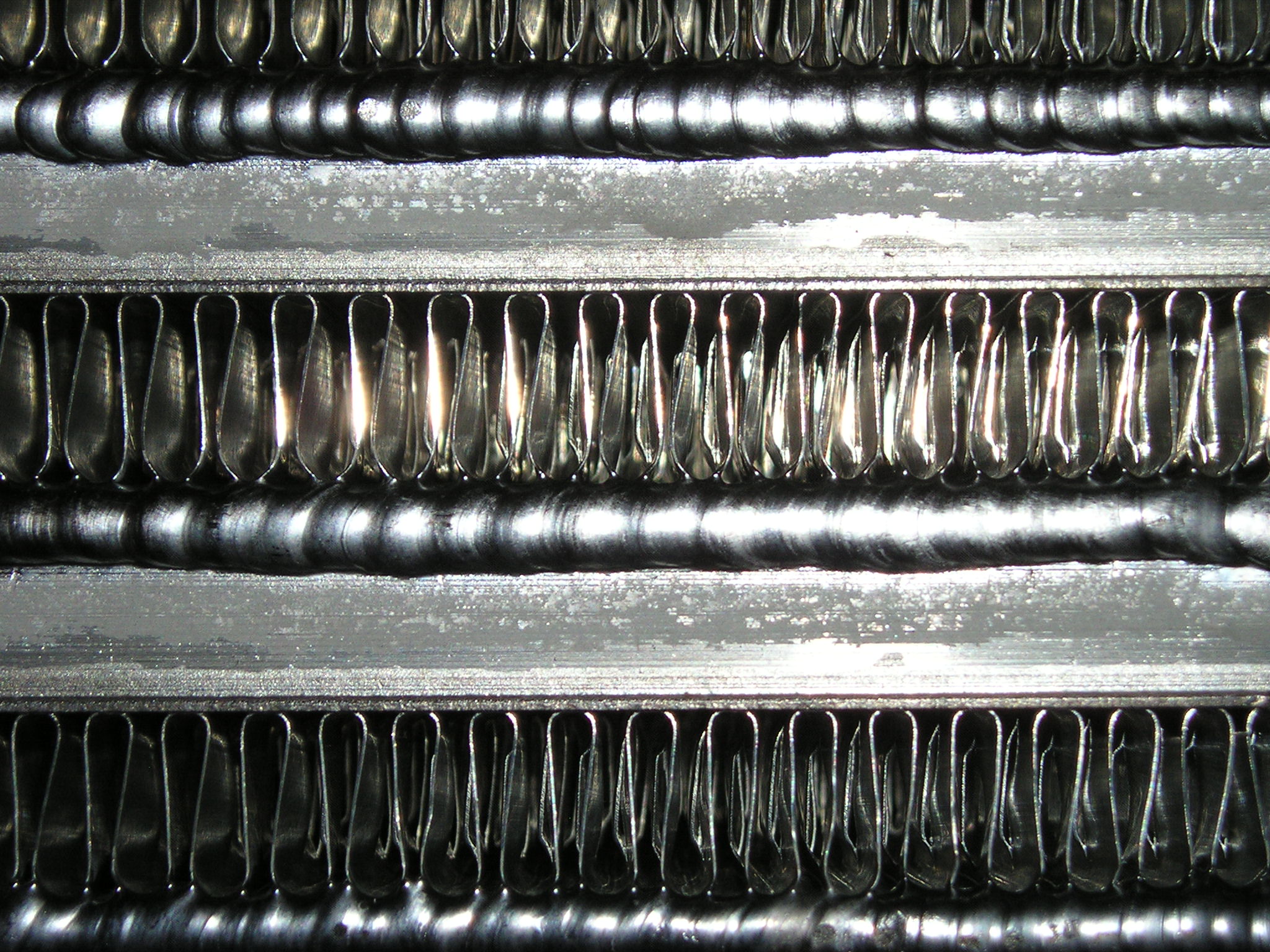

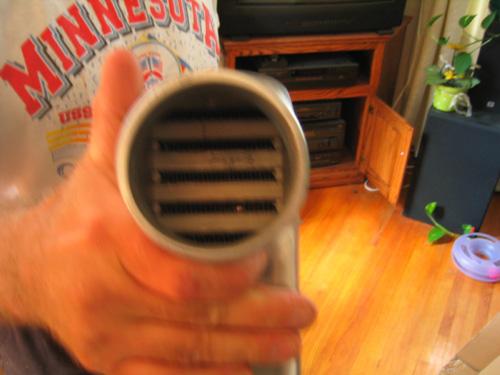

I don't agree with grouping all intercoolers boughten on ebay into one category. Some will suck, some won't. Maybe when I get home, I'll post up the pictures of the inside of my core, so all those who keep chirping "EBAY INTERCOOLERS SUCK, THEY HAVE NO TURBULATORS" will finally shut up. Just like anything on ebay, somethings are crap quality, and some are good. You just have to look at what you're buying, and figure out which of the 2 it is, good or crap.
I personally run an ebay core, and made my own piping in case you haven't figured that out already. Bar & Plate, tons of turbulators (offset, not perfectly allignt turbulators like some of the crap ones have), 24x12x3 with 3" inlet/outlets. I have 2 buddies running the same core on their evo's.

And for them being good only up to a point, does a Garrett stamp make them instantly better or something, and more capable? Tell me what makes a Garrett core better and more capable then the one I have on my car? You guys were quick to jump and say my core was heatsoaked the day on the dyno when it started to sputter slightly at 7k+ RPM's, and I'd bet my arse that it's because you know it was from ebay. And when I went and put my hand on the freezing cold end tank and UIC pipe, I questioned it instantly, and we found the problem ended up being solved with a new set of spark plugs.
You're going to do a back to back test. Great, with what, one style of ebay intercooler? That tiny one you still have laying around that's a tube and fin? And then state that all ebay cores are as equal and crappy as your tiny tube and fin JRC core because you compare it to a larger bar and plate Spearco one? You group everything sold on ebay into one group, and that's crap. I swear I could buy a used FP turbo off ebay, and if i installed it and said nothing as to what kind of turbo it was but only that I bought it off ebay, some of you would say it looks like absolute crap and point out apparent flaws, just because I mention Ebay.

Nice cast tanks, what name is that stamped on the side?
Old 02-15-2007   #16
Re: Intercooler questions?

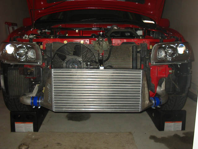

Hyperflow.
Here it is on one of my friends car. Yup, just another POS crap intercooler because of where it was purchased. Don't mind the fact that he's making mid 300's HP on the stock turbo, or wait... That must be impossible, because with it being purchased from ebay, and the lack of garrett stamp, this thing shouldn't be good past 250.
