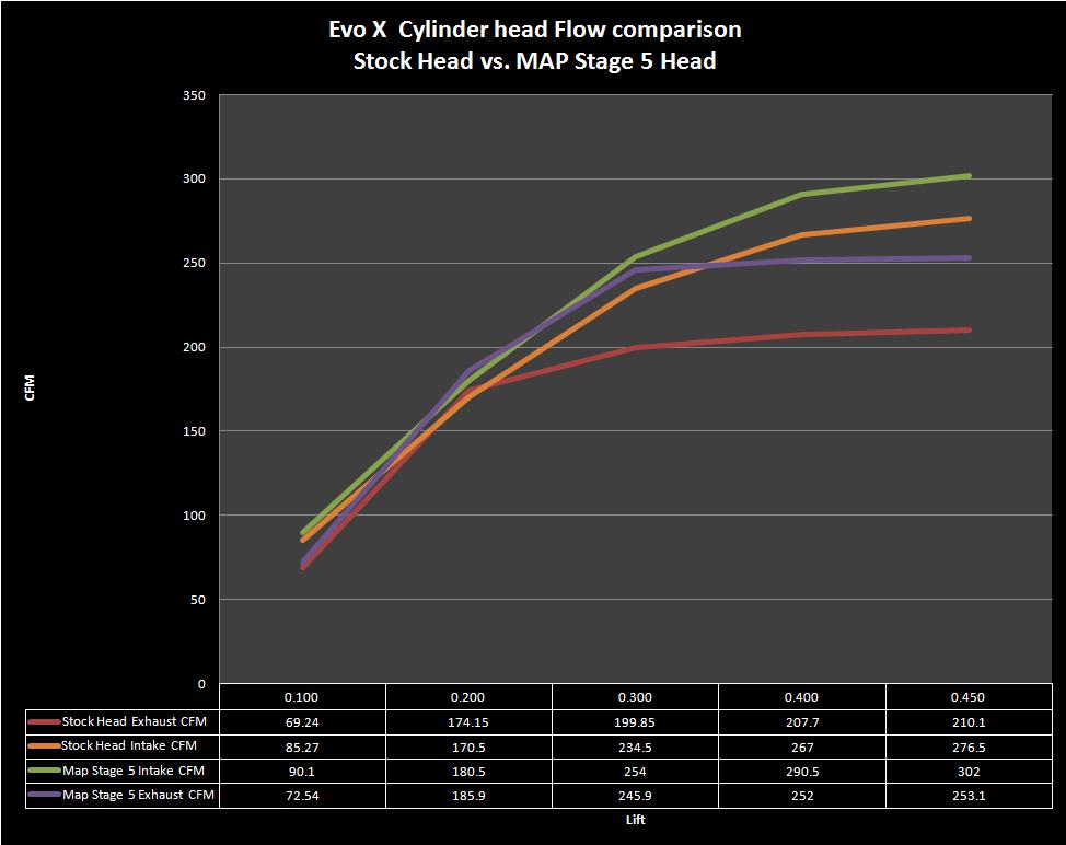

to put it in perspective.....

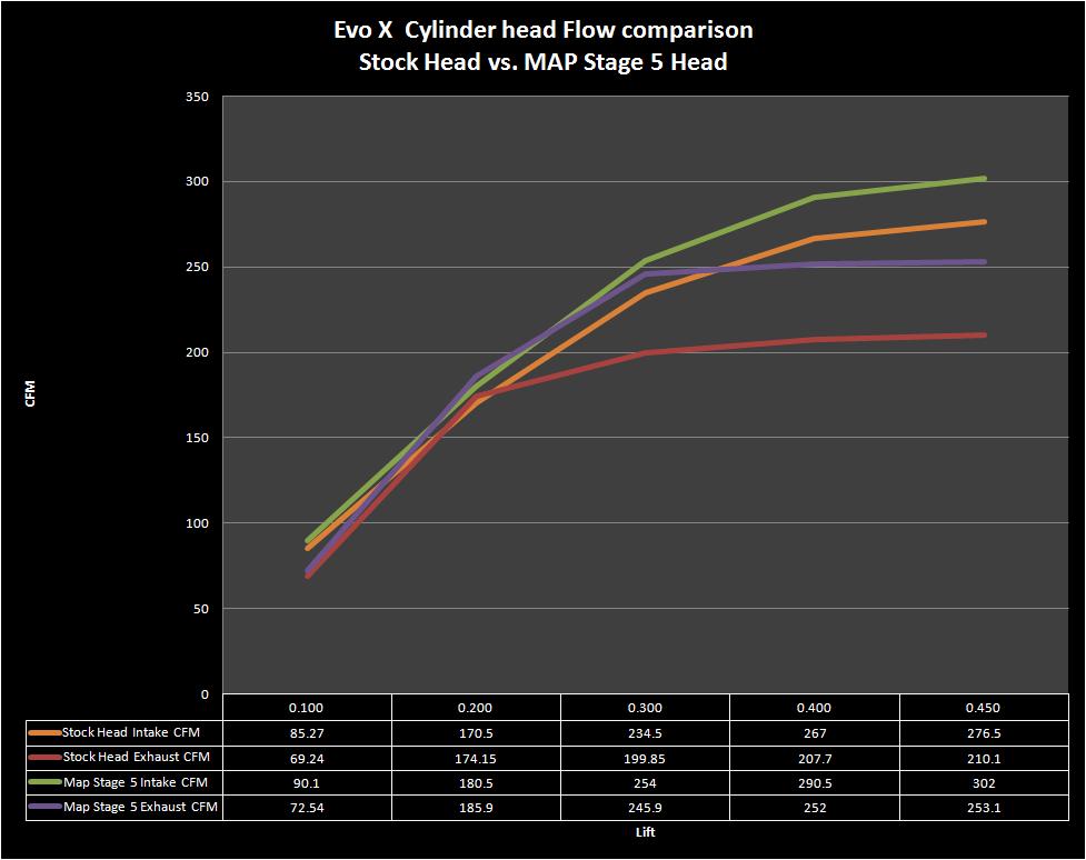

Quick formatting error on my part, I should have staged the table out below intake/exhaust/intake/exhaust, I can re-upload if Chris wants to use the table for anything.

Sure I could put it on the site, thanks!

Re: MAP's 2008 Evolution X GSR Build Thread aka Project GGX
Done, and you've got a pm.
