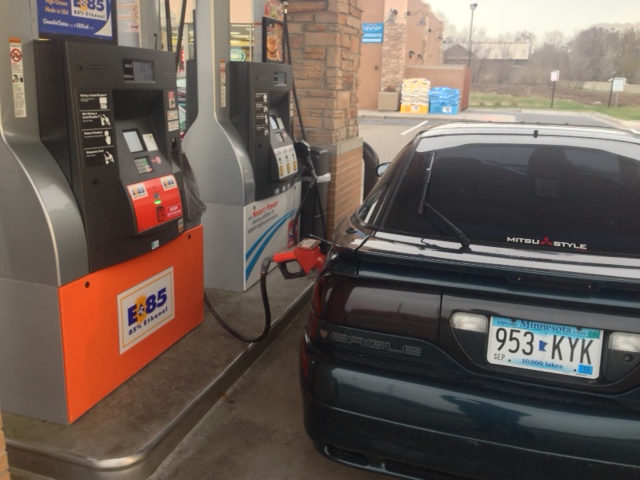

Getting tuned on the 15th. Switching to E85 so next time I need to, I'll fill it with "E85".
Link wise, what do I do to drive away from the e85 pump?
All I need to do is adjust for aprox 33% more fuel keeping fuel trims in check correct? What a/f ratios should I be looking for?

Yea, add 35% fuel, AFR should remain the same on the gas scale, so 14.7:1 cruise and 11.5:1 WOT for starters.
I would get the STFT and LTFT as close to 0 as possible before your tune.
Ok cool thanks. Filled with ethanol today. Got it all sorted out. I didnt have to add that much yet since i'm running a mixture with gas still.

Do it!! The only regret you'll have is wishing you'd have done it sooner
You were right! I seriously feel stupid for not switching a long time ago.

Pretty tough to blow it up unless you are doing pulls. And who does that? Seems like you are asking for trouble.
I forgot to mention (and I hope you realized this already), but you don't add 35% in DSMlink to the global fuel compensation. You basically scale the injector down 35% and then input that setting for the injector. So for 1650cc you would have -72%, but on E85 they act like 1220cc which would be -63%. Hope that makes sense. Just watch your short and long term fuel trims and make them zero, that's all that matters.

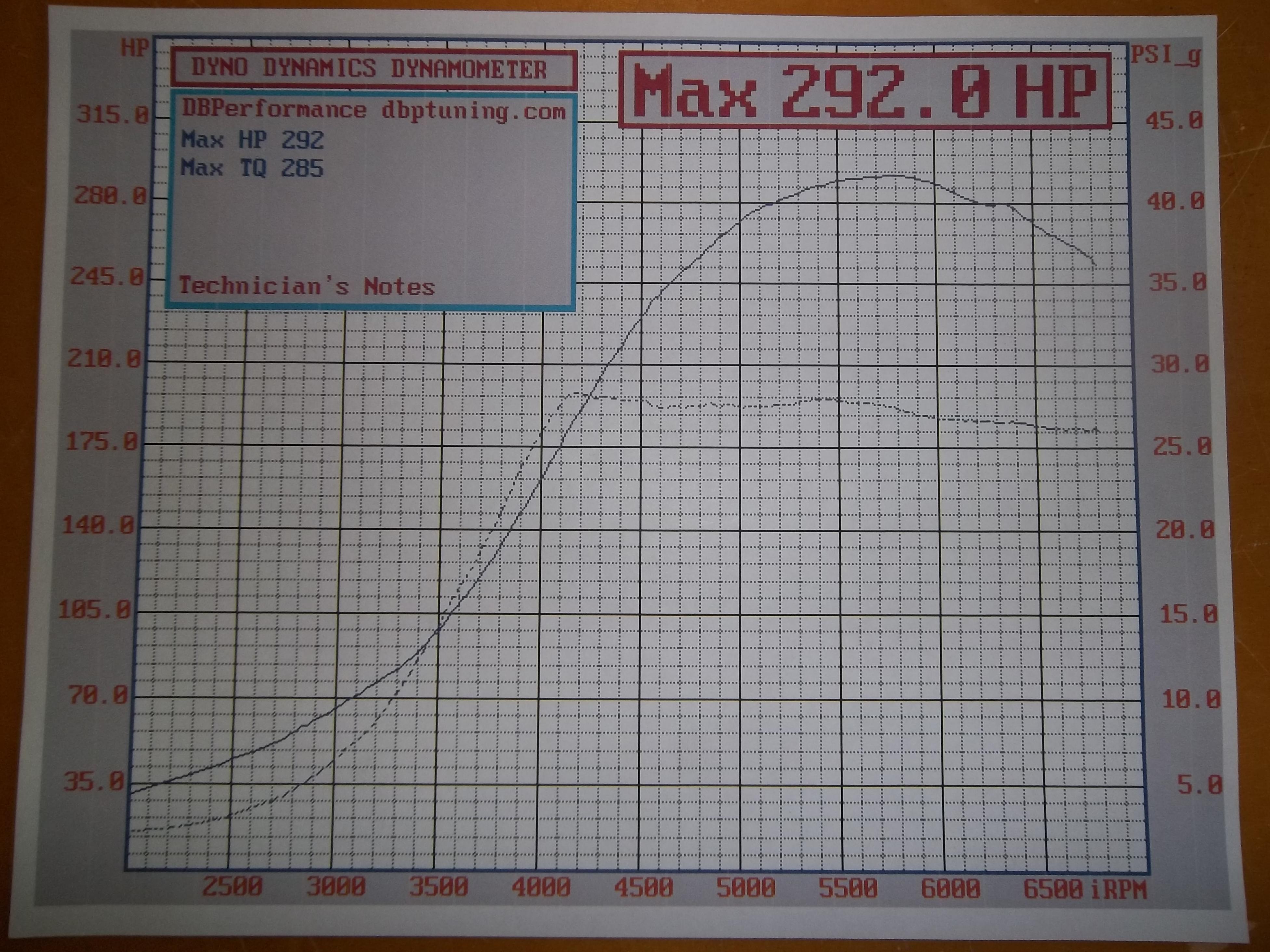

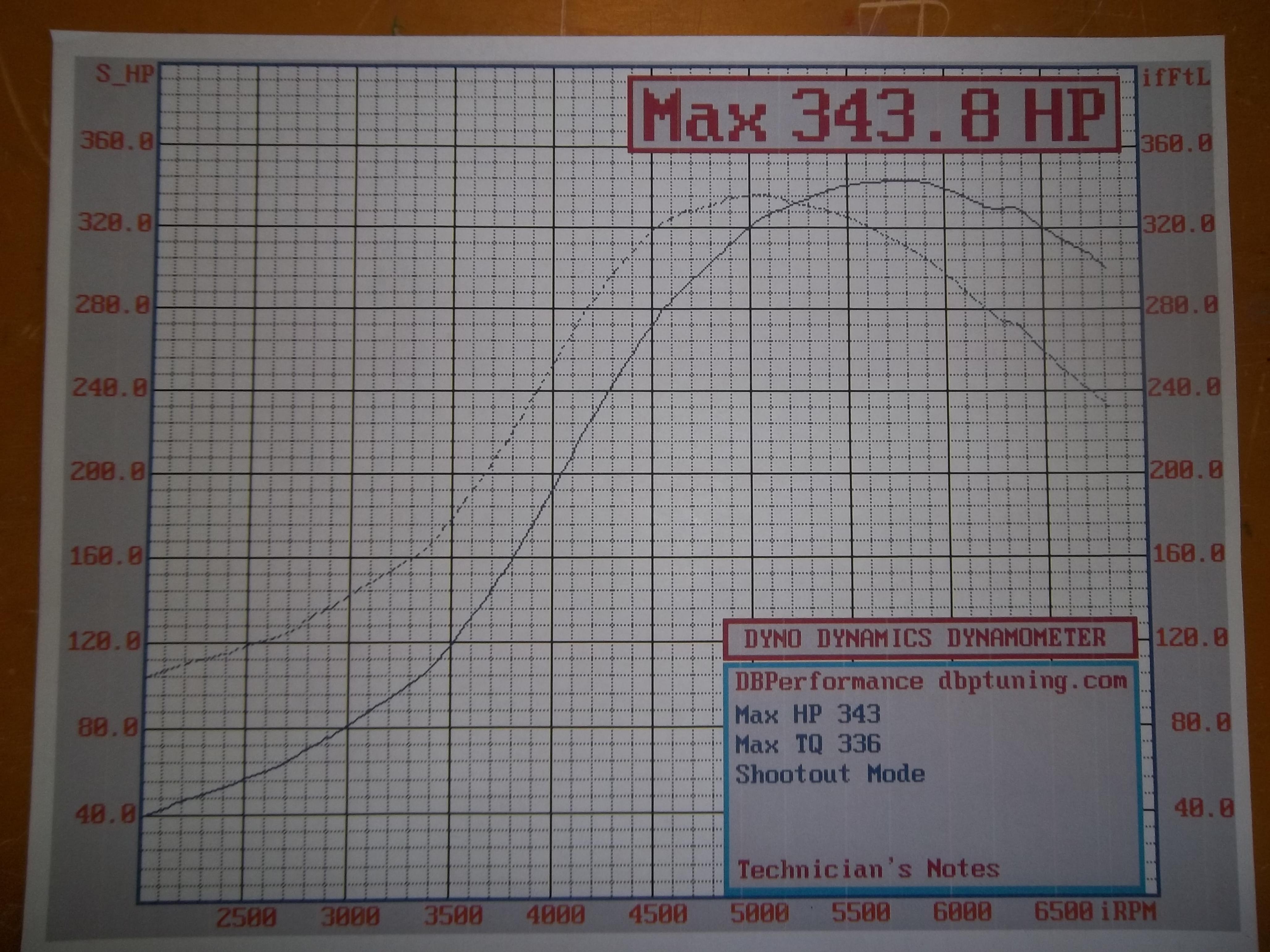

Well, 292hp/285tq, Shootout mode was 343hp/336tq.
Im happy, but did not hit the numbers I was hoping for.

Re: 1g 6 bolt 4g63 tsi build

Looks like it needs some cams and more boost! How does it feel on the road compared to before?
It is a lot smoother, better drivability. Spool up seems smooth and solid. He did a pull before any tuning, it hit 248 at around 24 psi I think. Seemed to lose power anything more than the 27psi it's set at now. Maybe Shane will chime in with more info.
So I was expecting more power from this ef1. Suggestions?
How much gain could I expect from different cams?
How much power could my 255 and 1250cc injectors support?
My only boost leak is very minimal at the throttle body shaft seal. Going to be addressed very soon.
Aaron, Carl and Nick all ran low 11s at 120mph. What cams, injectors, boost were you guys running?
I would say the turbo is easily capable of 350-360 with good cams and an intake manifold. Your fuel system should support low to mid 400s.
