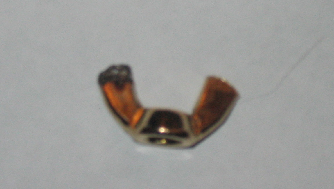

i found the problem, the new wing nut was hitting the hood when i was going over bumps. I replaced it with a regular nut so it can't touch now. here is a pic attached (sorry that its a bad pic) Thank you for all your help.
