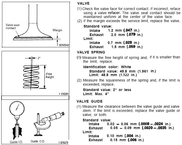

Here's the valve info.

wow thats awsome thanks alot!! where did you get that from?
Old 02-04-2004   #5
DSM manuals on cd.
