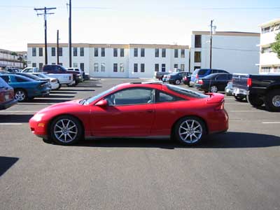

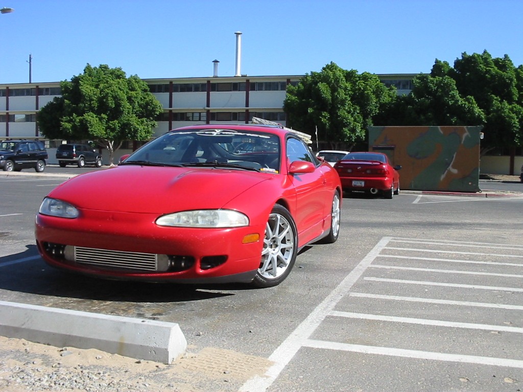

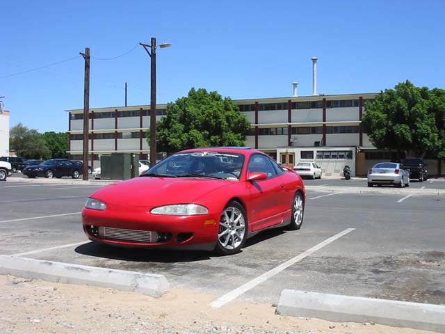

This may help you visually. This was my GS-T dropped 2" with Tanabe springs. Those were the best pictures I had that showed the drop. That was on 17's and 225/45's I believe. It was a long time ago.

ya thats about the look im going for! no it's not for show! im in the prosess of making a street/drag car nothing crazy!there is no interior AKA guted to shit lol! but i want it to look good on the out side and i want it to handel pritty good not like auto-X good! but able to handel some corners when i feel like going a little crazy!
hey thanks for the visual really helped! i guess with stock rims my old car didnt look like it was droped really, but i think with coilovers i will get the look and preformance im looking for
