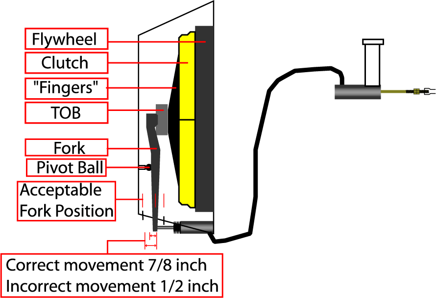

So, when all else fails, (AFTER YOU HAVE EXTENDED THE LITTLE BRACKET TO THE END OF THE MASTER CYLINDER ROD) take a M 8x1.25 nut and a M 8x1.25 bolt and weld them together. The end product is an Extended clutch MASTER CYLINDER ROD. NOT TO BE CONFUSED WITH A "EXTENDED CLUTCH SLAVE ROD" which is a BANDAID FIX and is ULTIMATELY UNACCEPTABLE.
Explanation: By buying the extended rod, you are not changing how much movement actually happens, the slave cylinder is still moving a small amount, example: your slave is moving from Point A to point B. You need to get to D, so you add the extended clutch slave rod and now you are taking that same movement and going from C to D, when you really need to be moving from A to D. Adding a master cylinder extension rod will allow the pedal assembly (even a worn assy) to properly manipulate the master cylinder, and thus move a larger volume of clutch fluid through the system.

9. Visually inspect the clutch fork, from your point of view it should be off to the right (Drivers side)(block side). I do not know exactly how far it needs to be, 60/40 should be safe, maybe even 70/30 (you need to take the transmission back off and add washers if you are at 50/50 or less)
10. Bolt up the Slave cylinder
11. Remove the restricter inside the Slave cylinder (makes aftermarket clutches feel feather light!!

Don't forget to shim that clutch fork, works wonders.

Step 9 says "add washers", I guess I could be a little more clear.
I followed the instructions there, I shimmed it perfectly, still the same problem, thats why I was tearing my hair out handfuls at a time.
again, stated in the first couple sentences, the extended master cylinder rod is what did it.
