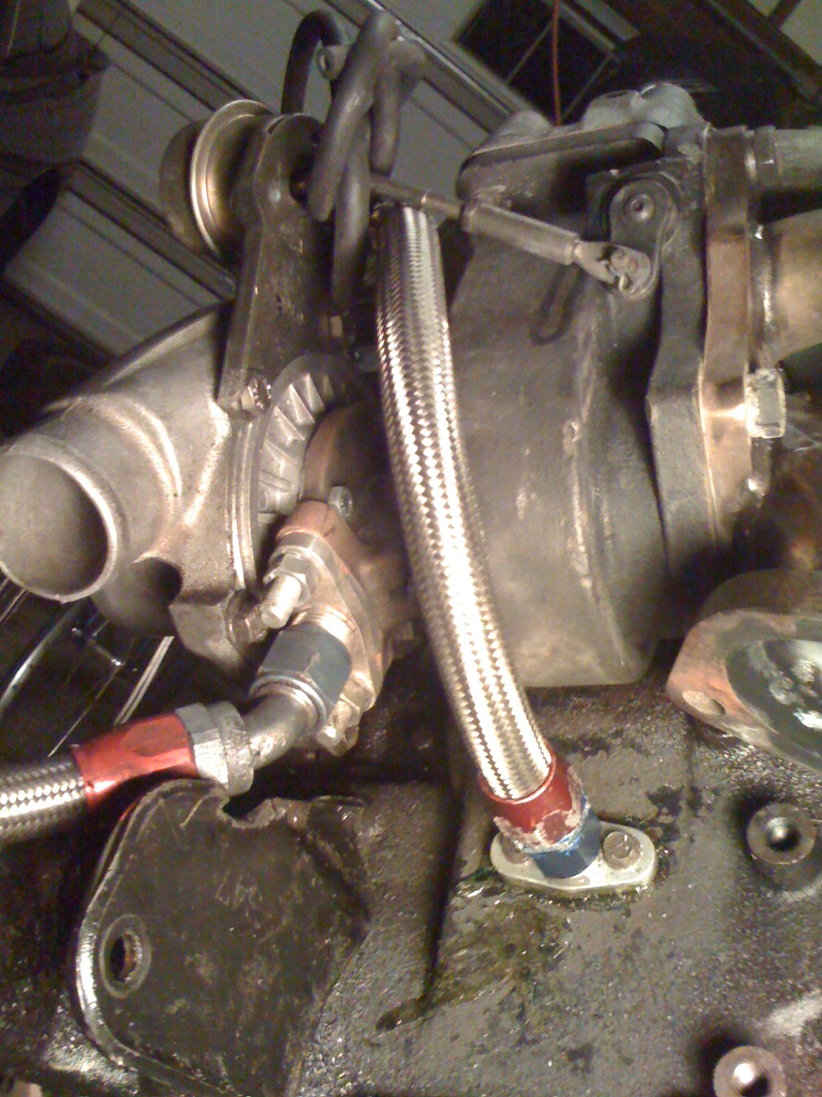

in my never-ending quest to vent crank case gasses, this is what I have done: Drilled a hole in the side of the block, and attached a -10 AN line to the side of the block, this will go to a huge catch-can. Results after the first drive.

I'm really leaning twards terrible idea.. only because I would never drill into the block, I would think that it would make it weaker and give way under pressure

Well it looks like its already leaking. and wouldnt this spit a lot of oil into the catchcan. Man how pissed are you going to be if that messes up your block

the hole i drilled was in the balance shaft chamber, it was very thin, only about 3mm thick. the drips are weatherstripping adheasive.
On my buddy's turbo ford, there is a hole drilled in the aux shaft chamber similiar to where i drilled it on the 4g63. The turbo ford motor guy never has had a valve cover leak, and wonders why 4g63's dont have a crank case vent, only the head pressure relief vents.

What symptoms are you seeing that are making you do all of this?
Our crankcase vents out the valve cover ports. If you have quite a bit of excess pressure, why not just add a second fitting to the valve cover like has been done time and time again? Or like has been mentioned, just hook up an actual vacuum pump.

If you have good compression, why would you waste your time with this? There's a good chance your block will just crack around it, and in the end it really accomplishes nothing.

the engine was rebuilt, and then was used in my brother's laser which put down an estimated 350 whp (not bragging, just it was pushing some serious HP)
he was constantly plagued by oil leaking over everything, we tried every trick in the book to stop the oil seeping out of the top end, to no avail.
My brother decided to quit while he was ahead, parted his car, and bought a 2g. I grabbed his motor.
So, all I am doing is applying a feature common on other turbocharded cars.
I drilled the hold in a non-structeral location on the side of the block, I didnt drill through any major "webbing" in the casting.

we put 2G pistons in it, i think our compression tester is reading a little high honestly, but its pretty even across +-5 on the gauge.
Oh, and one more thing, before I did this, I asked John Gosh about drilling a hole in the block, i pointed to where I was going to drill it, and he thought it was a great idea.
Basically if John Gosh not only agrees with me, but calls it a good idea, im not really worried.
what I am worried about is still leaking oil after all of this. then I will have wasted my time with this mod.
