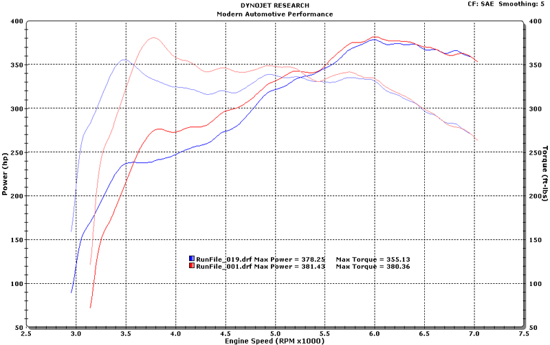

This is one of the dynos that shows gains from the V3 portwork, with ceramic coating, and the 65mm tb. Slight shift of ~300rpms or so but significantly more power.
At the peaks, it's 380tq to 332 @ 3780rpm (gain of 48wtq) and at 3840rpm hp before was 241 and after was 276 (gain of 35whp). Good stuff all around.
Funny thing is, although Chris was nice enough to donate his car for testing (thanks again man) his setup was far from an ideal case to really showcase the gains from the work. If we were able to rev into the 8k-8500 range, and or have significantly more CFM to work with (bigger turbo) I have a feeling that not only would we have seen more, we would have seen much more up top. We do already have something else lined up that will highlight some of the gains on a big turbo setup. More info when it becomes available!

Do you have boost logs from those two runs?

I agree. I really want to see this manifold on a bigger setup.
