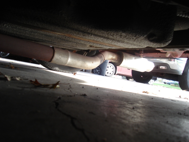

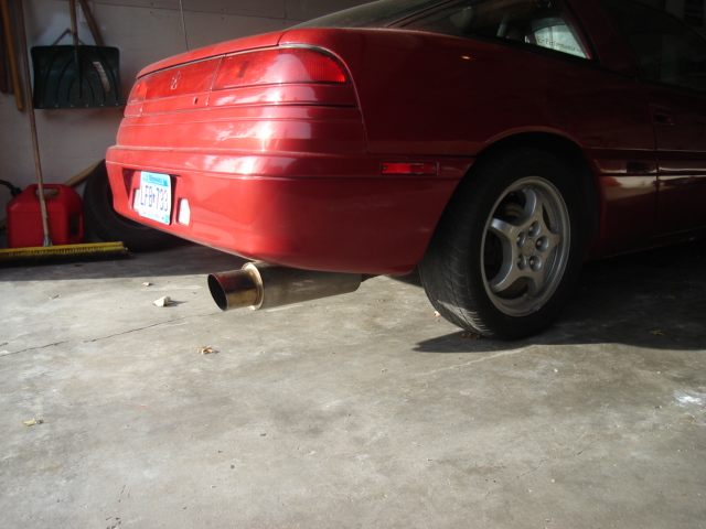

My exhaust is pretty simple. I have two 3" 45* bends one thats pretty mutch right under the axil to go up and over and one to bend it straight back to the stock exit area. I just have a cheap Ebay straight through muffler. If I did it again I'd add a resonator inline somewere.
The only thing I don't like about your's is that it goes right under the gas tank. I would at least put some sort of heat sheild there.
I was kinda worried about that at first. But its been like this for 5 years with no pronlems.
Mine use to be under the gas tank thats why I cut it off and stuck the muffler on. It scraped on everything.
What I want to do is put maybe 2 3 inch cherry bomb glass packs in the center hump and then just run stock 3 inch mandrel bent tubing out the stock location and routing. It can't be that hard to make it go over the rear axle, can it?

Originally Posted by 123abc View Post
Mi It can't be that hard to make it go over the rear axle, can it?
My car is lowered at least 2 inches so I dont think theres mutch room above the axil. I mostly wanted to make it with the least amount of bends possible. less restriction less cost and less work fabing it.
