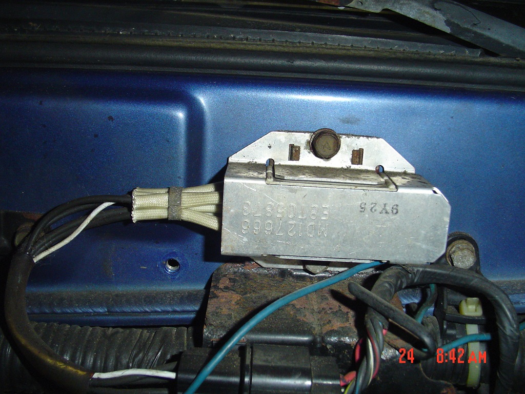

Is this the resister pack then? I've never had to screw with the blower fans on any cars till now...

NM, I guess thats the injector resistor pack.

Really common on GMs to have the resistor for the fan speed control fail so that it only works on a few or one speeds. I don't know if its seperate or with some component on the 1gs.

The resistor pack is always in the air duct near the blower fan, or a part of the blower fan assembly. It has to be or the resistor pack would burn out very quickly without the air of the blower fan cooling it off.
So look near the blower fan, under the dash on the passenger side dash.
