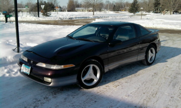

Hey guy's wondering what tire size i should put on my 91 eagle talon tsi. I just got some 17" ADR J-Drives and im wondering what size tire would look best. Let me know, thanks!

What size are the wheels? That's what matters.

ugh those wheels make me want to vommit!
+1 to dizzle, how wide are they?

Wheel width would help, but i run 235/45/17s on my 17x8

DSMers should learn how to balance both; the majority of DSM's look like hacked up beaters these days. I do agree with you though, those tri-spoke wheels are hideous and anyone buying tires based on how they look belongs in a VW.
To the OP: Tell us your wheel size and we'll gladly recommend tires from a performance perspective. I assume you're looking for an all-season tire?

Since they're 17x7 I recommend 225/45-17 tires. Sumitomo just came out with a new ultra high-performance all-season (HTR A/S P01) that looks very promising for $89 in that size.

Well actually just a summer tire I have the winter ones already. And I was wondering tire size so I could go get a good set of tires for my car. And I have 235/55/17 but those might be too big.

Ahh ok! In that case check out the Sumitomo HTR Z II and III. I had the II's on my old 1G and will be putting them on my wife's WRX; I currently have the III's on my Evo.

Thats a huge sidewall, I'm not sure 235/55 will fit. It almost sounds like a truck tire.

Well we just had them sitting around if they don't fit I have to get new tires so that's why I posted this. They are ones that come factory on some caddys.

A 235/55-17 is way too tall of a tire; you must have edited that in after I replied last time.
