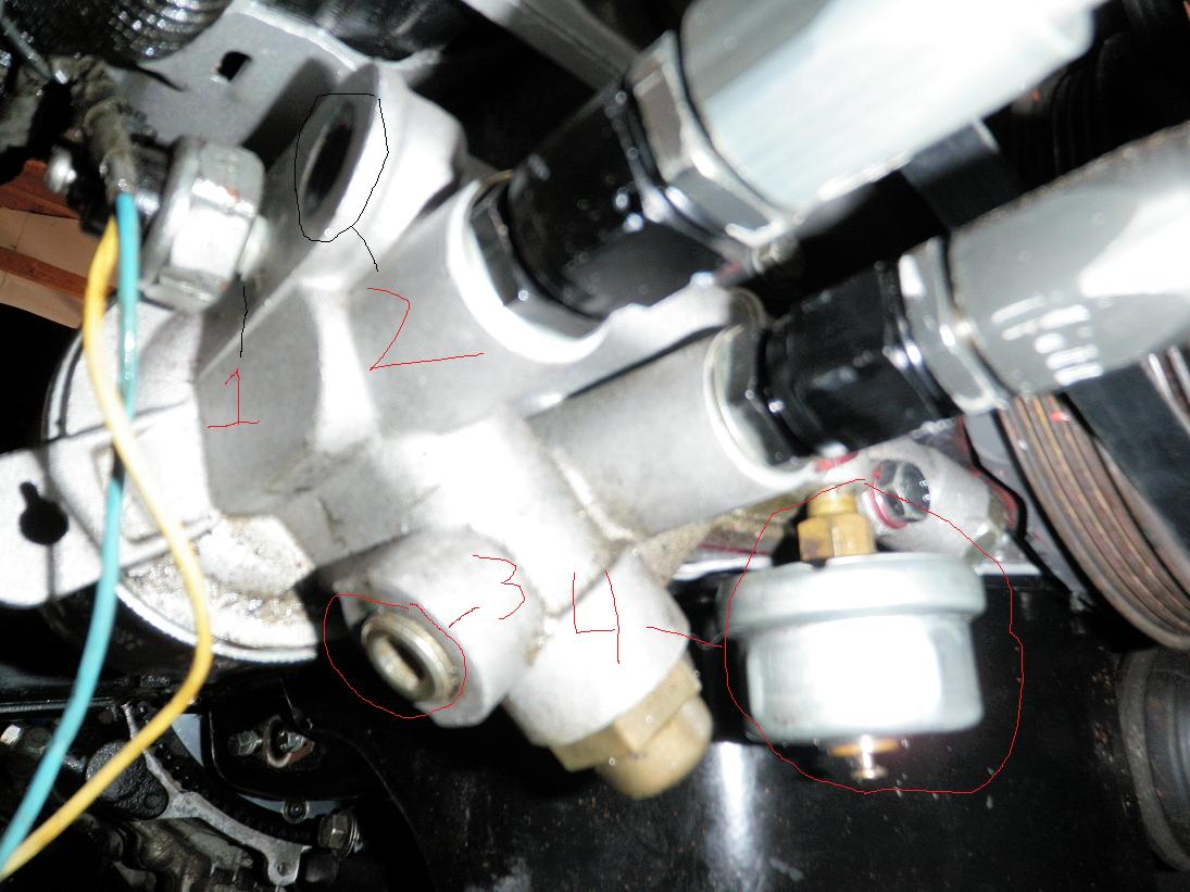

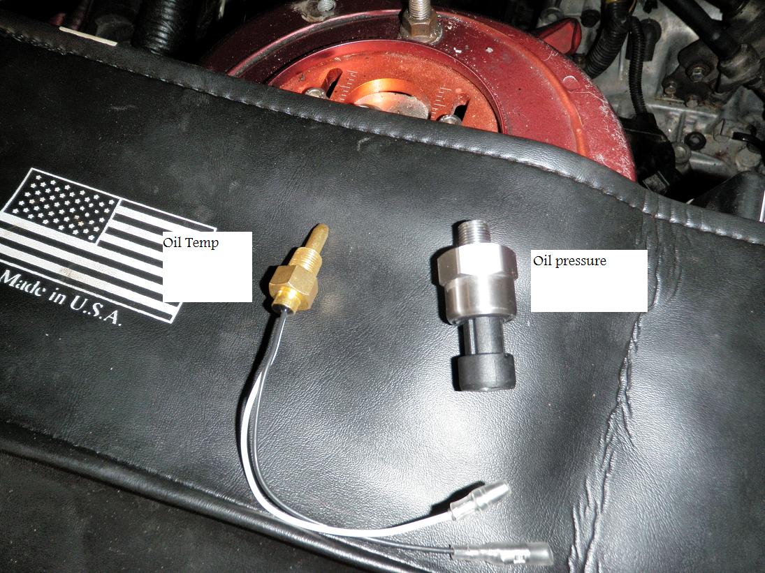

Ok so I bought a oil temp and oil pressure gauges(premium prosports) I have a 92 laser AWD with OFH off a 90 with an external oil cooler. I was wondering where to put the sensor at? I modified the pics(sorry they are a little ghetto Im not very tech savy) Any help would be great.
Thanks Ross
Both the gauges are electrical

4 is where you would put the oil pressure sending unit.

Ok so i guess your using a mechanical oil pressure gauge? Mine is an electrical so i would do the same thing but with the T right?

I would get a T BSP fitting for spot #4 and install them both there. That's the stock oil pressure gauge location.
Old 04-20-2010   #5
Re: Help with where to install oil sensors on OFH
You could also get the sandwich plate Prosport makes. Not sure it would clear the alternator and downpipe on a 1g with the 90 OFH though

Sorry to thread jack but what goes in spot 2? Mine has a plug in spot 1 and an open one in spot 2.

Bringing this back up because I need to get this done and didn't want to start a new thread. Using the picture from OP, I have an open thread in 1, a plug in spot 2, feed line to turbo from 3, and oil pressure unit on 4. What do I do with 1? Should I just plug it?
