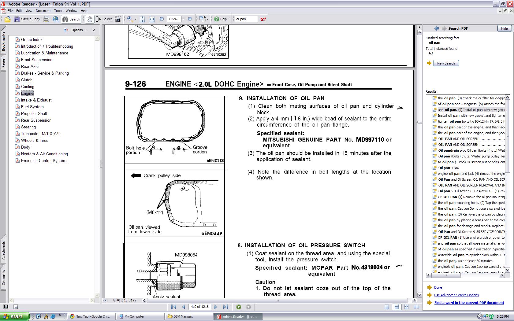

If you didn't already know, Mitsubishi uses an RTV called MitsuBond from the factory. The oil pan gaskets are an aftermarket creation. 4G63's came with RTV'ed oil pans from the factory.
Sweet, But still a little to much can cause bad things to happen. So people just need to be careful. I picked quite a few chunks of the screen so yeah. chimm looks like the pump was pretty new, sucks i have to replace it stuff happens though. Good thing we found out before anything else happened. You should of seen how tight the belt was it started shredding kind of interesting.
RTV is pretty good just if not used right can be detrimental thats all i was saying. If you have it on your pick up screen i figure a little to much was used. No worry's no point in crying over spilled milk at this point . . .
