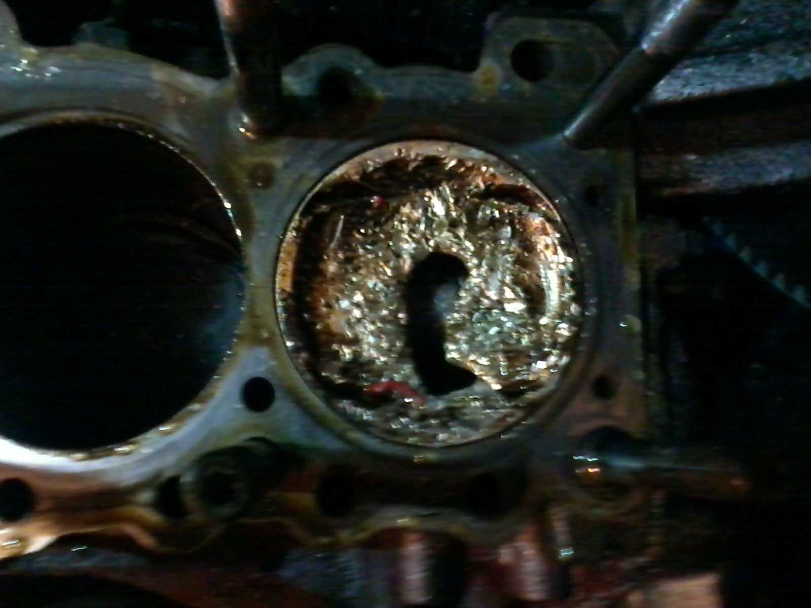

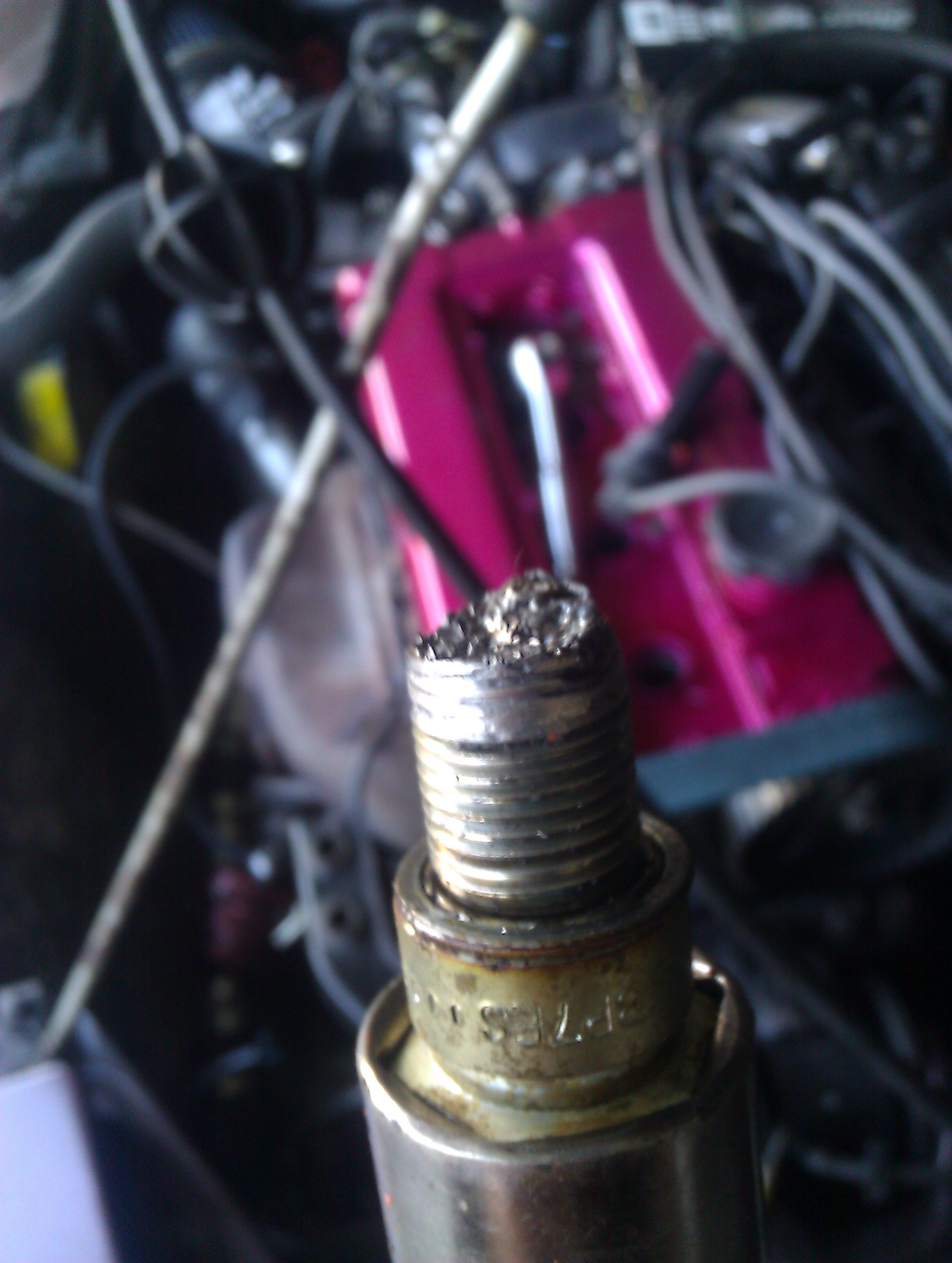

HOW IN the FK dose this happen i was driving and it just did this ... i guess it might be the gas out here ?
the head is fucked it came out this way .... cyl 1

Well you did mention the 88 octane in the other thread, were you boosting a lot on bad gas or what? It could also be a bad injector that caused it.
OR it could be a valve that broke and bounced around inside cylinder 1 and trashed the head and spark plug, I believe the same thing has happened to a few local members, maybe Brandon (Halon).
That's why. /thread

Looks like my spark plug. I still don't know what caused my problem. I was driving home from the gas station about a mile away, driving like a granny. Not getting into boost or anything. All of a sudden CLANK CLANK. Coasted into a parking lot. Removed the head and found a valve laying in there. The stock valves are a 2 piece design, and where mine was broken seemed like the spot where the 2 pieces would have fuzed together. So it seemed like just a random valve failure in my case, and that's the best I could come up with. I feel your pain, sucks man.
I fixed it the cheap route. Replaced the head with a 2G head. Replaced the Piston/Rod in that one cylinder. New rod bearings throughout. Bada bing.

I vote the valve or an injector partial failure. If it was octane it would show up on more than one cylinder unless you have severly unequal flow across your intake ports.
If it was an injector full failure (aka not spraying) nothing would happen.

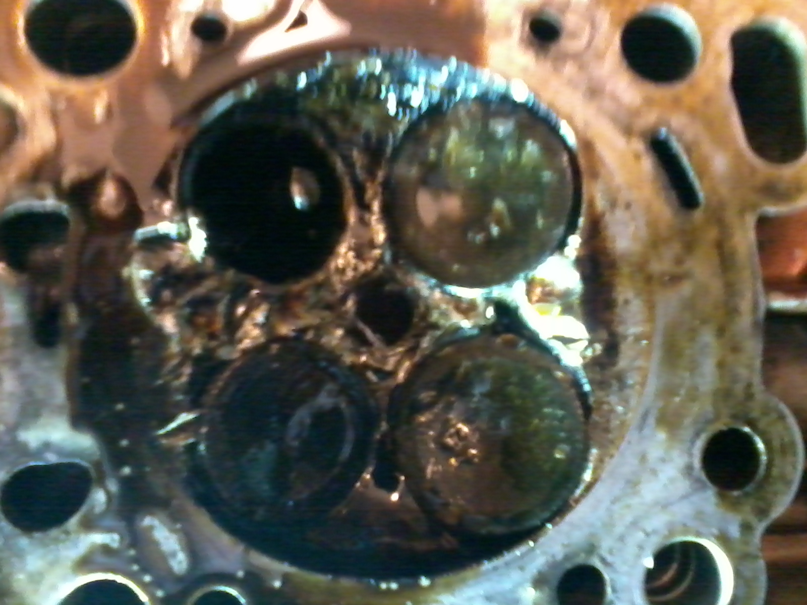

i VOTE valve keeper dropping a valve into cylinder and destroying the engine fuck im pissed never seen huge power .... i feel sick ... ahhhhhh i guess thats what i get for NOT doing anything to the head before the rebuild
i NEVER revved it past 6500 i was driving and it just let go ..

i dont know if i would be able to just put another piston in being i would have to re ring the whole engine + new rod and main berrings guessing those are going to be fucked too i dont get it ...

Sorry for your loss, not the first time I've seen a valve drop on a dsm like that randomly.

Damn! Did you happen to look at my thread? Looks EXACTLY the same! I just rebuilt the one cylinder and let er buck.

If your crank pulley broke, could that of been the problem?

He wrote in another thread that that pulley broke, so I agree it might have been part of the problem.
