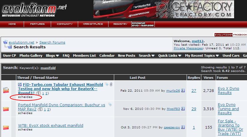

Re: MAP's Evo X Exhaust Manifold Testing / Dyno Results
FiD posted Scheides' manifold testing results all over EvoM.
Old 03-25-2011   #13
Wat?

Old 03-25-2011   #14
Murlo26
Murlo26's Avatar
Location: Lino Lakes
Drives: 17 Honda Accord
Posts: 4,041
Scheides posted some, but FID posted all the results that Scheides didn't really plan to post where they upped the boost and what not.
I am guessing that is what Kracka meant.
Old 03-25-2011   #15
Yea, we upped it a psi or two to try to match the psi that the car was running with the MAP exhaust manifold. That was after running it with no changes and it dropped a little bit of boost.
