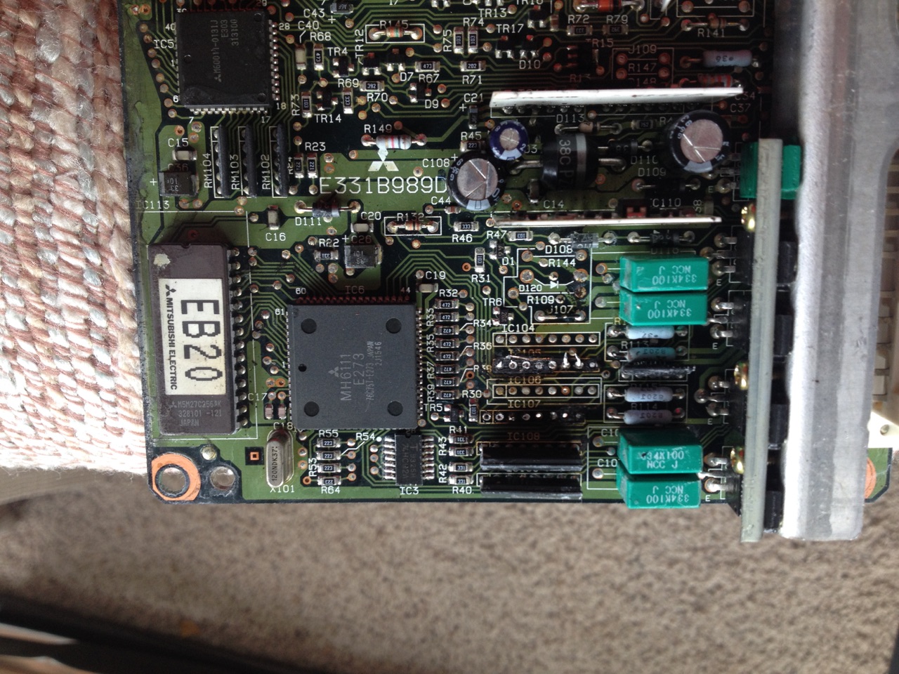

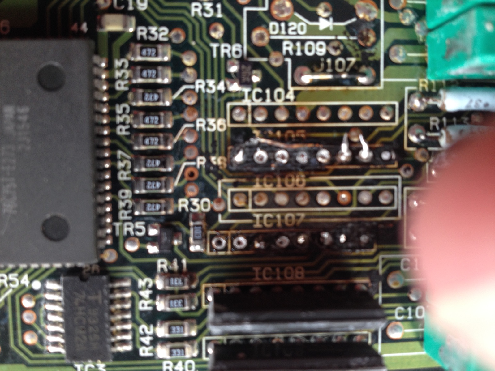

Not sure what happened but it blew. I was going to see if there was anybody on here with any experience on soldering small electrical circuitry? I can upload an image. I idk if I can pull this one off but if I do its not going to look very good.

Found out that the non eprom ecu version of this guy has the same circuitry for the ic as the one with the burnt out ic. Looks like a little bit of a job and ill have to add some little jumper wires into the mix to get passed the singed end of whats left... but.. she might run again............................................. .................................................. .................... Now if I could only find out what the ic are being used for.

I would contact ecmlink, they do ecu repair.
Yeah.. have someone who knows what they are doing fix it if you want it to run again

there was a guy i sent my ecus to in wisconsin to get eprom sockets. but they would come back with full test sheets of everything on the ecu for free!!! ill try to dig up his info, i would hands down recommend this guy
edit........ so im old and he hasnt dont it as a business for 6 years..... but you could still email him and see if he does some on the side
http://simon.chi.il.us/ECU/ECURepair.html
