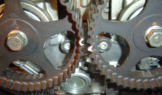

I have the car in my garage. I took the front apart and found that the timing is off like I expected. Here is a pic. Looks like the intake cam is behind. Would this cause the bad compression? The valves not sealing, thus loosing alot of compression? Do you think the valves are smashed or they are just not sealing the CC?

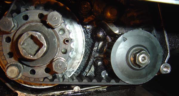

Here is a pic of the crankshaft and oil pump. To the best of my knowledge it is all ligned up on the bottom. Look right to you??? When I align the cam marks the crank and oil pump are each a tooth off (past their marks). Should I have the timing belt put on right or pull the head? Do you think the valves are gone? I guess I could throw in some ARP's and get rid of more crap if I pull the head. What do you think? Will it run if I just swap the belt on their right? Pic of aligned front case with pic above:
Thanks for the help, John.

Old 08-09-2004   #8
PSI2HI
Location: Fargo, ND
Posts: 181
Take the belt off and put it on the right way before you pull the head. If u pull the head and the valves are good your screwed for an easy fix and finding the problem. No way of knowing if its head problem or not w/o sending them to the machine shop.
