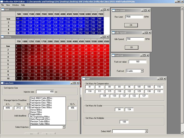

1G ECU programming options
Some Screen shots-
Heres Evilscribe.Changing MAFs or injectors is as easy as selecting them off a list.

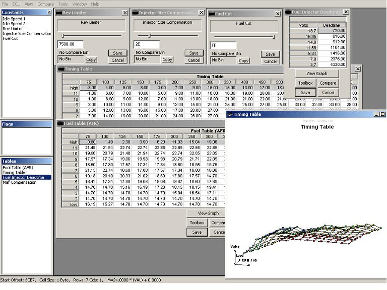

Re: Any body using tmo chips?
Heres TunerPro. You can edit maps in graphical fashion
